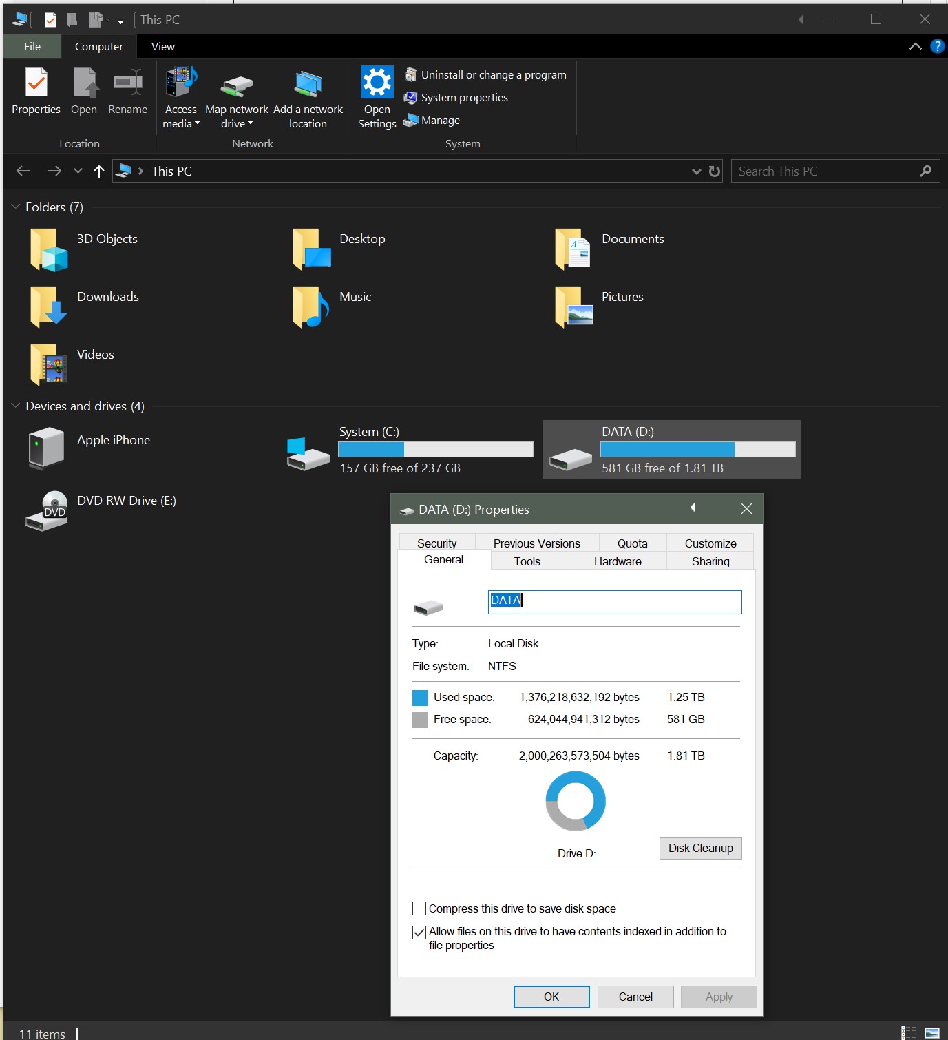

To find out which File system the drive uses, start File Explorer for "This PC", right click the drive, and select Properties

If the drive is formatted for NTFS then that's what you want. If its something else then the question is why? Do you plan on attaching the drive to an Apple or Linux system?
