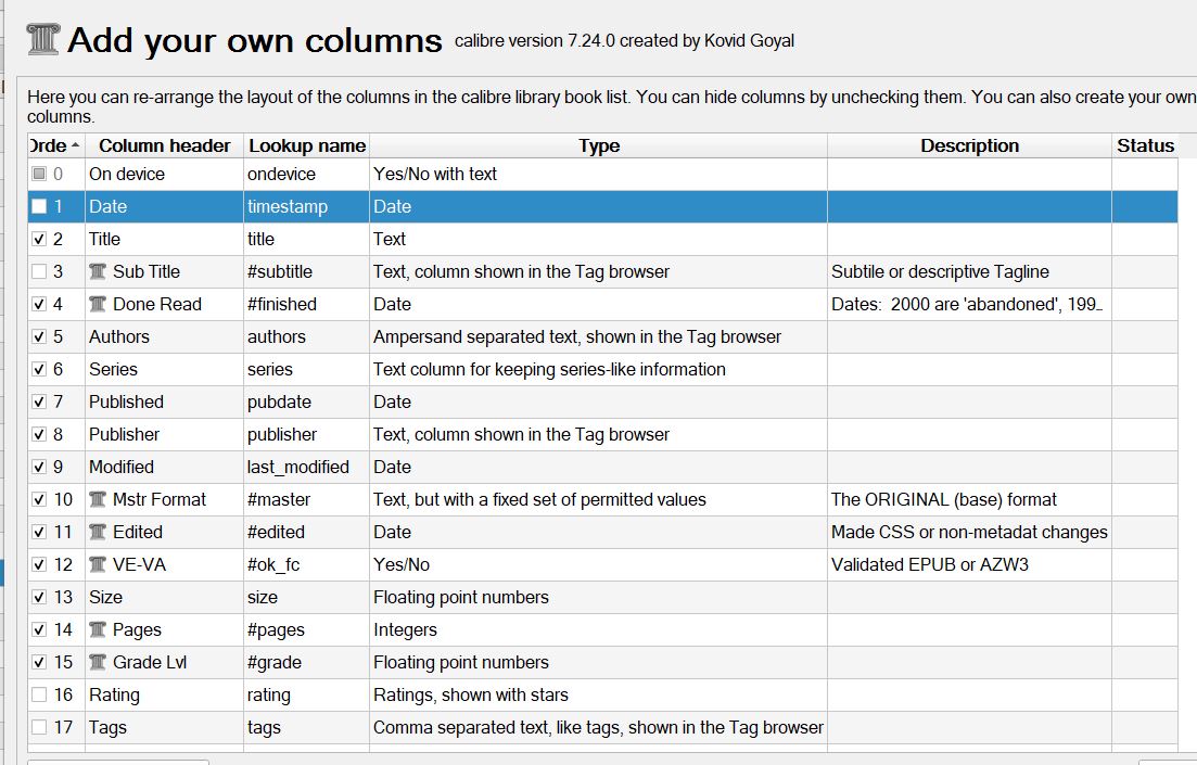

examples where I 'assume'
#Validate check (yes/No)
Tick (yes) Passed
Red Plus (no) Failed
no mark Not checked << assumed meaning
#date edited (any time I correct something in the book
No date. no edits made << assumed You do not need to log every type of activity to know something.
a date: Last changed made on
(Note: If I was OCD enough to know about the History of changes, I would add a Change page TO THE BOOK to track that. Not happening )
My wishlist is simply an Entry that has no formats (AKA 'Empty Book')
a search formats: false shows me my wishlist items. I do not need to TAG those as Wishlist to find them. it is assumed those will be wishlisted
Preferences: Add your own Columns allows you to Describe your use of Custom Columns (It won't let you leave a note how you use standard ones ) <hint >
Name:	Column Notes.JPG
