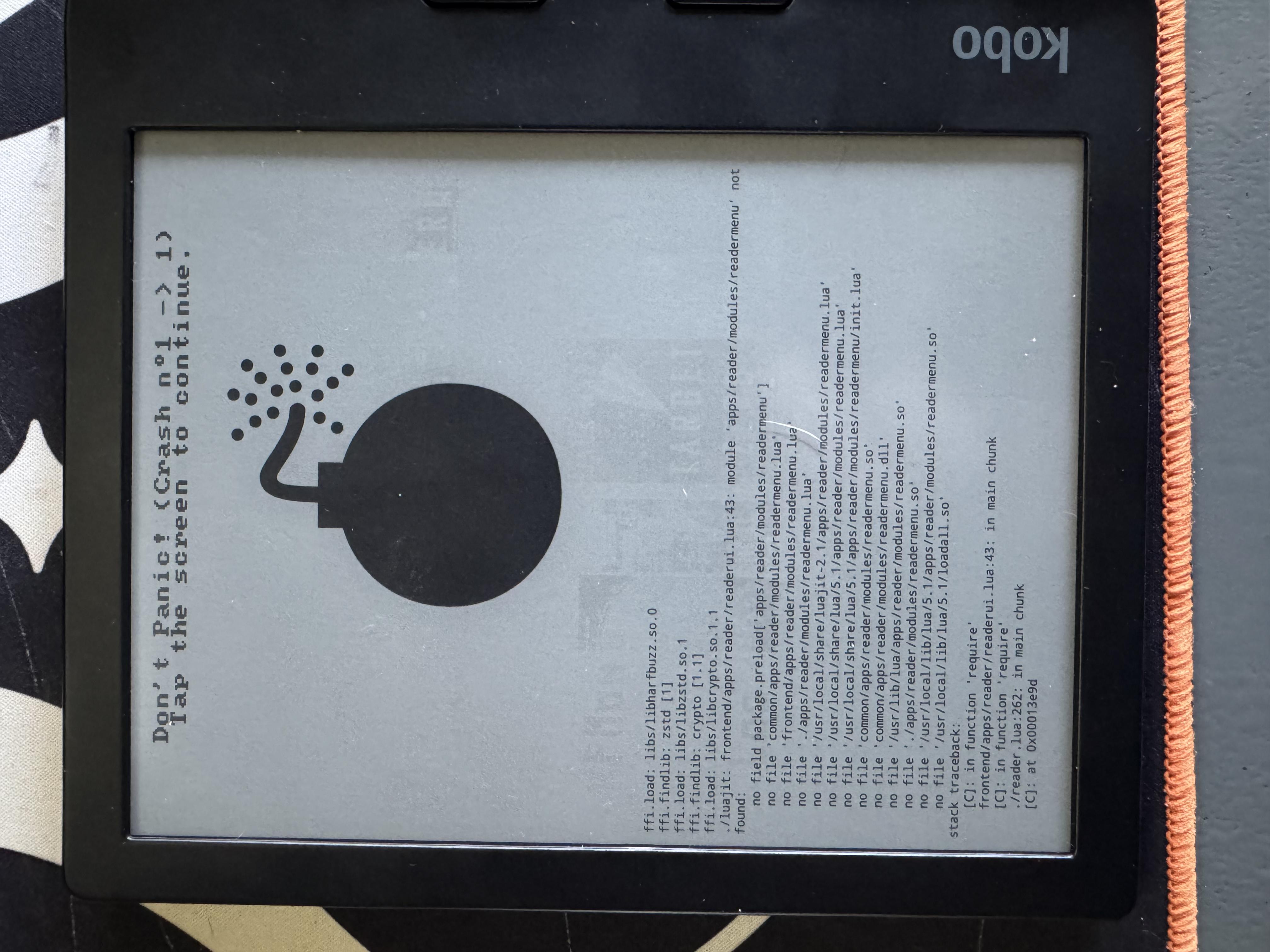

Good afternoon. I had everything working on my Kobo Libra 2 with KOReader, but then I went and messed it up. I noticed that when I connected my device to Calibre, it wasn't showing the books as "on device." So, I went back to nickel and connected the device to get them to show up. Once I did that, it told me I needed to update my firmware. I let it do that automatically, and then got the normal error when I tried to launch KOReader. Searched here and saw that I would need to update KFMon, so I started to do that process. I ended up trying to re-install the OCP for both KFMon as well as KOReader, but I'm getting this crash (photo is attached) every single time now and I have no idea what I did wrong. Any ideas? I'm happy to wipe the device and start over, but I had everything set exactly as I want it with fonts and dictionaries, etc., and I'd hate to lose all of that. So is there some way, even with this crash happening when I try to launch it, to back those things up so that when I re-install everything I can have it back like I left it?
In case it helps, I just found the log file and this looks to be the relevant portion, though I can certainly post the entire thing:
"stack traceback:
[C]: in function 'require'
frontend/apps/reader/readerui.lua:43: in main chunk
./reader.lua:262: in main chunk
[C]: at 0x00013e9d
Uh oh, something went awry... (Crash n°5: 01/19/25 @ 14:17:01)

And here is the entire crash I'm getting now:

./luajit: frontend/apps/reader/readerui.lua:43: module 'apps/reader/modules/readermenu' not found:
no field package.preload['apps/reader/modules/readermenu']
no file 'common/apps/reader/modules/readermenu.lua'
no file 'frontend/apps/reader/modules/readermenu.lua'
no file './apps/reader/modules/readermenu.lua'
no file '/usr/local/share/luajit-2.1/apps/reader/modules/readermenu.lua'
no file '/usr/local/share/lua/5.1/apps/reader/modules/readermenu.lua'
no file '/usr/local/share/lua/5.1/apps/reader/modules/readermenu/init.lua'
no file 'common/apps/reader/modules/readermenu.so'
no file 'common/apps/reader/modules/readermenu.dll'
no file '/usr/lib/lua/apps/reader/modules/readermenu.so'
no file './apps/reader/modules/readermenu.so'
no file '/usr/local/lib/lua/5.1/apps/reader/modules/readermenu.so'
no file '/usr/local/lib/lua/5.1/loadall.so'
stack traceback:
[C]: at 0x00013e9d
Uh oh, something went awry... (Crash n°5: 01/19/25 @ 19:22:47)
That means files are missing. Try overwriting .adds/koreader to ensure all the files are there.
