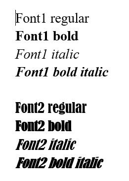

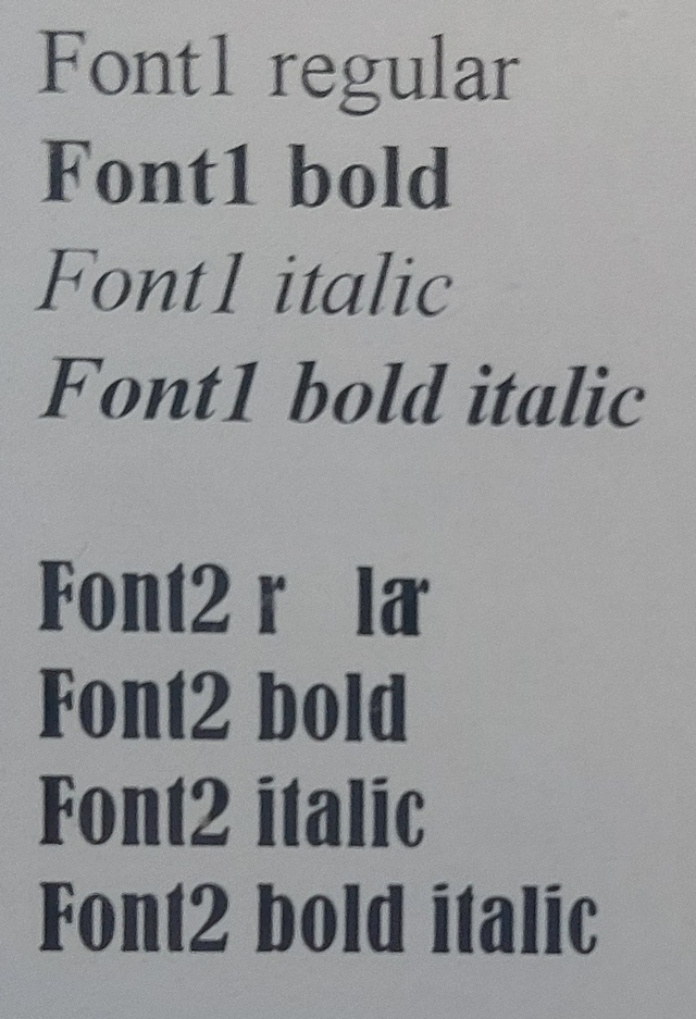

The problem is that sometimes you may unknowingly use the font in WinWord which has only REGULAR version, but Word lets you use it with faux bold/faux italic. If you do this and convert to reader format with "Subset all embedded fonts", the same regular font file is embedded and subsetted multiple times, but then, Kindle (at least my Voyage) does use only ONE of the font files for all text using it. Then some glyps as missing depending on which of the subsetted font files the Kindle uses.
See attached files:
test - test.docx is testing docx file. 4 lines with Font1 are in Times New Roman, 4 following lines are with other font, visibly different to each other.
See winword.jpg for how it looks like on my system.

test1.jpg is how subsetted conversion to azw3 looks on my kindle. Uses regular font, but only some glyphs.
test2.jpg is non-subsetted conversion, I assumed it'd be enough for workaround but it doesn't look like it. I though calibre would use font from system, but it probably choses one of the subsetted font files saved in docx file.
So full workaround in this case is no subsetting in word, no subsetting in conversion and accepting huge files (for example Times New Roman is huge). And still, the conversion would not look the same as in winword, because faux-bold/italic is not converted.

That's a bug on the Kindle, if its using the wrong font file, report it to amazon. calibre does not support conversion of fake bold/italic and is never going to. There is no shortage of fonts with bold and italic faces these days that one needs to use fake bold/italic.

Yes, you're right that it's mostly Kindle bug. But because it's not visible anywhere in DOCX->calibre->epub->kindle chain, it's kind of hidden from the user until the very moment of 'where are my glyphs?' when reading on actual device.
Hence my suggestion about the possible conversion warning. I still think that conversion quirks/known problems/known misses (for example non-conversion of MathML, non-support of small caps, non-support of fake-bold) should be clearly reported to the user. At least it's convenient for the user and prevents future questions/bugreports.
