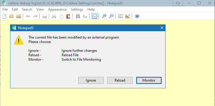

Current behaviour to which I'm trying to get used: initially the notepad3 calibre-debug-log.txt file opens empty and i get the following prompt after the first restart:
Name:	MWSnap 2025-05-10, 10_02_25.png
What I do is click "Monitor" and this works fine because there's only one item in taskbar during all restarts. But in a previous 8.x version, can't pinpoint which, something wasn't working correctly; I believe this has been fixed by https://github.com/kovidgoyal/calibr...727d47ffd7d1fa.
I'd need to click Monitor all the time across restarts - not just once upon initial restart. Today on quick tests I notice it's needed to click Monitor only once and that's great news, but I sometimes would like to see the overwritten logs like before - one for each restart.
