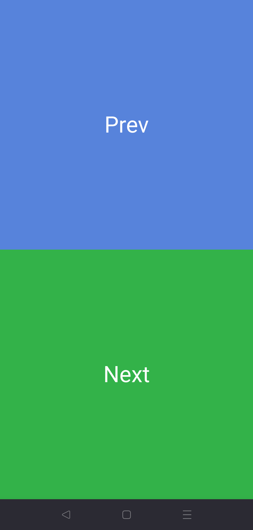

Hi all. I've been working on a wireless remote control for Kobos and just released the first version. In my experience it greatly improves comfort for long reading sessions when paired with a device mount such as this. Downloads are available on GitHub along with more information and installation instructions. I've also attached some screenshots to this post.
Compared to existing solutions it should be easier to set up and have broader device compatibility. I've only tested it on a Glo and Sage, but it should hopefully work with every model since the original Touch. If anyone is interested in testing it I'd be grateful for confirmation that it works. If there are any problems feel free to post here or open an issue on GitHub. The developer forum here has been a great resource so thanks for all the information.

I love this! Just tried it on my kobo mini (running the latest Glo firmware) and it's working pretty well for page turns. The Remote control page just gives me a single green square.
Name:	Screenshot 2023-08-01 000758.png
Glad you like it! That's weird. The remote control page will look like that before you've recorded any actions, but if you've gone through the initial setup and the page turner is working then 'Next' and 'Prev' buttons should appear there (plus any custom actions). I haven't added debug logging yet so it might be hard to figure out what's going wrong until I do. What web browser and operating system are you using? Two things I can think of now:
  1. If you visited the remote page before doing the setup your browser could be caching it and forcing a refresh might help.
  2. Try using a different browser and see if that makes a difference (Firefox on a computer if possible since that's what I've mostly tested it with).
Yeah, I thought the same as your first point but it did it again on the second browser. Both browsers I tested were Chrome (mobile and desktop).
Is there a way to set the next/back up again? On my glo I ended up recording 2 swipes instead of just one
You can just re-record the next/back on the initial setup page and it will overwrite any existing recording. I should have a new version with debug logging released in the next few days.
If you're able to follow the instructions to generate a log file I'll hopefully be able to figure out the problem. It's possible another change I made will have helped but I think it's unlikely. It might show an error message instead of the green square now too.
