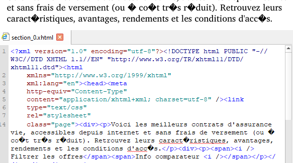

Hello,
I'm using a browser extension to convert HTML pages into EPUB files.
It works fine when the web page is in utf-8 but it doesn't like web pages encoded in iso-8859-1, where accented characters are replaced with question marks — the attached screenshots are when opening the EPUB file in SumatraPDF and Sigil.
To make matters worse, the extension replaces the encoding meta line with "charset="iso-8859-1".
I'd like to understand why accented characters are replaced with question marks. Is it a font issue? Or a problem with byte values?
Thank you.
Edit: I should have typed "the extension replaces the encoding meta line with "charset="utf-8"

If the html extension writes the epub file and adds the meta charset="iso-8859-1" that means the text is encoded that way. It must be read in as iso-8859-1 and recoded to utf-8 properly. Sigil can actually detect that and properly encode it as utf-8 but not if you change that charset meta info or improperly add the xml header saying it is utf-8 when it is not.
A better technique is to use a python script to read each html file in as iso-8859-1 (sometimes called latin-1) and recode it and write it out as utf-8.

But why does it display accented characters with ?'s in the original EPUB output file?
Editing the EPUB file in Sigil to replace "utf-8" with "iso-8859-1" doesn't solve the problem: Now, the questions marks all turn into "�" :-/

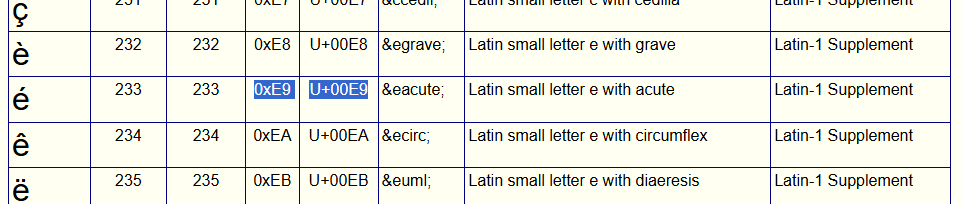

I see that "é" in ANSI is 0xE9 and it's 0x00E9 in Unicode. So why can't the application display the original character, with just an empty character before it (as 0x00)? Does the extension convert 0xE9 to another character that's available in Unicode but not ANSI?

Because it tries to interpret your document as UTF-8, finds invalid multibyte sequences, and translates it into the replacement character, which you see as � when you interpret the document as Latin-1.
You should consider other tools to convert HTML into EPUB.

1. Any byte 128-255 is turned into two bytes, with a leading 00, so that, for instance, "é" is turned from 233 (0xE9) to "00233" (0x00E9)
2. The reason for the question marks is that the application looks for that two-byte codepoint in the font instead of the original single-byte codepoint

Looking at the EPUB in hexmode, I see that each accented character is replaced with "EF BF BD".
Here's the explanation: "The sequence "ef bf bd" is UTF-8 for U+FFFD (REPLACEMENT CHARACTER), i.e., a special code that is shown as "�", as mentioned in your question. Therefor, something (Python?) must have replaced the original char with this code. So your terminal appears to be okay.
The 'é' character U+00E9 (LATIN SMALL LETTER E WITH ACUTE) in UTF-8 would read "c3 a9" instead.
It is conceivable that your original subtitle might be encoded as CP1252, where the 'e' is represented by code 0xe9. Since the next byte is 0x72 ('r'), your parser might have interpreted the 0xe9 as an incomplete UTF-8 sequence and therefor replaced the "e9" with "ef bf bd" (REPLACEMENT CHARACTER)." (source)
So once a string/file has been corrupted by replacing each problematic character into "EF BF BD"… there's no going back to the original data other than fixing errors manually (if you know the original language).
