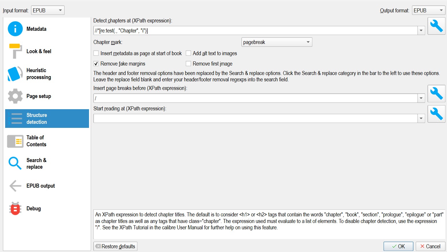

When I convert a book, I can go to Structure detection (see image) and insert the following expression in the "Detect chapters at (XPath expression" and insert this expression
//*[re:test(., "Chapter", "i")]
then go to Chapter mark: and choose pagebreak and the conversion will split the HTML at every instant of the word chapter. Making the creation of a TOC easy.

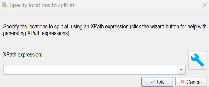

My question is when I'm in the book editor and I choose to split at multiple locations (see image). Which expression can I insert here to have the same result? Currently, after merging the files, if I see the need I will save the book and back out then convert the book to accomplish my desired results. I would much prefer to be able to insert an expression here and do the same thing.
Edit: when I cut and paste the expression above into the edit book split area I get an error. Here are the 2 most common errors.
ERROR: Unhandled exception: <b>AbortError</b>:Cannot split on the &lt;body&gt; tag
ERROR: Unhandled exception: <b>AbortError</b>:The expression //*[re:test(., "Chapter", "i")] did not match any nodes
Name:	configure device.jpg
ID:	212367   Click image for larger version
Name:	Specify locations to split at.jpg
Same one I use in Convert (cut and paste) just worked for me. But it didn't persist, maybe it will if you create the expression with the Wizard.

They are both xpath expressions you should be able to use the same in both places.
That would make sense, but I have never had it run successfully in the edit books split location, yet it always works during the conversion process.
here is an example error.
calibre, version 7.22.0
calibre 7.22 embedded-python: True
Windows-10-10.0.26100-SP0 Windows ('64bit', 'WindowsPE')
('Windows', '10', '10.0.26100')
Python 3.11.5
Windows: ('10', '10.0.26100', 'SP0', 'Multiprocessor Free')
Interface language: None
EXE path: C:\Program Files\Calibre2\calibre-parallel.exe
Successfully initialized third party plugins: DeACSM (0, 0, 16) && Gather KFX-ZIP (from KFX Input) (2, 18, 0) && DeDRM (10, 0, 9) && Package KFX (from KFX Input) (2, 18, 0) && Audit Log (1, 0, 19) && Barnes & Noble (1, 5, 6) && Count Pages (1, 13, 6) && Diaps Editing Toolbag (0, 5, 0) && EpubCheck (0, 2, 5) && EpubMerge (3, 2, 0) && EpubSplit (3, 9, 0) && Extract ISBN (1, 6, 5) && FanFicFare (4, 40, 0) && Fantastic Fiction (1, 7, 1) && Fantastic Fiction Adults (1, 3, 1) && Favourites Menu (1, 3, 1) && Find Duplicates (1, 10, 9) && Generate Cover (2, 3, 4) && GetFileName (0, 2, 0) && Goodreads (1, 8, 2) && Goodreads Sync (1, 16, 11) && Job Spy (1, 0, 239) && KFX metadata reader (from KFX Input) (2, 18, 0) && From KFX (2, 18, 0) && KFX Input (2, 18, 0) && Set KFX metadata (from KFX Output) (2, 13, 0) && KFX Output (2, 13, 0) && Kindle Collections (1, 7, 29) && Kindle hi-res covers (0, 5, 1) && KindleUnpack - The Plugin (0, 83, 1) && Kobo Books (1, 9, 2) && Manage Series (1, 5, 2) && Modify ePub (1, 8, 5) && Open With (1, 8, 3) && Overdrive Link (2, 57, 0) && Quality Check (1, 13, 16) && Quick Preferences (1, 7, 1) && Reading List (1, 15, 4) && Resize Cover (1, 2, 1) && Save Virtual Libraries To Column GUI (2, 3, 0) && ScrambleEbook (0, 6, 0) && Search The Internet (1, 11, 3) && SmartEject (2, 5, 0) && View Manager (1, 10, 3) && Virtual Library Switcher (1, 0, 1) && Walk Search History (1, 5, 4)
File "calibre\gui2\tweak_book\boss.py", line 1455, in multisplit
File "calibre\ebooks\oeb\polish\split.py", line 282, in multisplit
calibre.ebooks.oeb.polish.split.AbortError: Cannot split on the <body> tag

Split multiple MUST split between block levels or you have invalid fragmented HTML
That what it seems, but doesn't have that requirement during a conversion. However, Kovid indicates above that the expression should work in both places.

Ah that's because splitting is a different algorithm. In the conversion what happens is the immediate tag is marked and the splitting happens on marked tags later on. Splitting directly is more complex. Instead use the transform html tool to makr the tags with a class or other attribute and then you use splitting wizard in the next step.
Thanks for the insight.
I had decided simply saving the epub after I merge the files I desire to split, then switching to conversion is easier for me, than marking as you suggested. I'll give it a second look, maybe, once learned, marking will be best.
