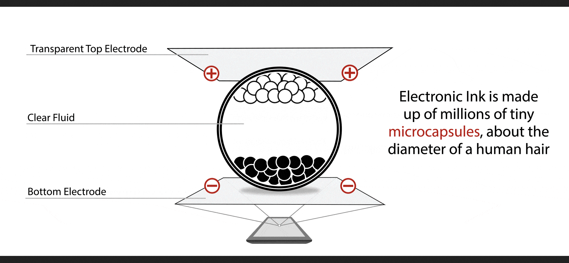

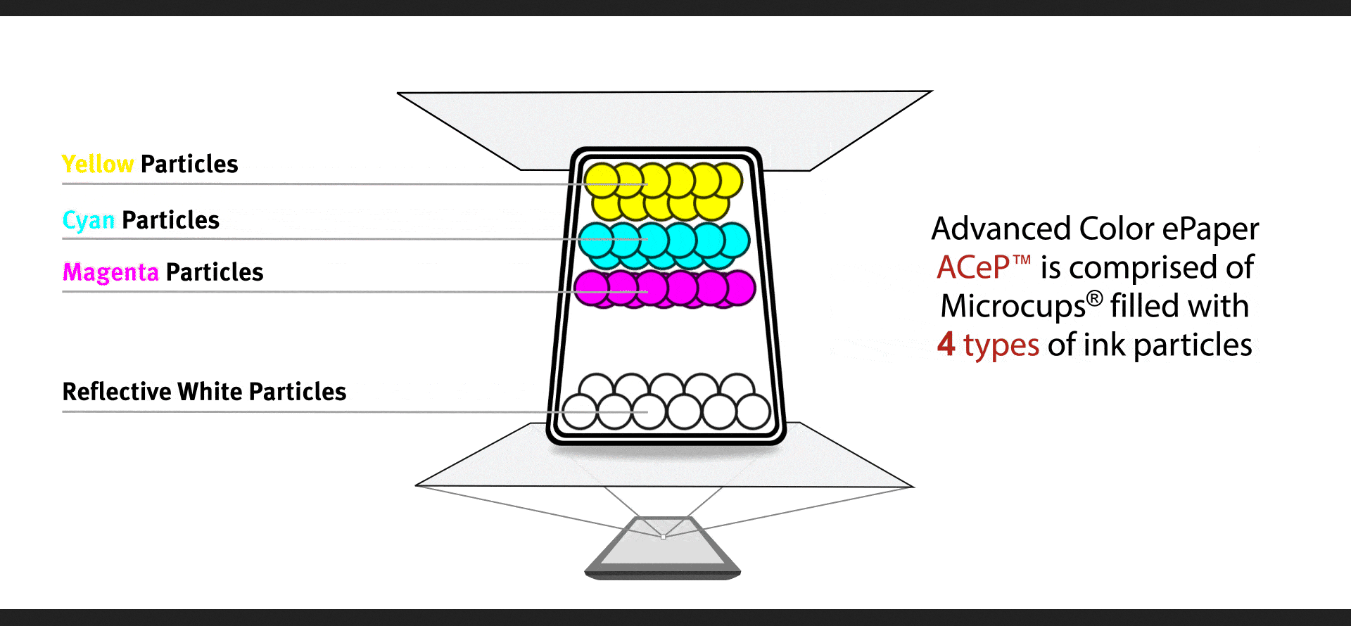

Old 09-03-2024, 11:07 PM   #13
Posts: 48,304
Karma: 174315444
Originally Posted by apastuszak View Post
So, does eInk also have a reflective layer on the back that reflects light back, or are you simply illuminating the surface only, like you would a piece of paper and an overhead lamp.
The B&W capsules themselves are opaque since both pigmented particles are in the same capsule and the bottom electrode is also opaque. The Gallery colour cups add cyan, magenta, yellow particles and lose the black particles but are equally opaque. Oddly, you can get a eInk film for tinting windows where there are only black particles which move to the side to allow light through.
So you are seeing light reflecting off the particles pretty much like light reflecting off paper.
