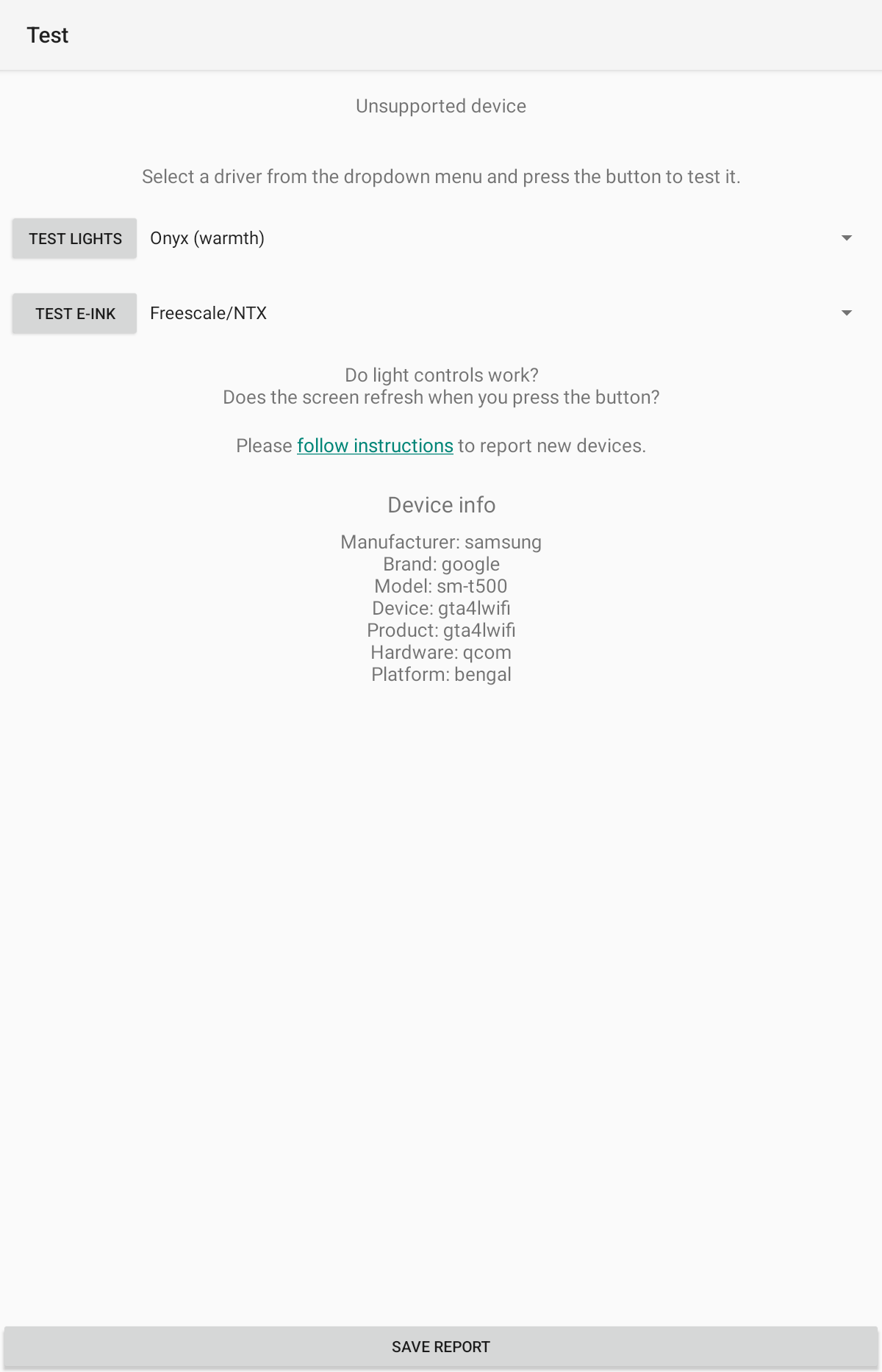

Manufacturer: rakuten kobo inc.
Brand: rakutenkobo
Model: tolino vision 6
Device: e70p14_android
Product: e70p14_android
Hardware: sun8iw15p1
Platform: virgo
run test for tolino: ok
run test for qualcomm: fail
run test for rk30xx: fail
run test for rk33xx: fail

The test activity should be pretty explainatory nowadays.
If the device is already supported it will print the driver for epd and lights.
A device has support for eink updates if the epd driver is different to "none"
A device has support for custom lights if the lights driver is different to "generic"
If the device is unsupported it will print "Unsupported device"
We're mostly interested in reports from unsupported devices if one or more of the available drivers work on that model.
