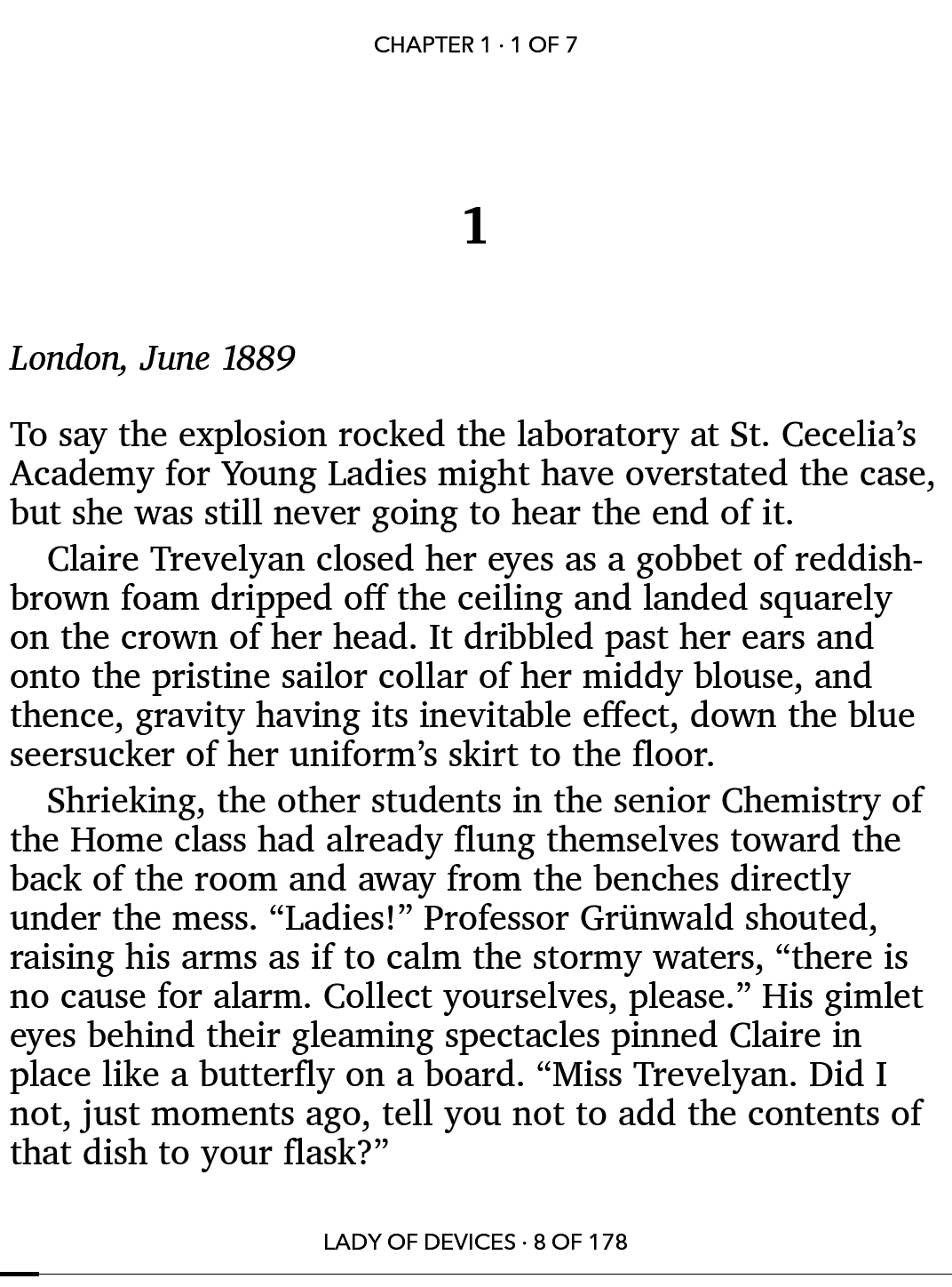

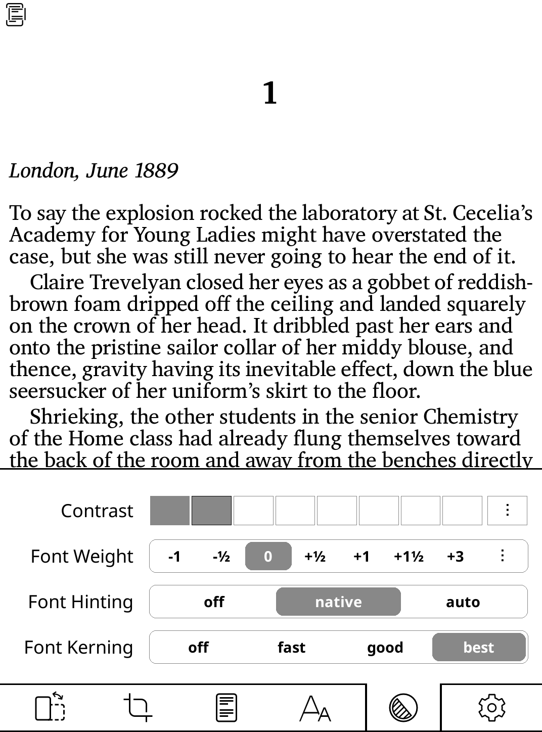

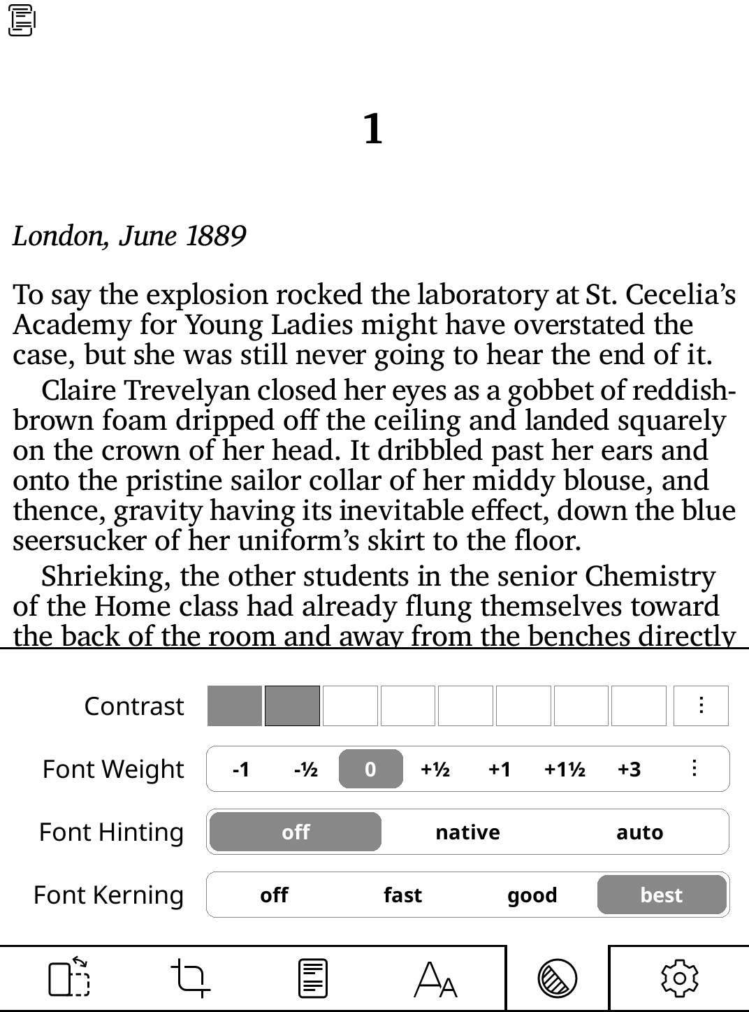

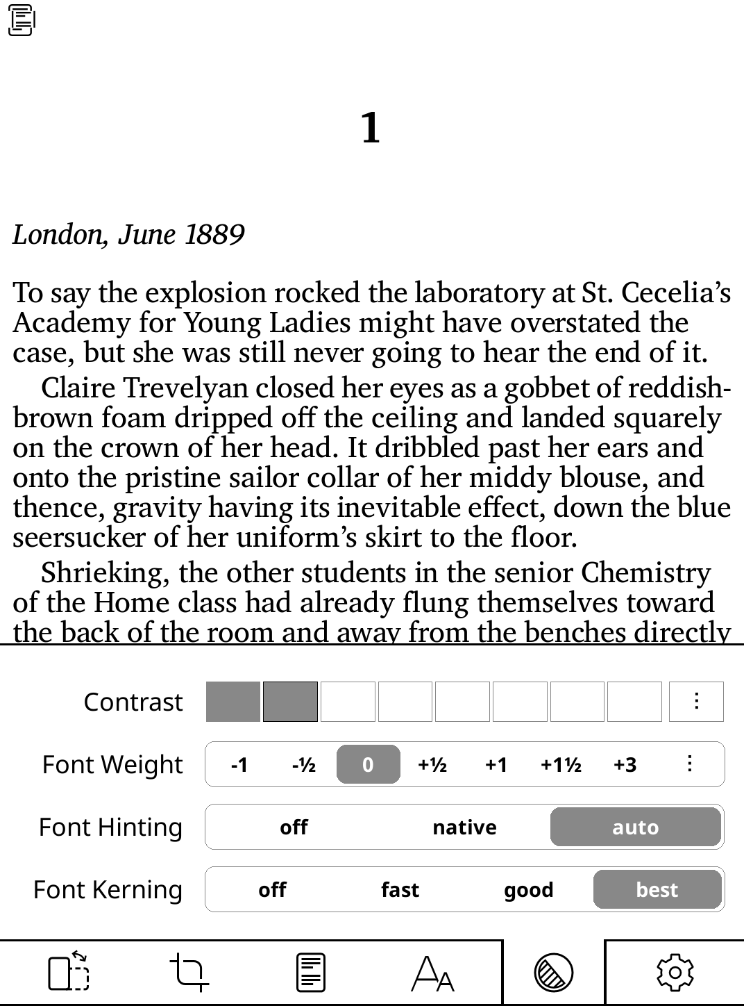

The first 3 are from KOReader, the last is from Nickel, all running on a Clara HD. The font is ChareInk.
ID:	207540   Click image for larger version
ID:	207541   Click image for larger version
ID:	207542   Click image for larger version
