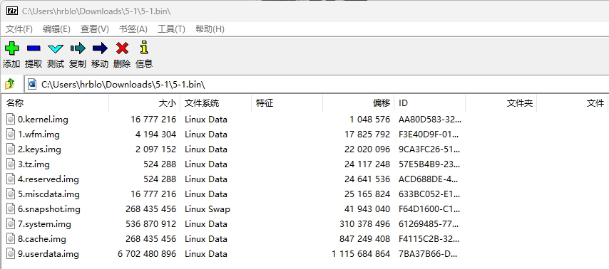

Here is the partition structure of the KPW5 8GB EMMC, if you need the real image file (which is a .bin file), I will upload it to my google drive after I get the share permission from my friend.
emmc memories have other areas such as two areas of the bootloader and rpmb, i.e. the encrypted part. Older kindle models kept all sensitive data (serial numbers, etc.) in this encrypted area. This area, as far as I know, cannot be copied to another memory using a programmer.

what about the emmc mirroring? disregard the encryption, just full mirror. Because my friend is a 3rd party Kindle repair man, he fixed tonnes of KPW5 which stuck at the Tree screen (stuck at booting)
