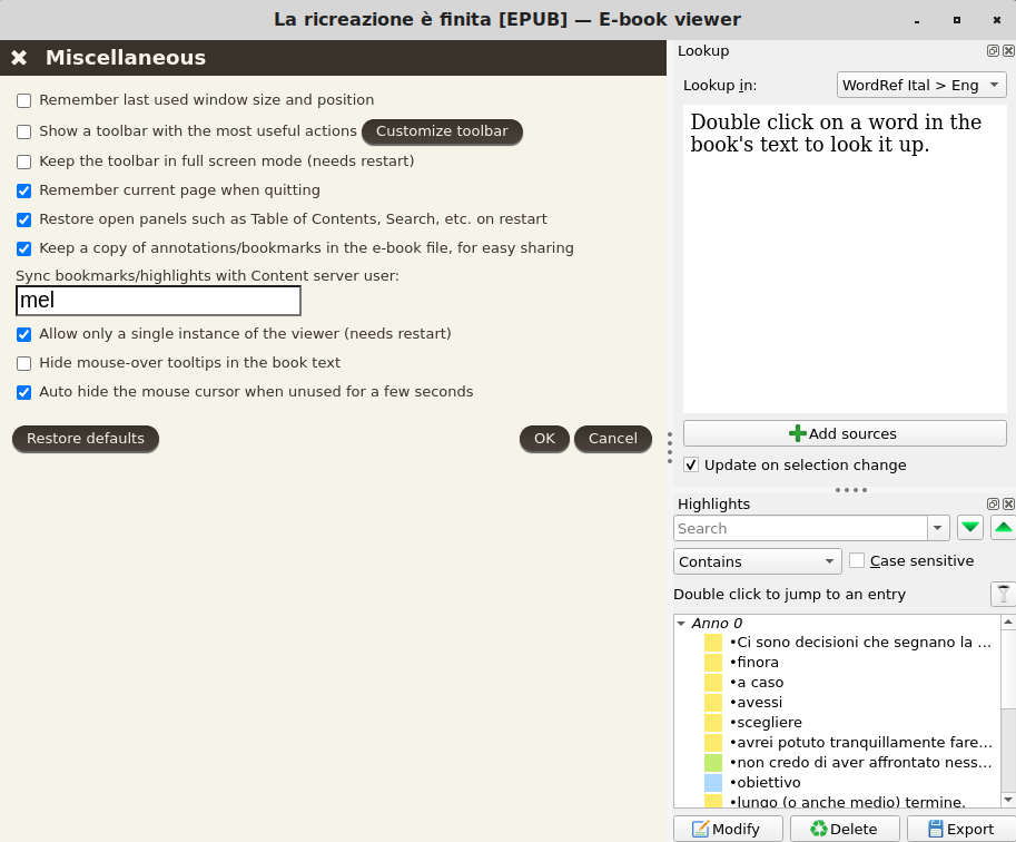

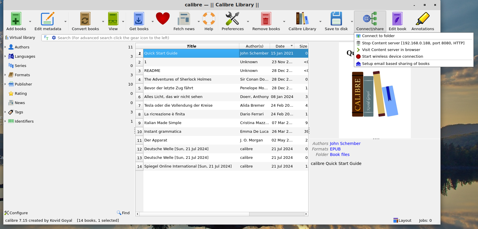

Calibre syncing highlights with notes between devices -- #2?
Although I have the server running and I have a user account "mel" and plenty of highlights in the text, the server still does not show the highlights. Please advise.

Make a new highlight, then open the book on the content server, access the viewer controls there, and click the sync button.

Yes, that works. Problem solved. Thanks very much.
