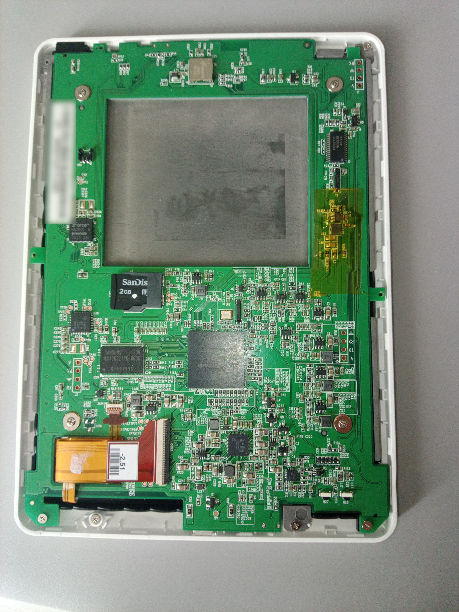

Hello,
I have a Glo N613, and while removing the microSD I noticed that an inductor had its upper part loose - I "fixed" it with Kapton tape but guess it's not a long term solution - does anyone have a circuit diagram of the N613 or knows the specs of the inductor marked as L22 on the board? It's to the right of the battery

Originally Posted by Szybet View Post
pictures?
Sorry for the delay, thanks
The inductor seems to have no marking apart from the letter "E". To be honest, I do not even know if it is an inductor, I think so as it is marked as "L" on the PCB, while other components are marked as R for resistors and C for capacitors

In the end, I asked a friend of mine who borrowed me a cheap LCR meter. The inductor gave a reading of 1.4 µH, while all the others were around 2.4/2.7 µH, so this was probably damaged, and we replaced it with a 2R2 (2.2 µH nominal)
