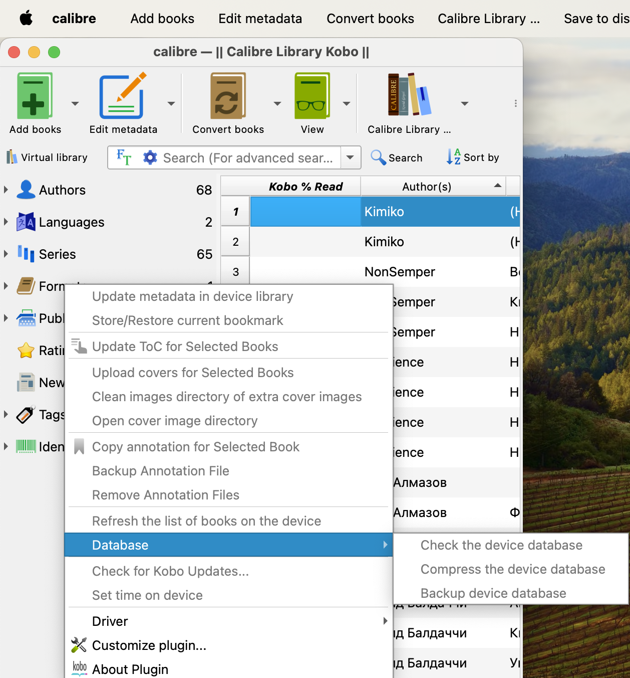

Old 07-02-2024, 01:19 AM   #3
baursak
baursak began at the beginning.
Posts: 104
Join Date: Mar 2024
Location: Saint Petersburg, Russia
Device: Kindle Paperwhite (2021) Signature Edition
...I suggest you connect to your library and use Kobo Utilities to check if the database is OK...
which item of Kobo Utilities plugin menu should I use for this (the plugin menu screenshots are attached below)?
P.S. I press 'Check for updates' on my Kobo Sage. - But it is still v4.38.21908 (dtd 22.08.23). - At the same time I see newer firmware v4.38.23038 (dtd June 2024) for Kobo Sage on https://pgaskin.net/KoboStuff/kobofirmware.html. - Should I update Kobo firmware manually or better wait until it will update itself via WiFi?
P.P.S. How can I restore reading positions after Kobo factory reset via Kobo Utilities plugin in Calibre. - I don't see an appropriate item in the plugin menu but someone told about such possibility.

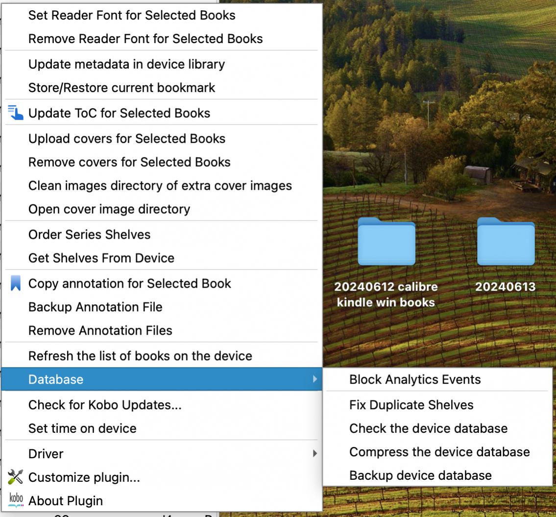

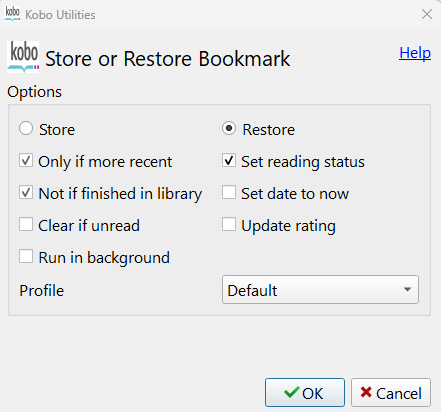

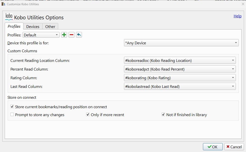

Old 07-02-2024, 02:39 AM   #4
Posts: 48,612
Karma: 174510110
The database is checked using the Check device database when a Kobo Touch ereader is connected.
To store and restore the reading position information, you will need to configure KoboUtilties. See the attached image for the configuration I use. Once that information has been stored by connecting your Kobo ereader, it can be restored after a reset by using the Restore option in the Store or Restore Bookmarks See attached image.
And yes, I would recommend manually updating your Kobo. Please note that firmware update can no longer be done through calibre since Kobo has made changes in their web setup.

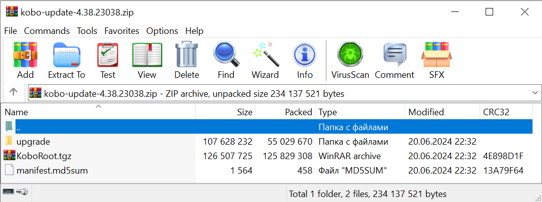

what files should I put into .kobo folder?
- original ZIP as is?
- TGZ inside it?
- everything from ZIP?

Originally Posted by baursak View Post
Thank you.
- TGZ inside it?
Yes, everything inside the ZIP file.
