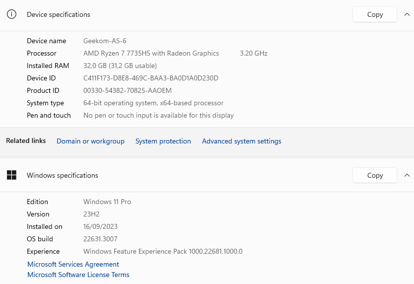

Hi!
I have installed the newest 64bit calibre in a new PC. I am unable to open the program. I've tried uninstalling/reinstalling, uninstalling and trying to use a portable version, opening via administrator.
I try to open the program and nothing happens. Nothing in task manager.
I have reviewed earlier posts but didnt help.
I am just a user but the cmd screen is rather short compared to other screenshots I have seen. Anybody can help?

Try updating your graphics card driver and see if that helps.

I have downloaded the drivers from AMD and it seems to work after the first restart. I cross fingers that it will continue working. Thanks so much!!!
