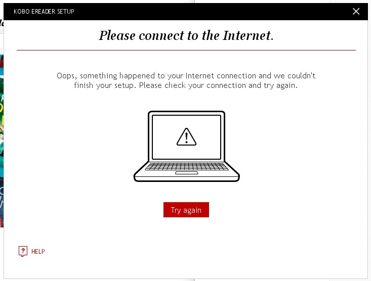

I think I've fouled up. But if anyone has any helpful comments (including confirming that I've made a mess of things), they'd be welcome.
I have a Kobo Mini, bought secondhand on eBay some years ago. I don't use it a lot, but rather like it for its portability when I'm travelling. I'm well aware that Kobo has discontinued support for it, but thought that I could still synchronise my collection of Kobo e-books with it. This morning, I tried to do that. It wouldn't connect to either my wi-fi network or the Kobo Desktop program. Was I mistaken in thinking that the books could still be synchronised?
I then performed a factory reset (possibly not the best thing I've ever done, but it seemed like a good idea at the time).
I'm now unable to get through the setup routine. It still won't connect to either Kobo Desktop or my wi-fi network.
I've uninstalled and reinstalled Kobo Desktop. When I connect the Mini to my computer, Kobo Desktop says that it's downloading an upgrade for the e-reader, but then (after the download is apparently complete) complains that there's no Internet connection.
I'm now unable to complete the Mini setup.
Have I bricked the Mini, or is the situation recoverable?

not sure, but maybe the activation server is offline for the mini?
i dont have a mini so i cannot test but, i would try skipping the setup, if the device is old, kobo might not have blocked it.
the device does show up in the explorer as a storage device, right?

No, it doesn't show up in Explorer - presumably because it's stuck at the beginning of the setup process and so doesn't give me the usual message about having detected a computer and inviting me to connect the e-reader to it.
I'd be very happy to skip the setup if that'd allow me to load books from Calibre (or directly through Windows Explorer) and then read them. That'd be a fine, if not perfect, solution.
I took a quick look at the site t which you linked and fell at the first hurdle. It wanted me to install DB Browser for SQLite, but the link was broken. I think I've found it elsewhere, and will now try to see if I can follow the instructions given. At this stage, I'm not terribly confident, given that the device isn't even visible in Explorer. I'll report back when I've given it a go. (Even the "Easier option for average users" looks plenty complicated to me!)
