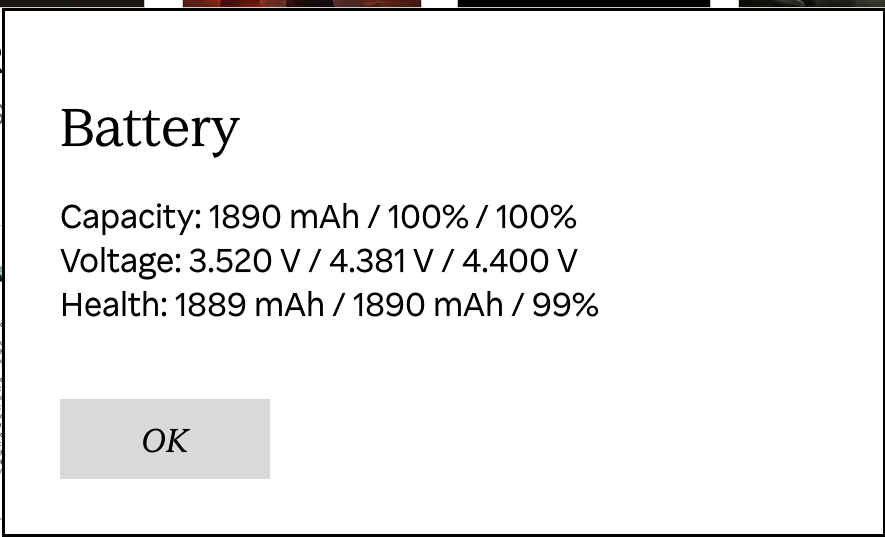

Played on my Libra Colour and changed battery to bd71827_bat in the shell script. I've attached the script (renamed to battcalc.sh.txt so rename back) and an image of the popup.
My first pass at the changes screwed up when I copy/pasted the script and the line endings were changed to CRLF. Used Notepad++ to change them to LF and all was happy.

echo Capacity: $c_now mAh / $meter% / $charge%
echo Voltage: $v_min.$v_minr V / $v_now.$v_nowr V / $v_max.$v_maxr V
echo Health: $c_full mAh / $c_dfull mAh / $c_health%

Once again, DNSB comes to the rescue!
Thank you!!! Just tried your mod. It works on the Libra Colour. Still not very accurate, as it shows a brand new Libra Colour not at 100% battery capacity (perhaps rounding error?). But better than nothing!

Good to hear that it works for you. Yeah, 1889 of 1890 is a bit better than 99% but the most Linux shells only do integer operations so 99% is displayed rather than 99.95%.
Perhaps someone will create a version of the script using if/then/else to allow operation on a wider variety of devices without needing editing.

It's interesting that the Libra Colour still has all the statistics. IIRC other models like the Clara and Sage don't report as much information.
If you think 1% is "not very accurate", wait until you check the stats while charging and it says your battery is at 4.8 V. (If that were true, your Libra would be exploding and on fire lol.)
I've noticed that shyhermit isn't the first person to dig my battery statistics script out of the NickelMenu thread; maybe we should have a dedicated thread for people to post NickelMenu scripts and sample configurations?
