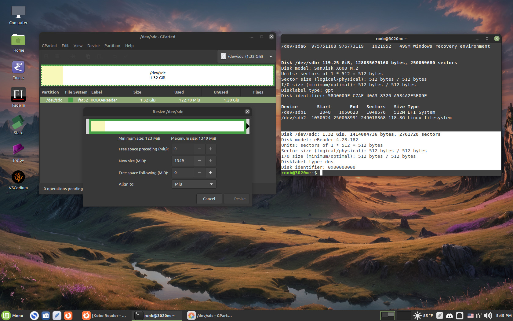

I was reading in another thread (comparing the older Minis with the newer ones) and saw that you could repartition the newer Minis to use all 4 GBs instead of only 2 GBs. But when I use Gparted, I only see 1.3 GBs and it shows the full SD Card is allocated. Am I missing something or did this change with a later firmware release?
I've attached a screenshot of my Gparted and fdisk information. I don't see any unallocated space to resize to.

That looks as if you are looking the Mini over a USB connection. That will only show you the exposed partition not the entire µSD card. You will have to remove the card from your Mini and then repartition it mounted directly on your computer. Have you already opened the Mini to see if the µSD card is indeed a 4GB card?

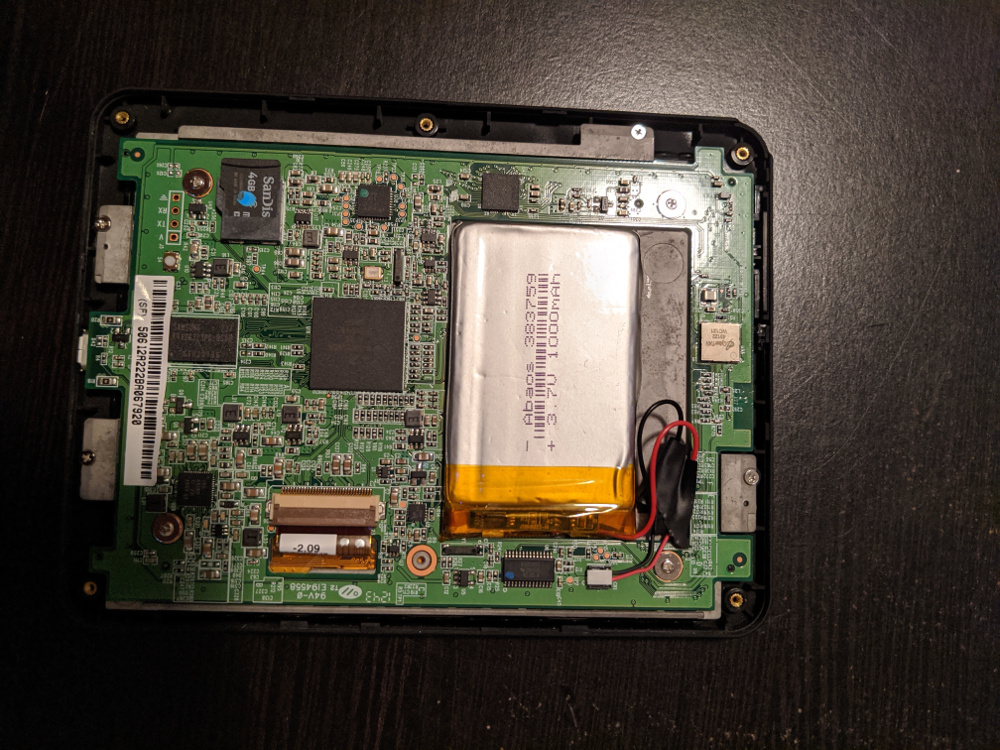

Yes, I was definitely using Gparted via the USB cable. Please pardon my ignorance. If I understand correctly I don't have to repartition the SD Card, just resize it, correct? And it definitely does have a 4 GB SD Card, I took a picture of it when I installed the new battery two and a half years ago (see attachment).

When the partition is exposed over USB, what is exposed is the partition and not the partition and any free space. So removing the card and resizing the FAT32 KoboeReader partition and reinstalling it should work for you.

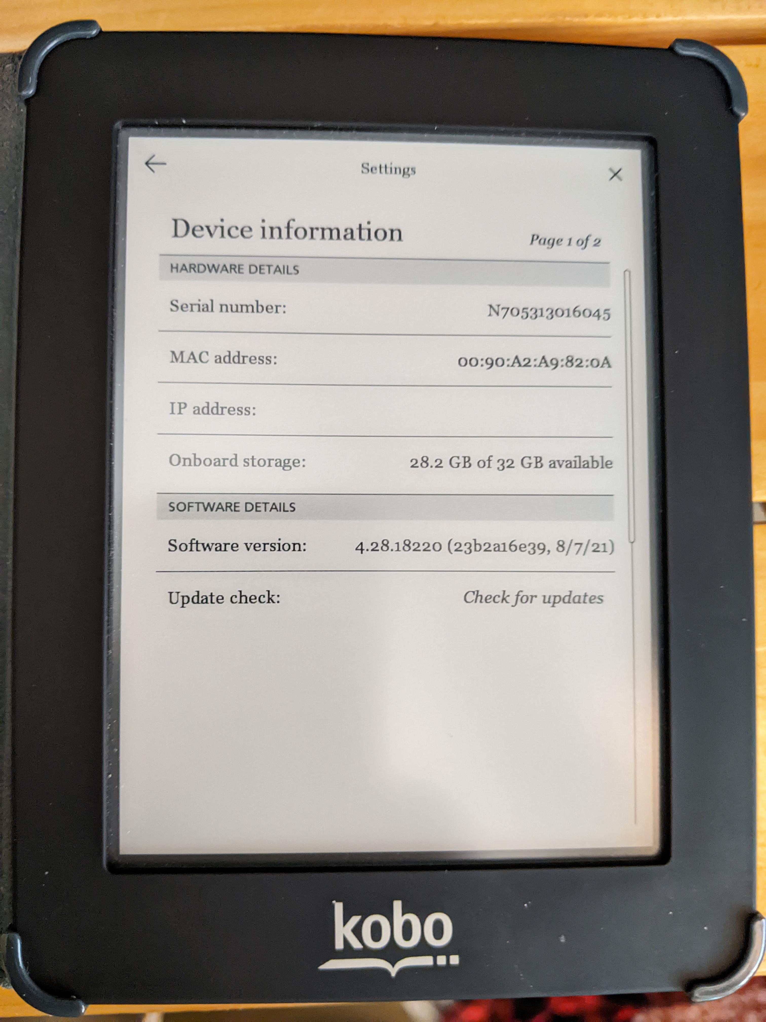

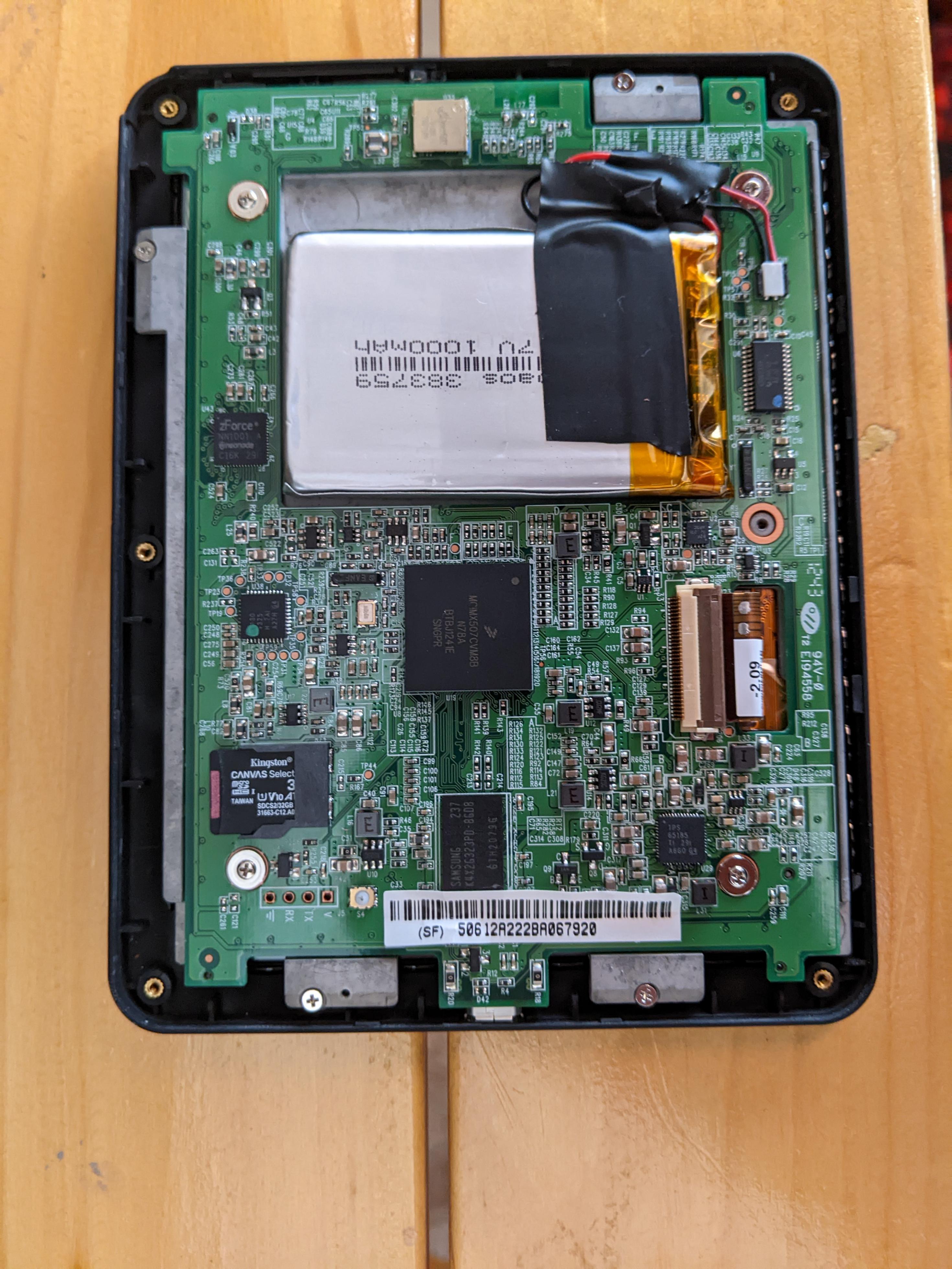

Thanks everyone. I was able to remove the SD Card, expand the partition, re-insert the SD Card and test it. I had 3.2 GBs of space instead of 1.3 GBs. Then, taking JSWolf's advice, I took the SD Card back out, backed it up to an image file and copied that file to a 32 GB SD Card. In my case I did have to expand the partition with Gparted afterwards. At any rate, I've got 28.2 GBs of space available on my Mini now. (What I'm going to do with it, I have no idea.)
And, for backups, I still have the original 4 GB SD Card and the Image file.

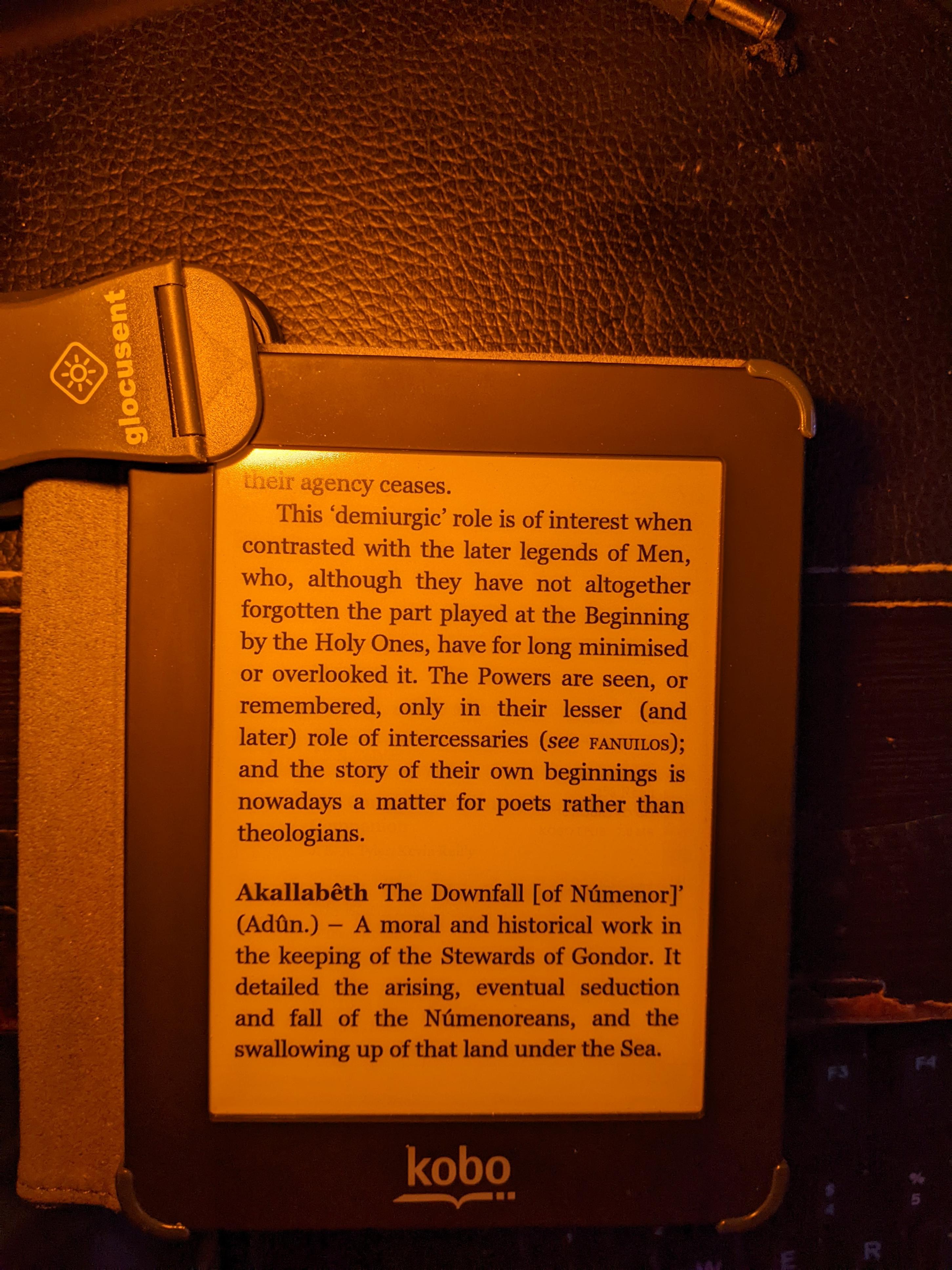

But, by combining the Mini with the Glocusent light (in amber setting), this makes the Mini a very nice reader. By clamping the Glocusent over the cover, it holds the cover solid and the flap doubles as a wider bezel. So, even with the added light clamped on (1.6 ounces), the combination is still light and comfortable to hold. I can see myself reading a lot more on the Mini now.
But I still don't need the 28 GBs of space. That definitely was done for the fun of it.
