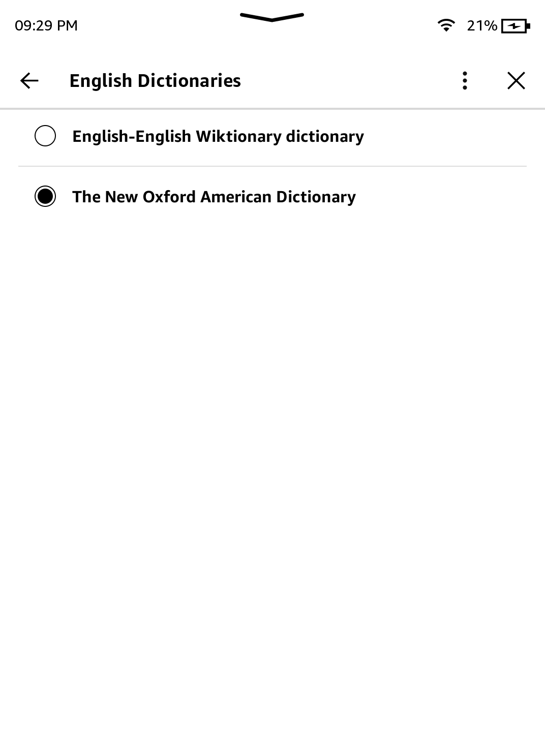

OTOH, I seem to remember it being mentioned that the Mobi dictionary format was not the same as the standard mobi format.
Edit: Just for the heck of it, I copied the English-English Wiktionary file into /documents/dictionaries on my Paperwhite 10th gen. It showed up when I displayed English dictionaries and I was able to select it. A word lookup from within a book worked. All in all, I would say the dictionary does work on a Kindle.
ID:	207928   Click image for larger version
ID:	207929   Click image for larger version
Well, it is standard mobi, and there was a specification for it on Mobipocket.com (probably still kicking around on Archive.org?). It has not changed as far as I know.
Seems there may be encoding issue?

Seems as if it works on my Paperwhite 10th gen.
When I unpacked it and then unpacked the kindlegensrc.zip file, it seemed to match what I saw in Creating Dictionaries which has several differences from a standard mobi.
The log file indicated it was created by KindleGen 2.9 under Windows with several warnings.
