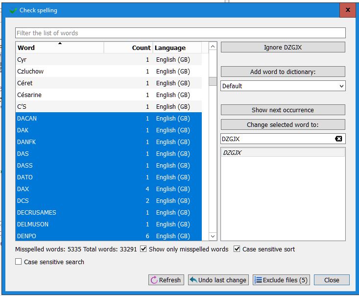

Spell check can do a Case sensitive sort.
Then Review (because Names will Be there also), The Ignore or add to a user dictionary
I know that, but
1) I don't want to load my user dictionary with a lot of words I'll never see again
2) I already skip the more 'cryptic' files with <!-- calibre-no-spell-check --> or put them in the Exclude Files list
3) Even sorted, I'll still need to plow through them all
I seleted all the ones that started with a cap D and said [Ignore] and did a [Refresh]
Not only did they come back in the list, the gray shading seems to jump around. I thought that theshading might mean 'Ignore' but it seems random

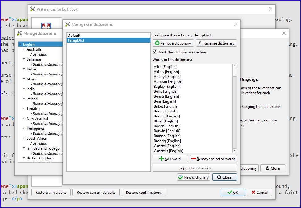

Don't confuse the system dictionary with a "User" dictionary.
You can create a temporary User dictionary which you can simply delete when you are finished.
In the image, I have named my User dictionary as "TempDict", and you can see that it is full of character names.

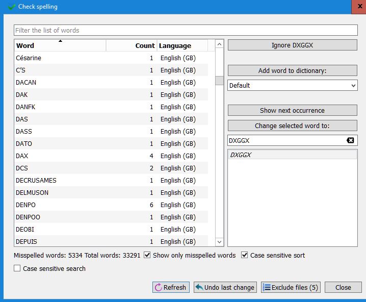

Ignore is a temporary hide. Once you close the editor and restart it, they all come back.
Thanks, but the shading seems persistent between editor sessions (see pic) and it must have taken a while to build that dictionary, even if you could import a list
Seems (IMO) that it took more work than marking a simple checkbox on Spell Check that said
[X] Ignore words in all CAPS/CAPS numbers

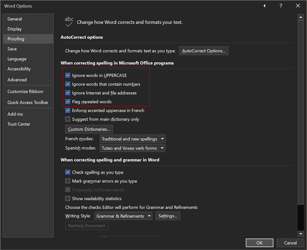

Ahhh - that explains some of the results I was seeing
Food for thought:
Name:	Screenshot 2024-04-29 073250.jpg

Food for thought:
Yea, if the spell checker had those options it would really allow the user to focus on just the important stuff
