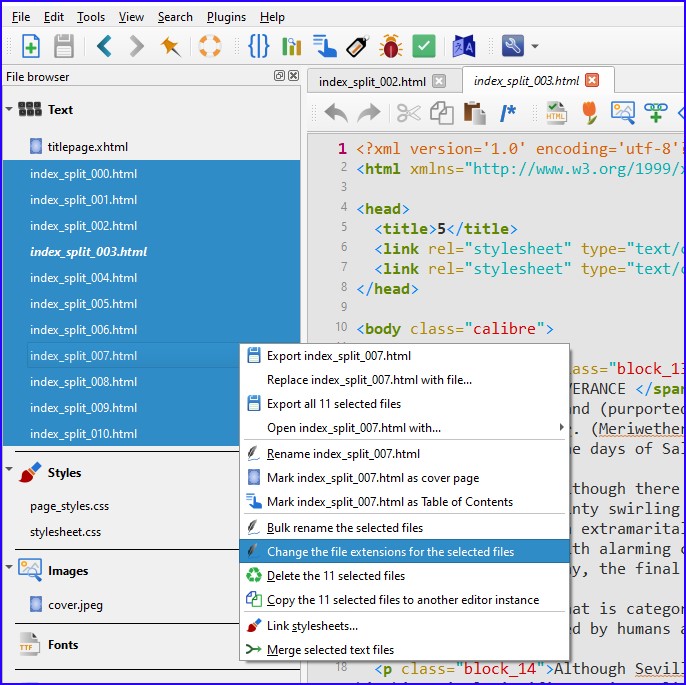

Hello @beeace336
You don't need any plugins to change file extensions.
I've had a look around the Conversion settings screen, but could not find a mention of plugins, or any setting for html<>xhtml settings. Not sure where you saw the requirement for a plugin.
But the fix is simple...
  1. Open the epub in the Calibre Editor,
  2. highlight the files that need changing,
  3. then from the context menu, select "Change the file extensions for the selected files".
  4. Then type xhtml in the box when it pops up.
  5. Save the file if you are happy with the change.
See the image...

Originally Posted by Karellen View Post
Hello @beeace336
See the image...
