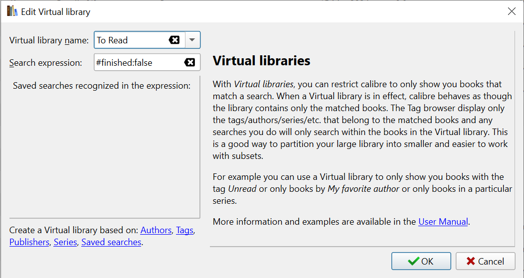

Use Virtual Libraries. These are a view of the database based on search and saved as virtual library. Then you just use the Virtual Library(VL) as your main view. You can many VLs as you need and switch between them as required.
The manual page explaining it si https://manual.calibre-ebook.com/virtual_libraries.html

THEN
You create a VL to show those with that column True (aka ticked) or False
As I stated. Since I have additonal formats OR Empty books (no format, just an entry) I refined my filter. True or False might serve you just fine

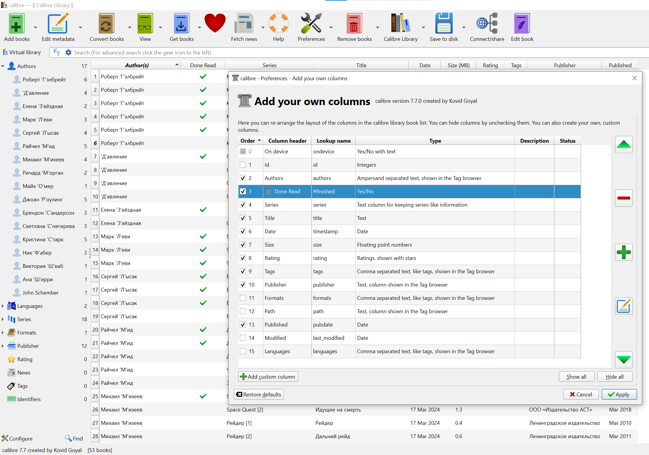

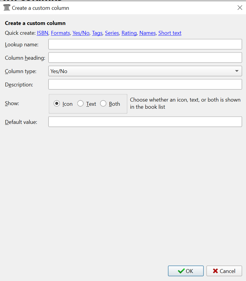

what should I put in all the fields of this "Create a custom column"?
Name:	calibre theducks 2024-03-19 103816.png

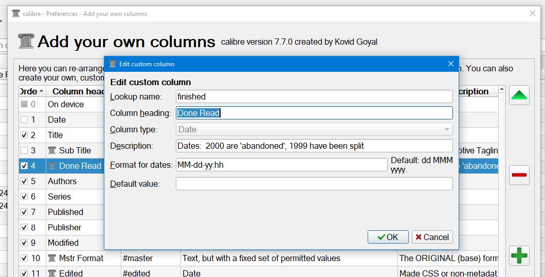

The Beauty of Calibre is you DO NOT have to do it JUST my way.
(This was just what I wanted to store)
The Column Label can be anything. It can be changed at a later time. ( Keep i short so thew column does not get wide just to show the label)
OTOH The field TYPE can't. Which is why I suggest you give True/False a future use think before going down that path

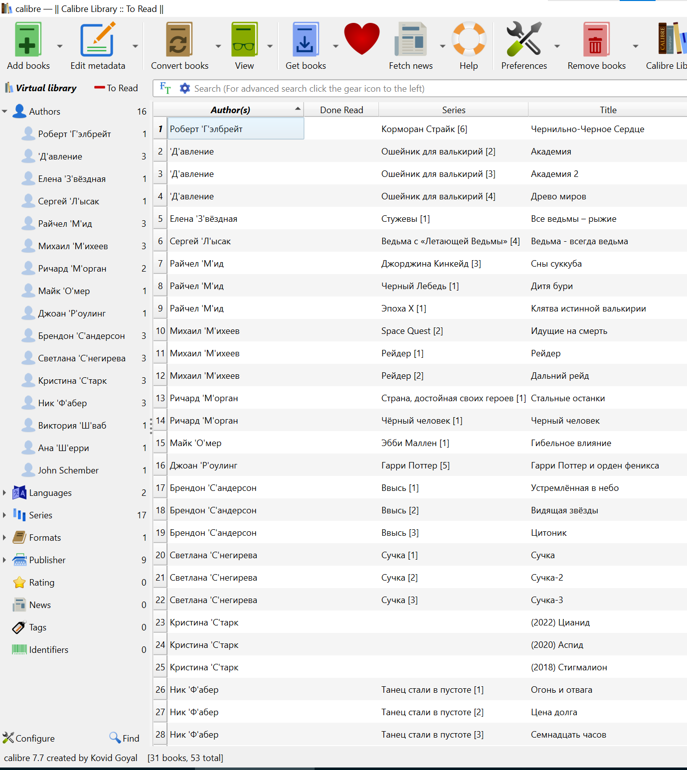

thank you: I finally coped with this
- God bless you
Name:	calibre theducks (2) 2024-03-19 215228.png
ID:	207006   Click image for larger version
Name:	calibre theducks (3) 2024-03-19 215329.png
ID:	207007   Click image for larger version
Name:	calibre theducks (4) 2024-03-19 215428.png
