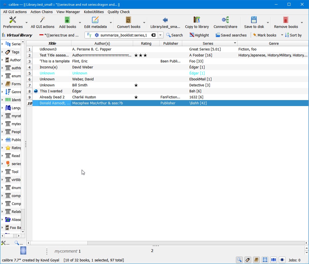

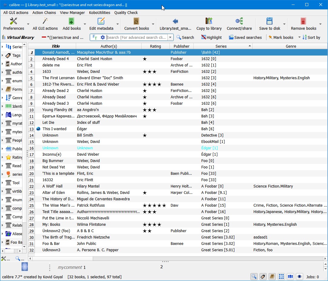

Here is an example of summarizing the book list by series. The first capture shows several series on the book list, sorted by series.
This capture shows the result of the "summarize_booklist:series,1" search:

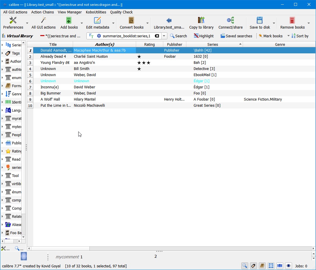

This capture shows the result if the book list was sorted series descending before the "summarize_booklist" above was applied.

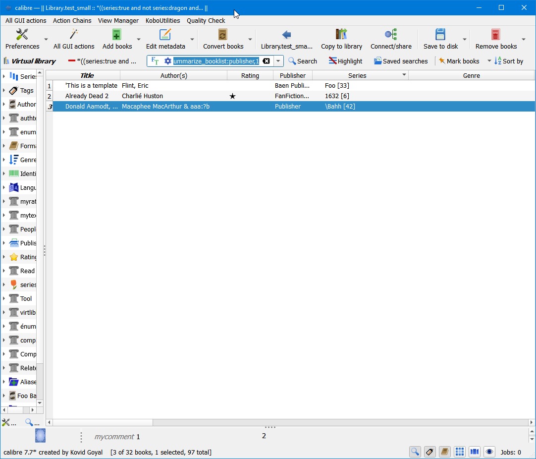

And finally, this capture shows the result of applying "summarize_booklistublisher,1" to the result of the previous summarize.
