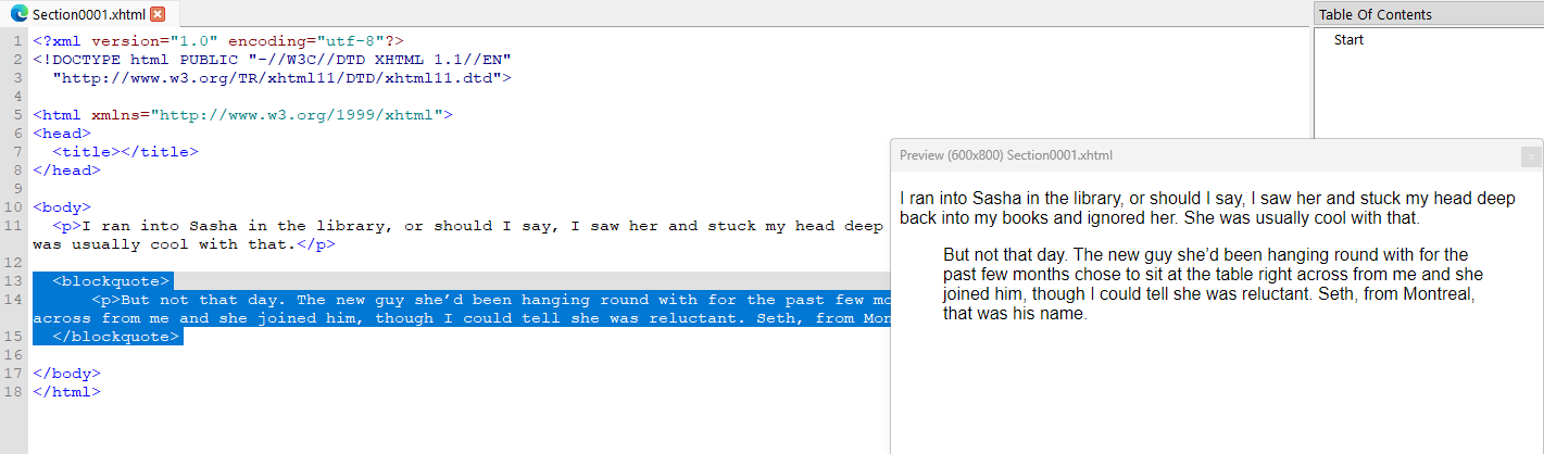

It is the intended behaviour. It is not supposed to modify the appearance of the code but of how the code is rendered for the user to view. Pop up the Preview screen and see the effect. Please note all the tools in the Format group affect how the text displays and should not affect how viewing the code.

Yes, DNSB is correct. If you want to clean up and indent code in CodeView check out the Mend and Prettify commands. Note using Mend and Prettify on correct code should have no impact on anything in Preview, just CodeView.

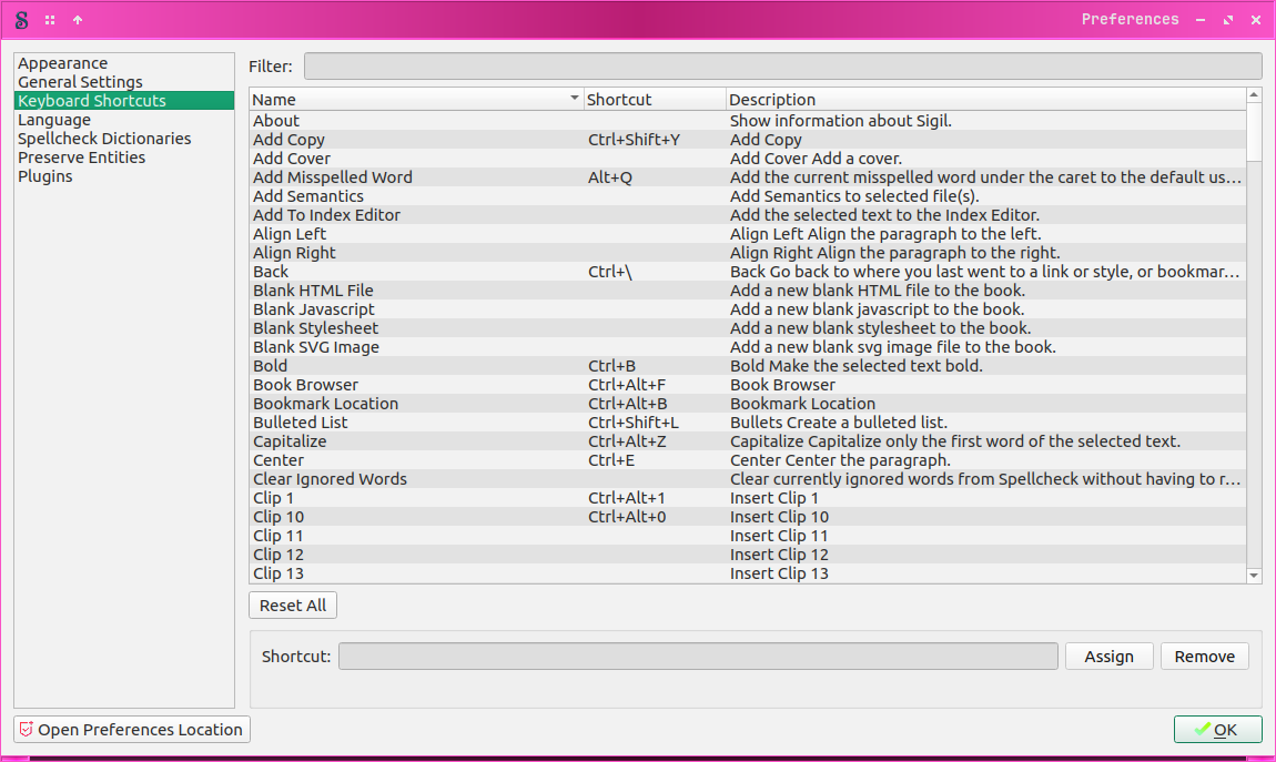

Or if you have an international keyboard layout, you may also need to indicate as much with the checkbox at the bottom of Sigil's keyboard shortcuts preference page.
Which checkbox are you referring to? I do not see it.
I attacged the Shortcuts dialog I have.
I thought I was going crazy when I couldn't find it on my Arch Linux machine! Then I remembered that it's a Windows only setting. Sorry about that. I'm not entirely certain why your new shortcuts aren't working.
And to answer your previous question: no, there's no way to customize/tweak the Prettify feature. The only thing you might be able to do is use an external editor that will format the code the way you want it and then don't use Sigil's Prettify.
