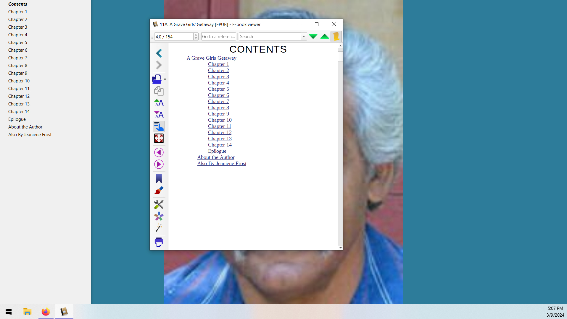

I use the Calibre ebook reader on my PC to read epubs when I'm at home instead of using my tablet. I have a real problem with the fact that the Table of Content for an epub is NOT opening in the reader but separately on my desktop.
How can I get that to open in the reader like it used to do?

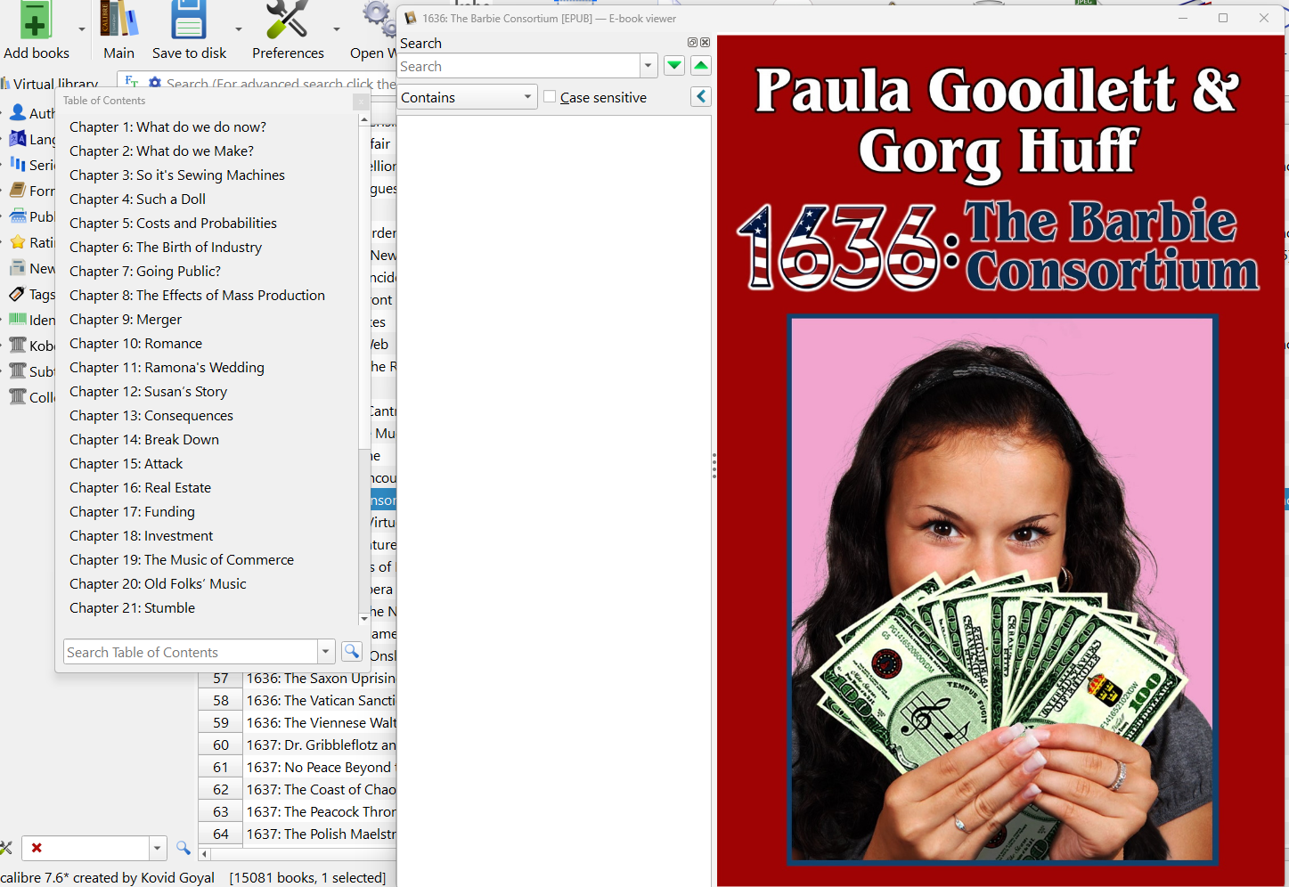

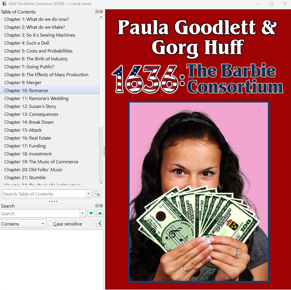

Since your image does not open, I'm guessing you undocked the ToC pane. To redock it, simply double click on the ToC pane's title line. I've attached two images to see if they look like what you want and what you are seeing.

That displayed page appears as if you are showing a HTML table of contents not the machine use table of contents. The machine ToC appear to be off to the side with the title bar out of view. You will have to drag/shrink the ToC window to get to the title bar into view.

@DNSB: Interesting desktop wallpaper...

Thank you, thank you, thank you!!! It took some finagling to get the ToC window to shrink so I could get at that title bar but once I could the double-click did indeed redock it to the reader! Makes it sooo much easier to use considering I have two 40" monitors and if I have the reader open on the right hand monitor and the ToC shows up on the left edge of the left monitor it got kind of fun!
That's my husband who died back on 04/17/2021
wildchild1954 is offline   Reply With Quote
Old 03-10-2024, 01:53 AM   #11
ownedbycats
Custom User Title
ownedbycats's Avatar
Posts: 11,365
Karma: 79528341
Join Date: Oct 2018
Condolences. I didn't realize that it was a repost of the image you tried to put.
