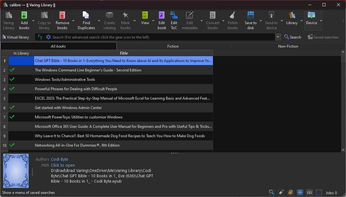

When I click the drop down menu on the Device button on the main toolbar, then click Show books in main memory of device, a large list of books comes up. But there is no device connected.
Looking at the In Library column in the list some are marked In Library and some are not. The location on all of the books in this books on device list is the location of the library that I currently have loaded. So this means there books saved in the library folder but not marked to be in my library. I think maybe some books are ones I have deleted.
I don't understand why there are books showing to be on a "Device" that are actually save in my current library and many are not actually showing not to be imported in the library when there no device actually connected.
Please help.

That screen capture shows that calibre thinks a device is connected. I suspect it is a "folder device". Click on the device icon and disconnect it. You might also have set the tweak to connect to the folder at startup: Preferences->Tweaks->Connect to folder at startup

Look at the path shown, you have ONEDRIVE----connected as a device.
https://manual.calibre-ebook.com/faq...rked-drive-nas

That is that is the folder location of my library. Why would it show up as a device. It is just a folder.

Using a cloud storage for your library is not a good idea. See the link posted by @gbm and then do a search on the calibre forum to find a overly long list of issues using cloud/NAS/network storage for your live library. Mostly along the lines of 'I've used this for years and now my library is borked'.

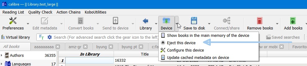

That list is a device view, which only happens when a "device" is connected. So *something* is connected. Check that you haven't left something in the connect to folder tweak, which BTW has nothing at all to do with where the calibre library is placed. In particular, you must not put the path to a calibre library in that tweak.
This is what I see when looking at a folder device view and right-clicking on the device icon.

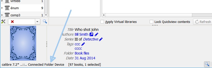

And this is what is at the bottom of the screen on the library view.

If you see something different, please show us the screen captures.
