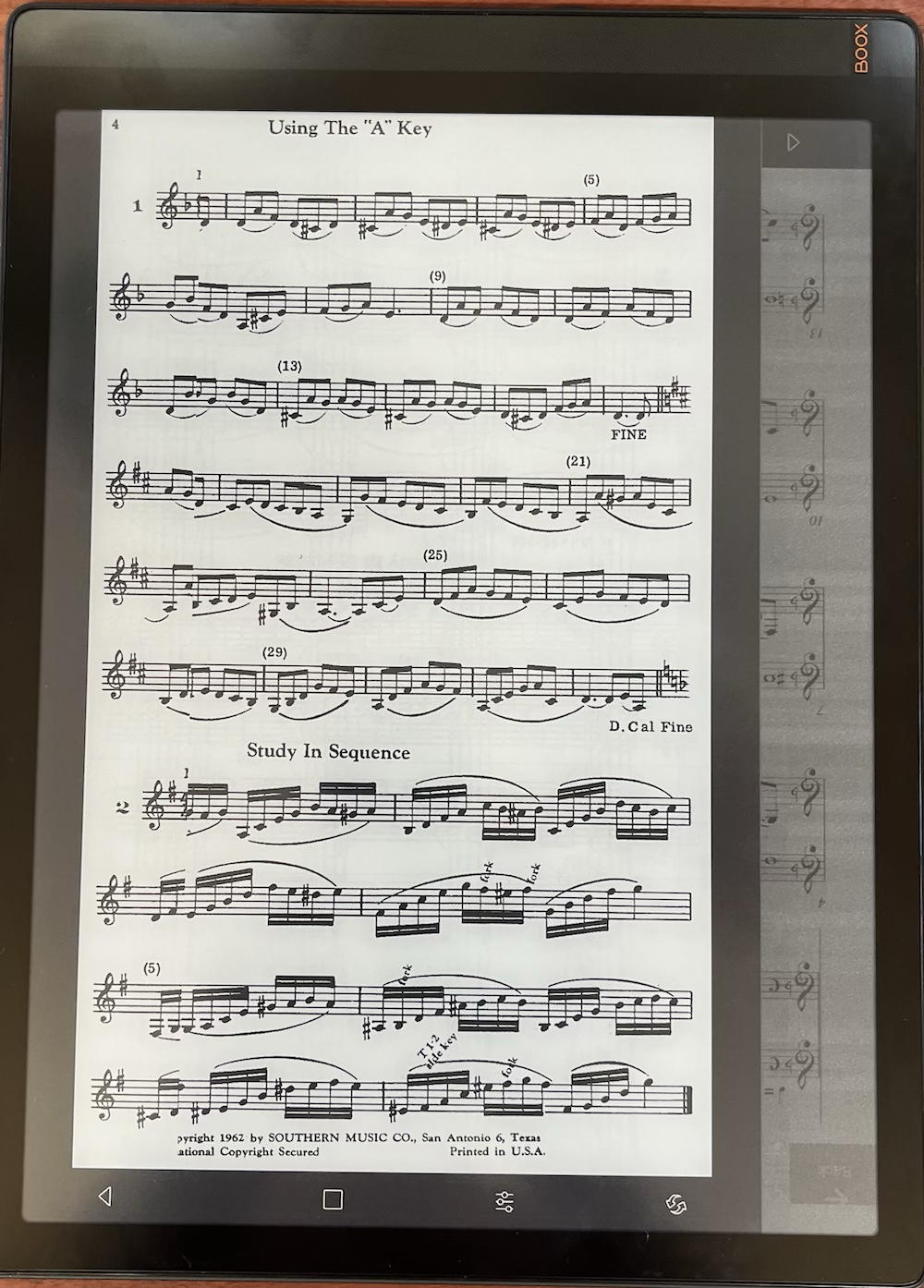

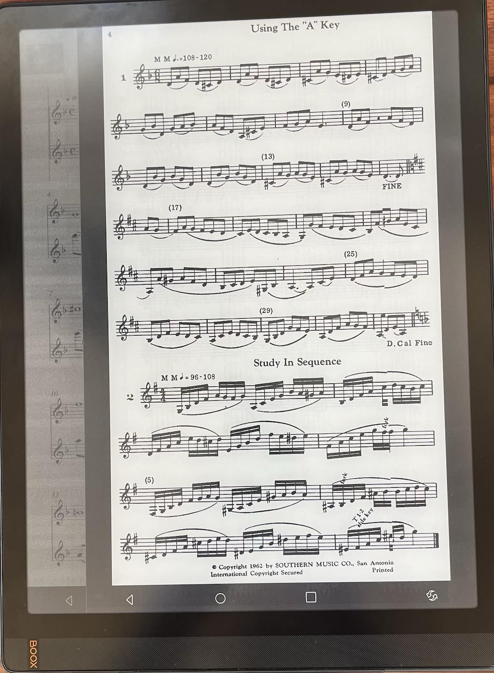

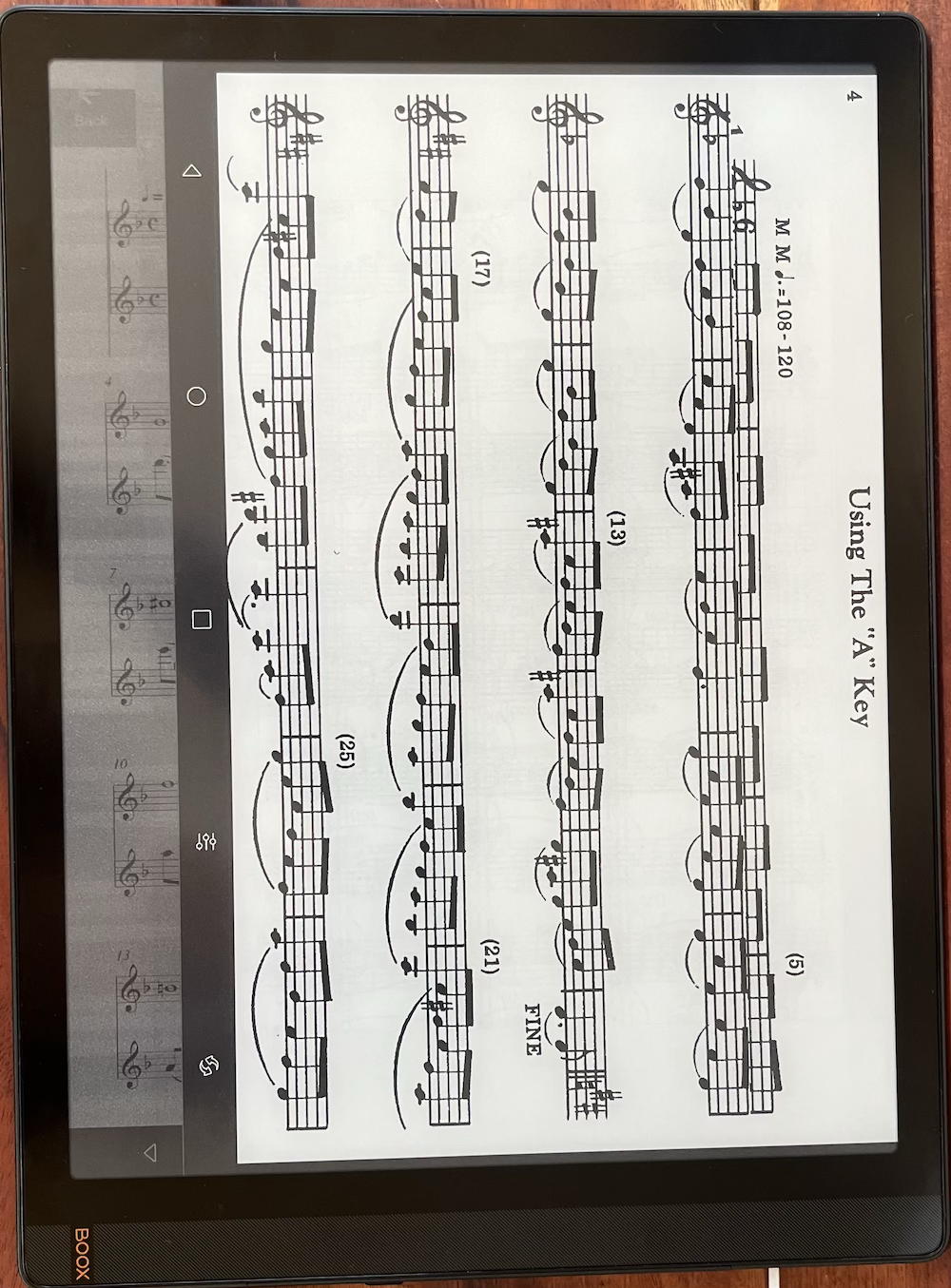

Hello,
after starting up my Tab X I got a weird screen offset issue.
The device's active screen is somehow offset with the touch input still in the right place.
Sometimes I get a normal screen back with a screen refresh but it comes back again.
A restart / shutdown did not help so far.
Anyone have an idea if this could be a hardware issue? The device is fairly new ( October 2023 )
Or are their any other software things I could try?
Thanks a lot for all suggestions

That is very weird. But the TabX is not a BSR device so I don't think it's hardware.
Are you running on the latest software?

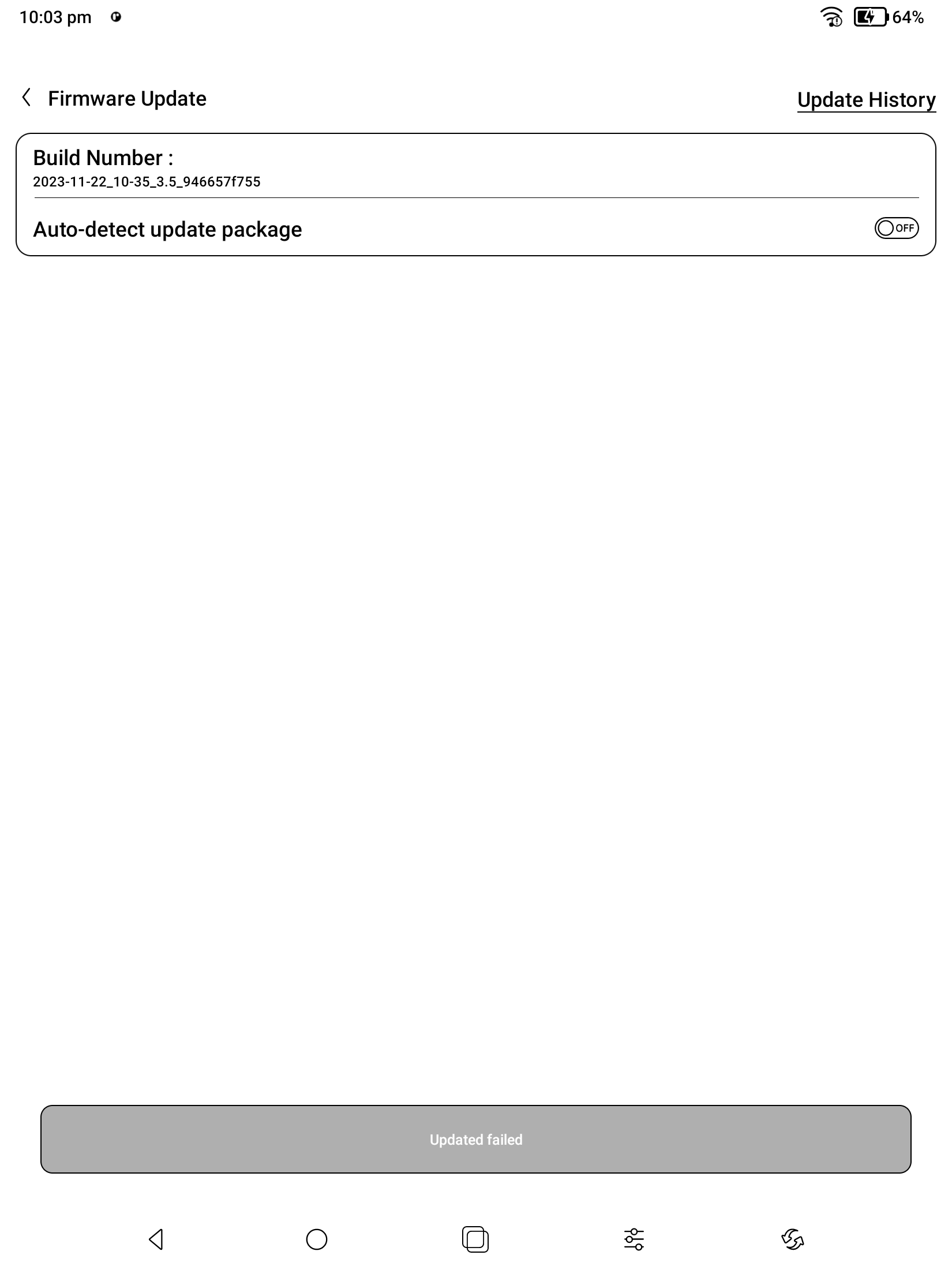

just for good measure I did run the update again. But it would refuse to update as it is already on the latest version. ( see Screenshot )
I can also see the differences.
However finger still puts out the same info as posted earlier.
Works though ��
Thanks for your help!

Update: After some hours the issue came back.
Not really related to any special activity that I could specify.
Left the device and when I came back found the display with the offset again.
Only noticable irregularity was, that there was no sleep screen image.
Display showed the home screen with the offset but device was asleep.
