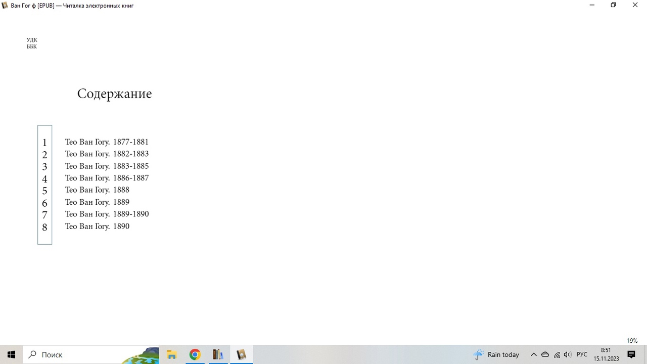

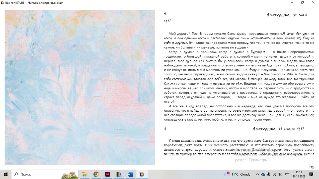

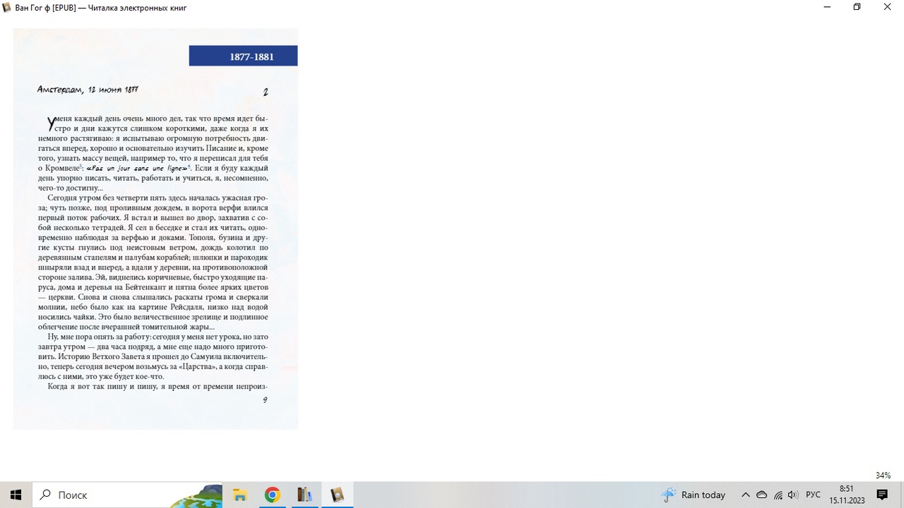

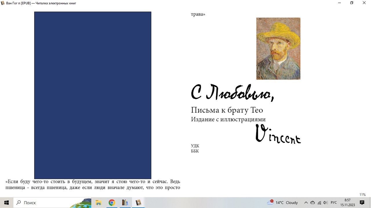

First of all, I would like to say that I am not a native English speaker, so there may be mistakes. But I hope you will understand my problem and help me solve it)
I made an e-book for myself through an InDesign and saved it in Epub format marked "recomposable layout". When opened in Calibre, ebook and ReadEra, the design absolutely breaks! When saving the file to InDesign, I put the cover in jpeg format. When opened in applications, the jpeg cover remains, but then the cover + content also goes, but disassembled into parts! (see attached photo 1-2). In addition, the book background and footers are separated from the text!(3 photos). In addition, it is important that the footnotes in the text still work when repairing the file.
However, if I save a file marked "fixed layout", then the design looks fine. BUT footnotes in the text do not work (see files 4-5) I do not know what to do...Design is an important component for me, but footnotes are also very important. I would like everything to look whole.

InDesign is primarily for paper.
Create a good styled docx and import to Calibre and convert to epub is better (and if you use odt files on LO Writer with an extra Save As in docx, it's free).
Fixed Layout is like an epub version of PDF, so since InDesign is good for PDF that works. But Fixedlayout doesn't work on many apps, or readers or small screens. PDF is preferable to Fixed Layout epub, but neither makes good ebooks (which must reflow to suit screen).
Footnotes are tricky and there are 3 methods. The snag is there is no "page bottom" in real ebooks. So each footnote needs to be a separate paragraph after a chapter and linked (entire word and [3] etc number so it can easily be tapped. Then the footnote needs to have a link called [back] to the original location. Popup footnotes are unreliable and only some devices/apps.
If it's a short comment of a few words then putting it right justified just after the paragraph works well on ereaders. Some don't have touch screens (even new ones) and then you have to use navigation buttons to the link.
[A short note]
Then the next paragraph.
It's a mistake to too closely replicate paper books unless it's a PDF. Fixed Layout epub is a book-replica format as an alternative to PDF with slightly more user-side flexibility. Really for 10″ or larger screens.

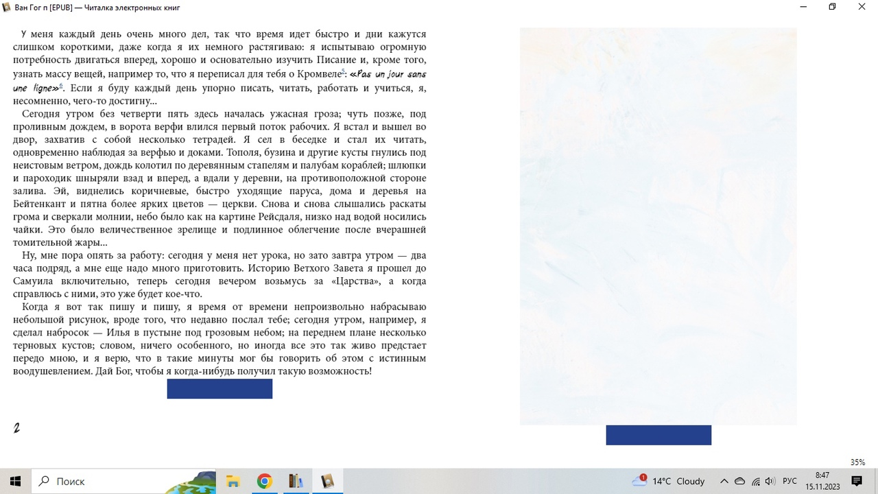

Maybe I did something wrong, but the design is still breaking. If I understood correctly, it was necessary to act according to this algorithm: 1. Create a new file in the Word and transfer everything from the InDesign there. 2. Save it in doc format, then open it in Calibre. 3. In Calibre, convert it to Epub format.
The background that you could previously see in the screenshots is separated from the text.

Maybe instead of playing around with 3rd party programs hoping for better conversions, wouldn't it be easier to just fix the existing epub?
I don't really understand what you mean here. Your previous image in the first post also shows the background separate. Are you saying the text should be on top of the background?
Is your book in copyright? Do you want to post your book so we can see what the actual problem is? At the moment we are just guessing.

Save docx, not doc. They are quite different!
Also the paragraph styles need to be created /set, that won't be automatic, between 1 and 2. Calibre creates the CSS from the style set for a paragraph (includes headings, basically ANY text terminated by <enter key>). The HTML is based on the content of the paragraph/heading.
Also a true ebook can't have a background! It won't work on most ereaders or apps, even if it can be got to work in a desktop preview!

Actual ebooks don't need an ISBN as that's really for bookshops ordering and their POS. With a TIFF cover for a PDF you can add it if you have bought a block of ISBNs (free in Norway?). If the Printer/POD supplier is doing the ISBN, they will be listed as publisher and they tell you what white space to leave. Many bookstores will not stock Amazon paper editions.
You can send same epub to Amazon, Smashwords (for Apple, Kobo, Tolino, Scribd, Barnes & Noble's Nook etc) & PlayStore as long as it's regular KDP, not for KU release. A PDF is not so simple as Amazon, Lulu, D2D, Print24 etc all might have different rules on how crop works, allowance for binding, outer margin, vs full bleed and might not have the same page sizes.
There is no page size on "real" ebooks. The ebook reflows to fit app window or ereader screen.
Yes, I already guessed that the cover needs to be uploaded separately, and not done in a file. To tell the truth, I did the text with levels and styles already in InDesign (yes, I know that you have written many times that this is not the best option. But it is very difficult to transfer all the text to docx, and then assign styles and levels to them. In fact, you will have to redo the entire layout) and everything is OK with it. The main problem that I would like to solve is precisely the frontispiece (the page with the quote and portrait) and the content. I need it to break at least visually correctly. I can't understand why it breaks. In addition, apparently the flyleaf (blue pages) will also have to be removed.
