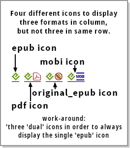

Displaying multiple icons in one column seems elusive to me...
On the topic of using icons in columns (book list view), how many icons can be placed in one column and how many on the same row? So far, I haven't been able to create more than three rules for three icons in my 'Formats' column, and I had to double up a couple of icons to simulate two icons at once(See Screenshot). Is two icons the limit on the same row, or am I doing something wrong? I created icons for the four different eBook formats I use in my library, one each for epub, original_epub, mobi and pdf.
If anyone's an expert at creating rules for 'Column icons', I sure would like to see an example of how to make 'Four' rules for one column, and have all four display on the same row. Here is what I have so far:
RULE ONE:
Set the icon with no text of 'Format' to epub_original.png if the following conditions are met:
•If the Format column contains value: ORIGINAL_EPUB
RULE TWO:
Set the icon with no text of 'Format' to epub_pdficon.png if the following conditions are met:
•If the Format column contains value: PDF
RULE THREE
Set the icon with no text of 'Format' to epubicon.png if the following conditions are met:
•If the Format column contains value: EPUB
RULE FOUR: ***THIS ONE DOESN'T DISPLAY ICON***
Set the icon with no text of 'Format' to epub_mobiicon.png if the following conditions are met:
•If the Format column contains value: MOBI

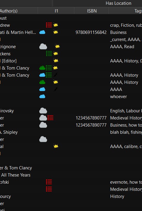

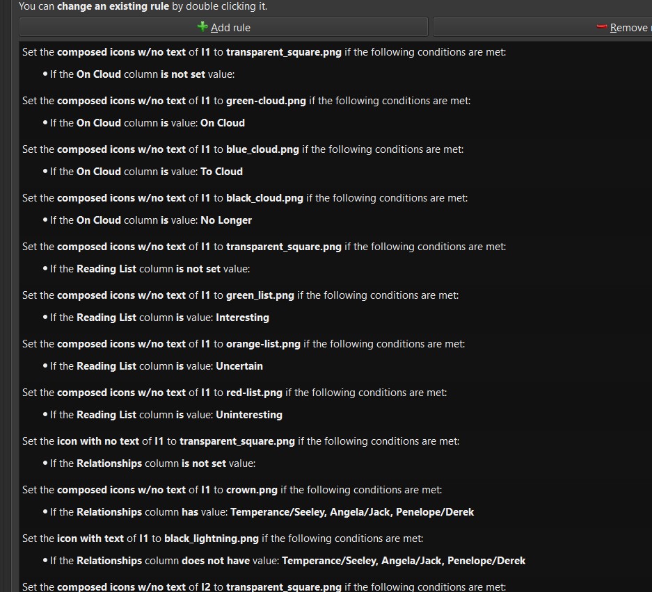

No, multiple icons on one Integer, screen shots from my Test library
Book List

Column Icon Rules
