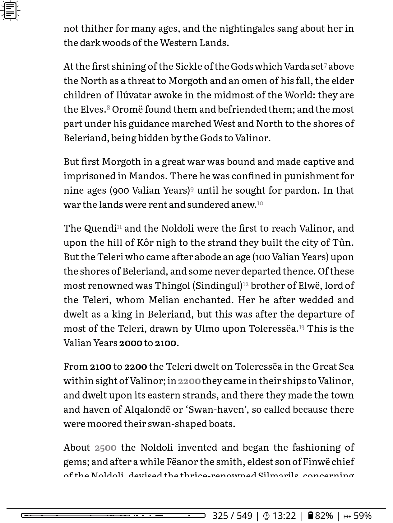

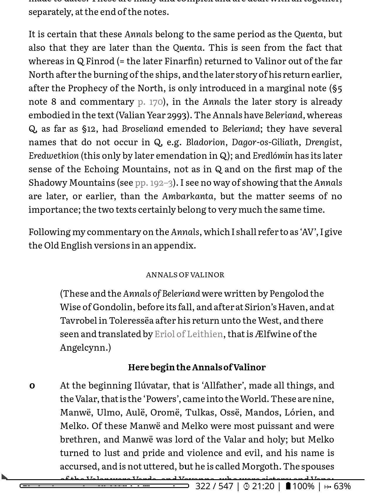

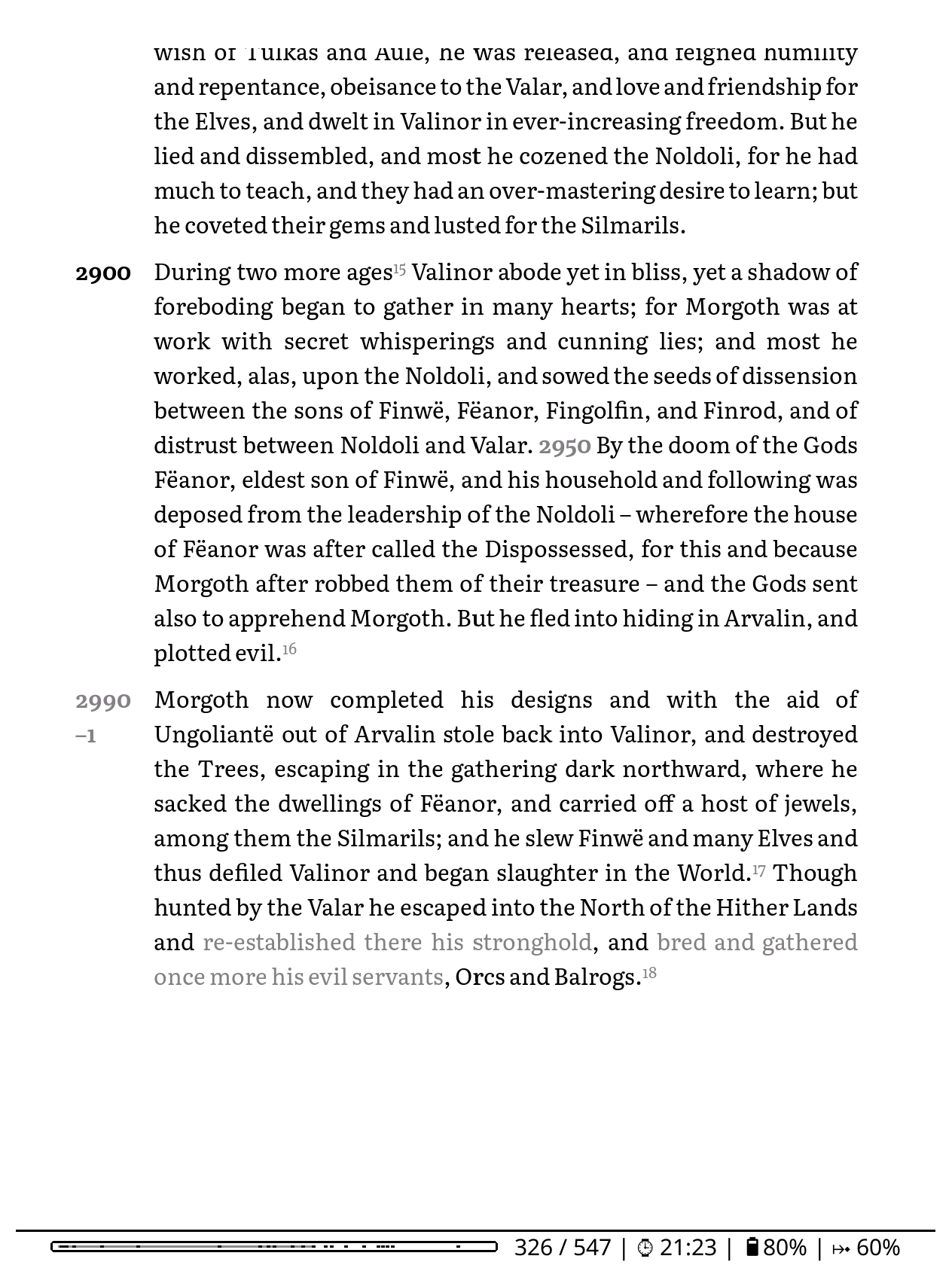

rarely in some pages a line of text is cut off. i have attached two consecutive pages where it happens, on the bottom in the first and on the top in the next. i've tried changing the margins but that just pushes the text away from the edges while still cutting it off. i've tried to enable and disable "reclaim bar height from bottom margin" but that makes it worse since it now happens on the top and bottom on almost every page.
the file is an epub and the device is a boox leaf. the view mode is set to page, not continuous. i'm not sure what else to try. if someone knows how to fix this, please help me thanks

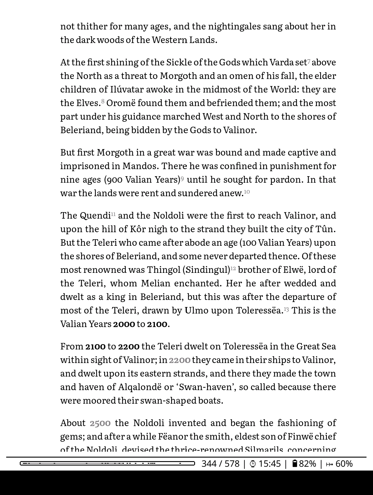

Just adjust the bottom margin. It's too small and then the stuff at the bottom is sitting on top of the last line.
adjusting the margin has no effect other than making it cut off earlier as you can see on the attached image.

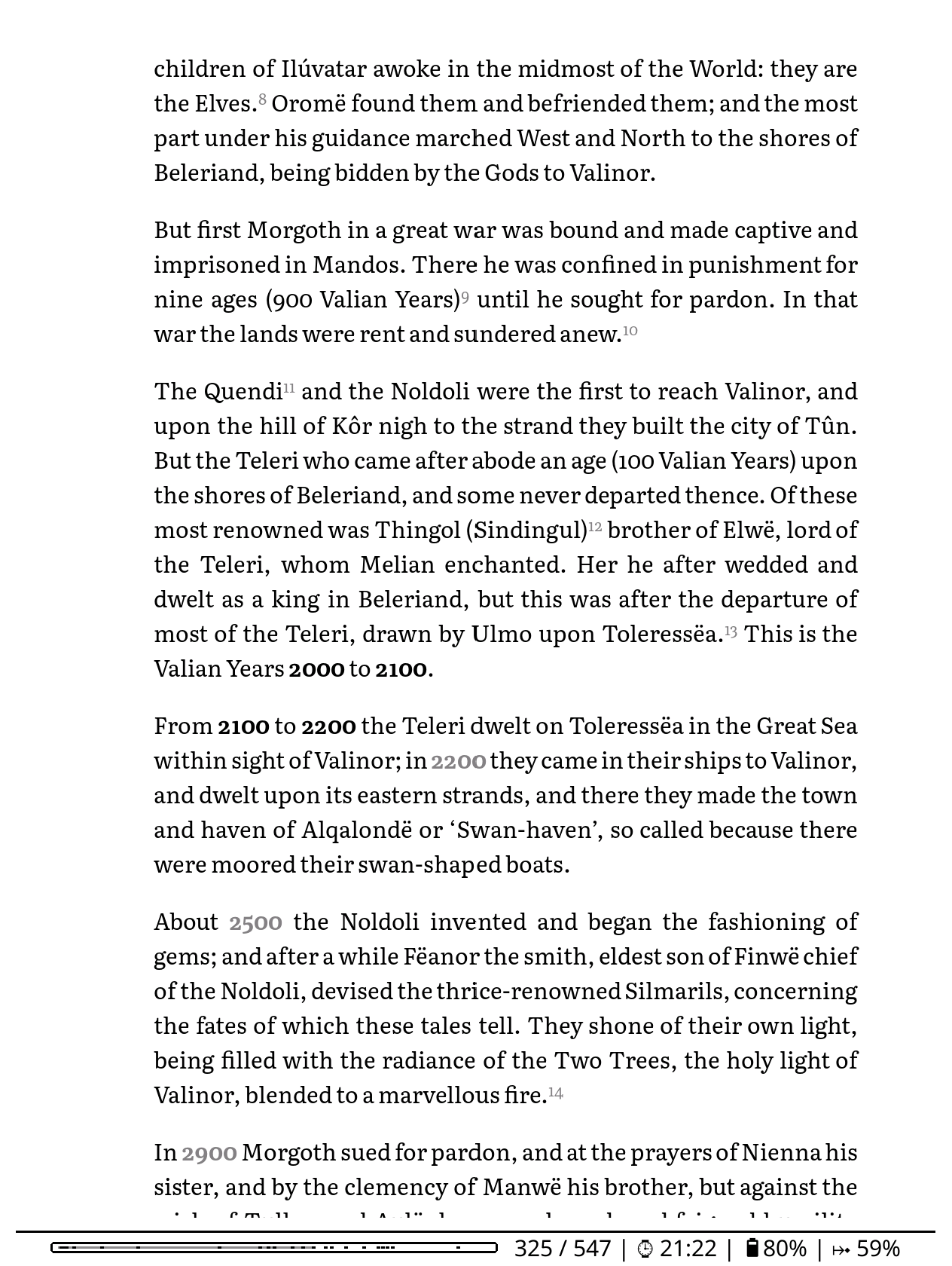

managed to get a screenshot of the black bar appearing at the bottom. the bar itself doesn't bother me and goes away after a restart. but just in case it's related
edit: to make it readable i was able to set view mode to continuous and set a page overlap of 1 line. it's not as good but works for being able to read the cut-off line

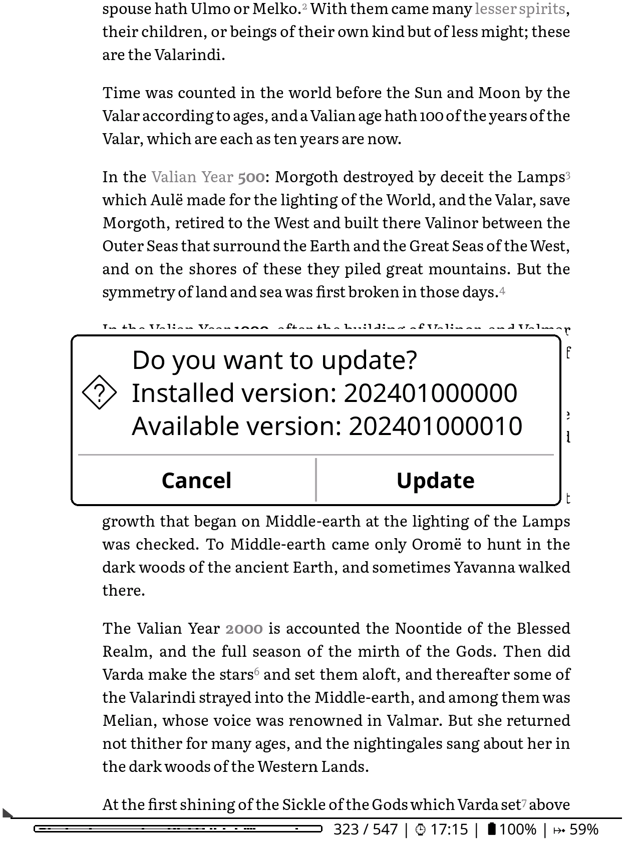

> black bar
it looks like you're running an outdated version.
Please make sure you're able to reproduce on last release or last nightly

Originally Posted by pazos View Post
> black bar
im running 202401. i cant run version that goes like 202401 with a 10 at the end because it crashes on launch with an empty crash report, i had to uninstall and install 202401
and the issue with the cut off text still happens in 202401, its not visible in this screenshot because i enabled continuous mode
