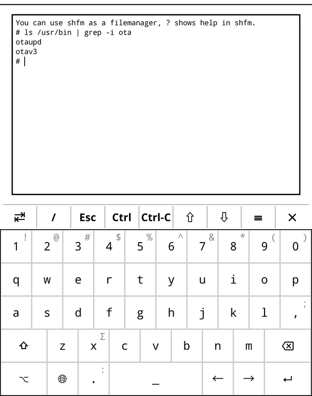

I have a KPW5 running on 5.14.1.1 However I dont see the otav3 otaupd file in the usr/bin folder. Will this renamingOTA work for my device?

Trying to rename a file that doesn't exist is not going to do anything useful.

no I dont need 5.14.1.1 . It was on 5.14.01 when I bought it.

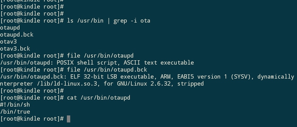

I also have PW5 with firmware 5.14.1.1. And 2 ota binaries are definitely there.
Don't get confused that grep command finds 4 matching files instead of 2, that is because I'm using a different version of that "rename OTA" KUAL extension that instead of just renaming binaries it also created shell scripts that just call /bin/true
Thanks for confirming. I only checked by ls and grep in KOReader's terminal. How do I ssh into kindle like you did.

nvm they are there. https://i.postimg.cc/HLwrXF6N/File-M...-11-124533.png
