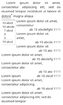

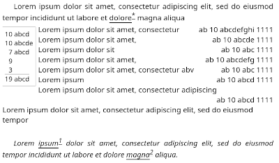

Here is the result I get on both Sigil and Caliber: when I stretch the text, it is correctly redisplayed:
On my Kobo, the lines overlap...

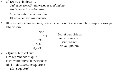

If I sideload the file in kepub, the behavior is correct... but then I have problems with the notes (styles not rendered in popups).
Should render like this:

The problem is that Kobo uses an older version of RMSDK to display ePub. It does not do ePub 3 all that well. I suggest you convert your ePub to KePub and try that on you r Kobo.
