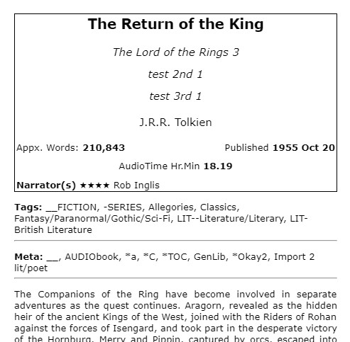

I've attached a screenshot of my setup (with some "test" names in my additional series columns).

If you want my template or a customized one, I'd be glad to help. You've certainly helped me when you can.
Thanks for the offer but I'm not bothered by "2 of whatever". Very few of my books have Series metadata. The reason I haven't removed it from the jacket is that any data in the Series column is likely to be spurious, in which case I remove it from the book.

Originally Posted by jecilop View Post
Thank You! That's what I needed. I tested including my custom series columns and have it all working as I want now.
@Kovid,
I will note one thing, however, that I didn't realize until after....using the "raw" names means it is generating a series # of 1 even when there is no series entered.
Ex: from the provided picture to BetterRed..... Test 2nd 1 and Test 3rd 1 yield just a 1 when there is not series in the blank thus printing unnecessary lines...
I had to go back to the default you have set up of "1 of ....."
