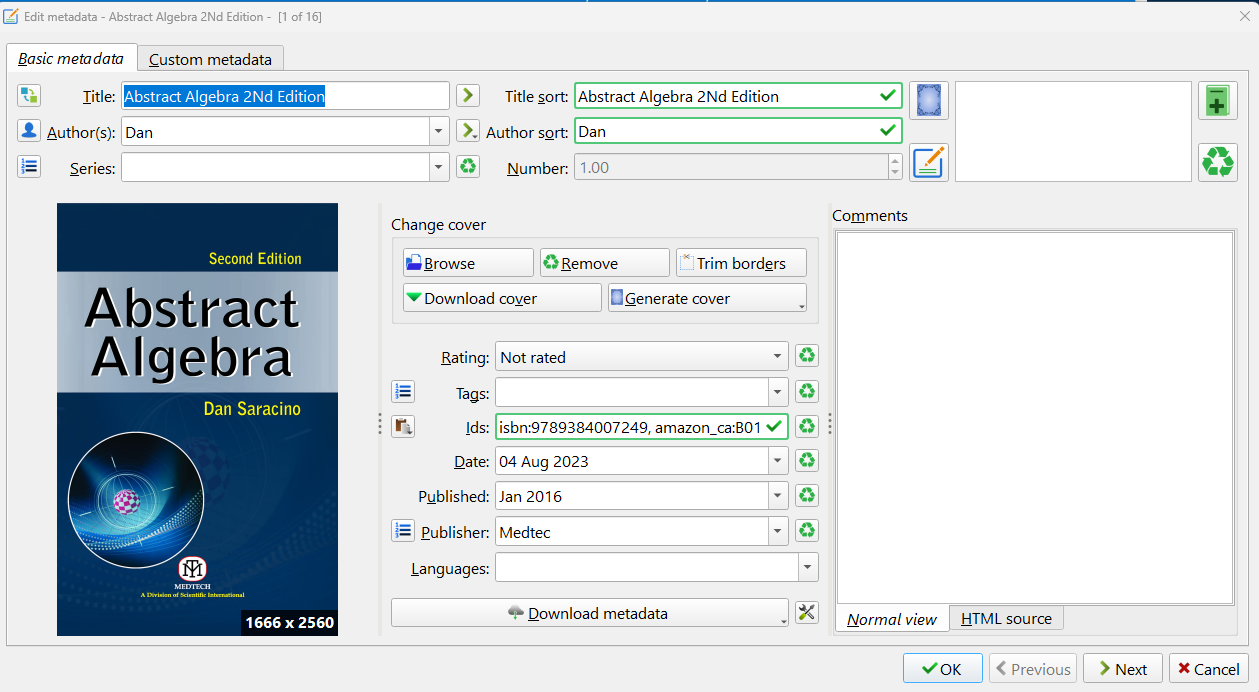

Posts: 49,028
Karma: 174631586
Oddly, when I added a book from that ISBN, it came up with a book. The title and author matched what I saw on Amazon.ca
Edit: Just for the heck of it, I tried running the same Add from ISBN 8 times. The process failed on 6 and succeeded on 2.
