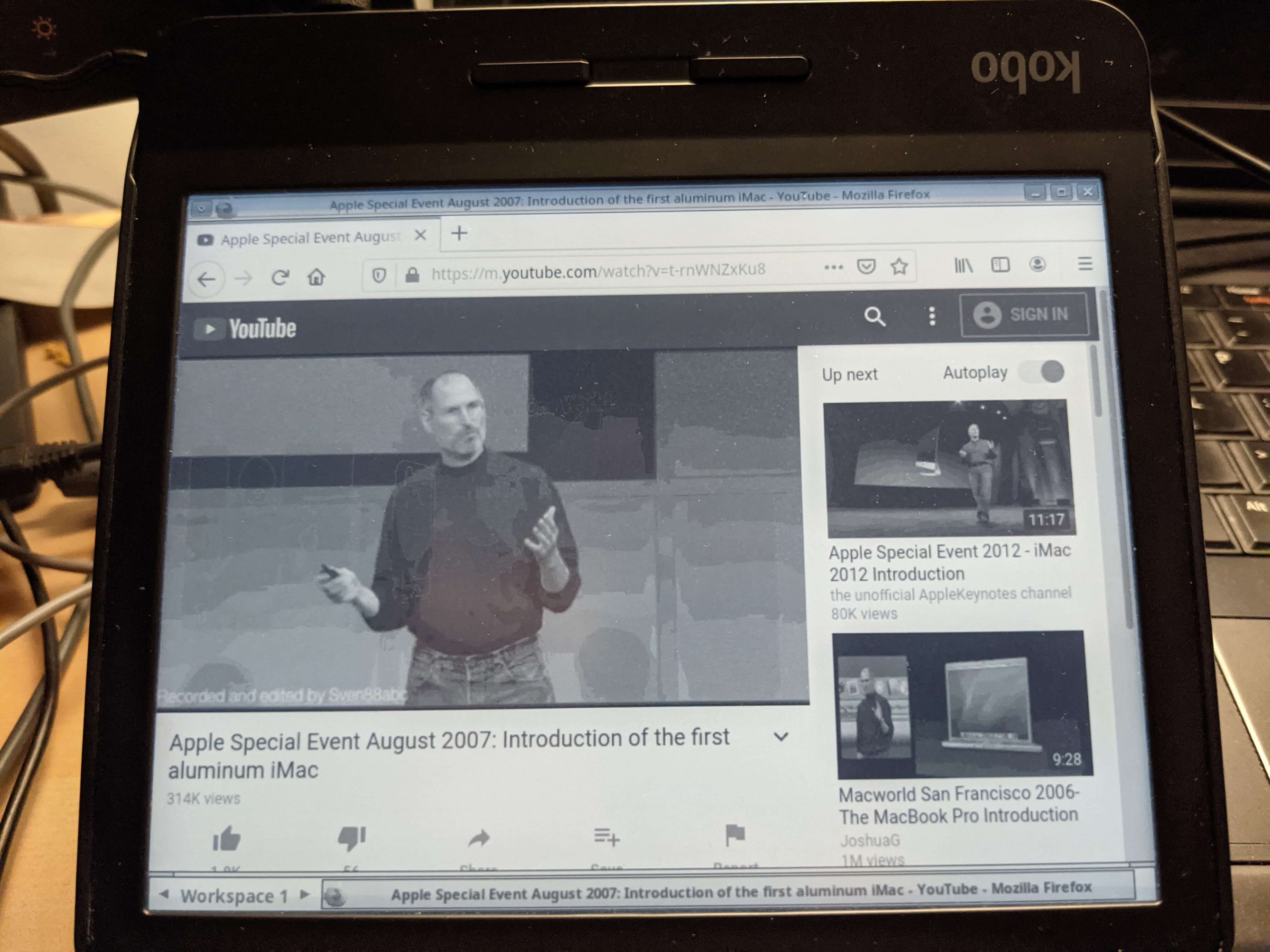

I also tried to watch YouTube from a VNC client and it was kind of... well ugly (0.5 fps in fact).
Here's a video with the new speed improvement (instructions below): https://youtu.be/qOQt6Fxew2s
Tested devices : Kobo Glo HD, Kobo Libra H2O
*If this works on your device, please let me know, and I'll add it on the list!*

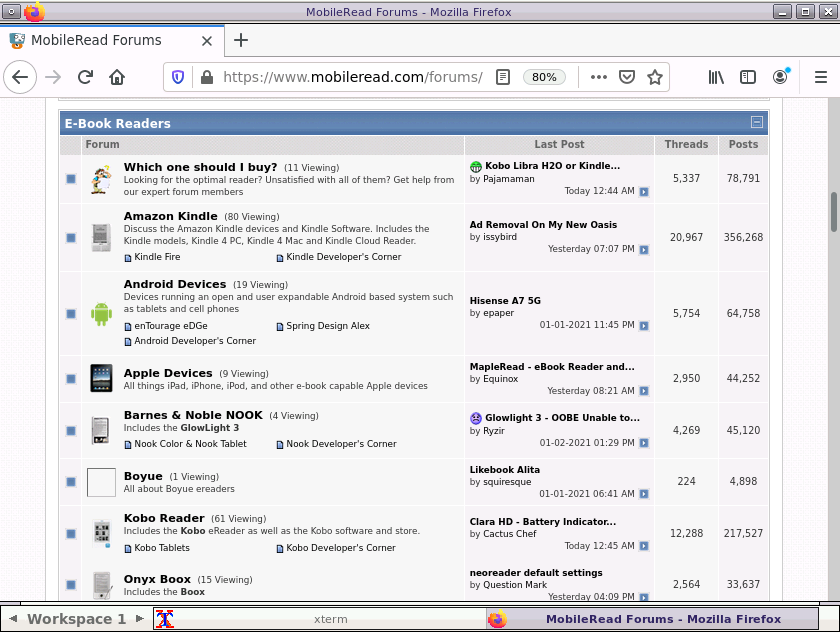

Kobo Libra H2O Overall experience very good, Firefox is able to (slowly) play mobile YouTube videos! Tested Reddit, Old Reddit, Mobileread, all pretty good! Touch experience fairly reliable, albeit very limited.
Kobo Glo HD Overall experience pretty good, Firefox is slower comparatively to the Libra H2O. You may find useful installing Midori or Falkon instead. Touch tested, reliable and working.

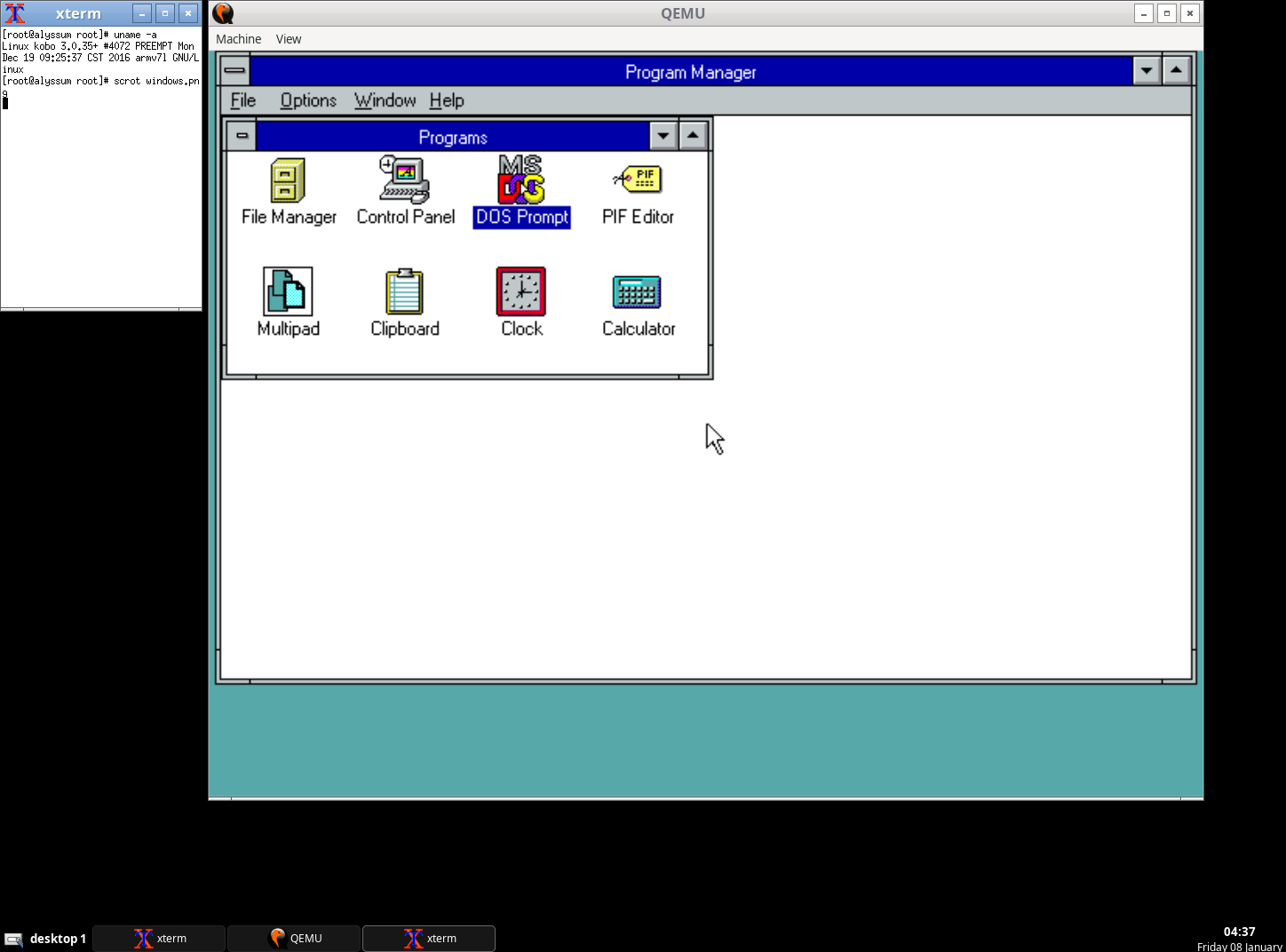

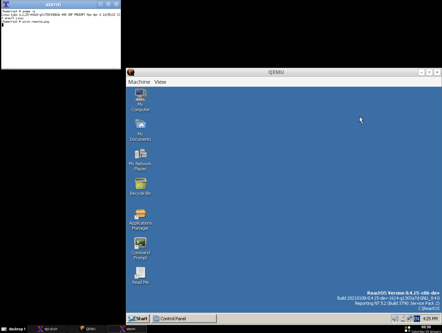

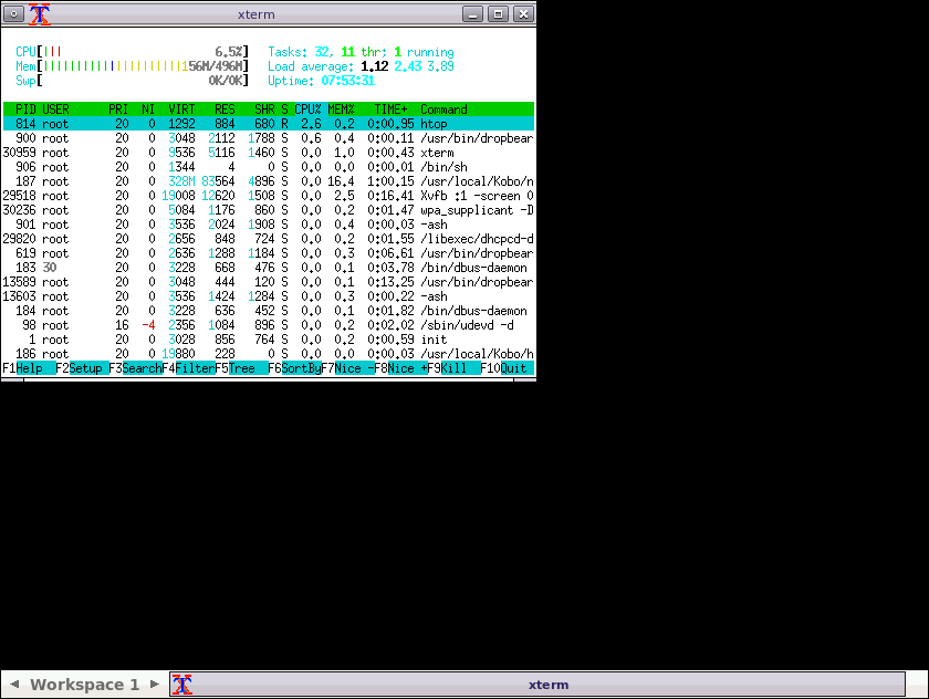

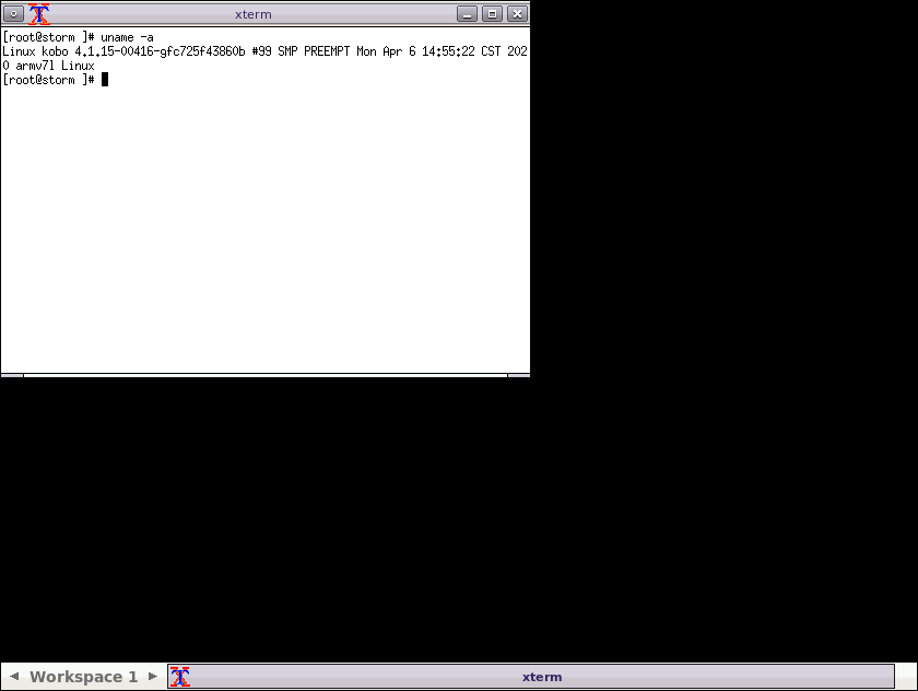

Here are some screenshots...

9. Something should happen. You should see a delightful thing on the screen of your Kobo; an X desktop! And look; if you properly configured xorg-kobo-touch.py, you should have touch! Isn't that awesome?
Complaints: I know it's slow. This is a WIP, and I'm currently trying to really run a real Xorg server in my Kobo with FBInk, which would drastically increase the speed.

Here are some screenshots and I'll post a video soon.
Cheers!
