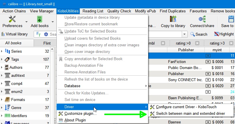

Does KoboTouch need to be disabled when KoboTouchExtended is installed?
Also secondary question, it seems to be successfully converting the epub to kepub (at least according to the e-reader) but I'm not getting the detailed stats page after finishing a book. Percentage completed is available just not the detailed stats. Any way of fixing this?

It will take care of that.
There will also be a item on the Kobo icon to allow flipping to the other (and back)

I may be doing something wrong then as I never see a Kobo icon. Typically when I sideload to my Libra 2 through Calibre, I'll plug my device in then just right click the ebooks I want and hit send to device.
I see that only on Kobo Utilities, which has a menu item to switch between the standard kobo driver and the hobo extended driver, assuming it is installed.

If you click 'Driver' on that menu, it says configure CURRENT <<<< bla bla

Hmm... as @chaley said, that would assume that the OP has the Kobo Utilities plugin installed. While for me, it is one of the items I install when setting up a new calibre instance, it's not there out of the box.
