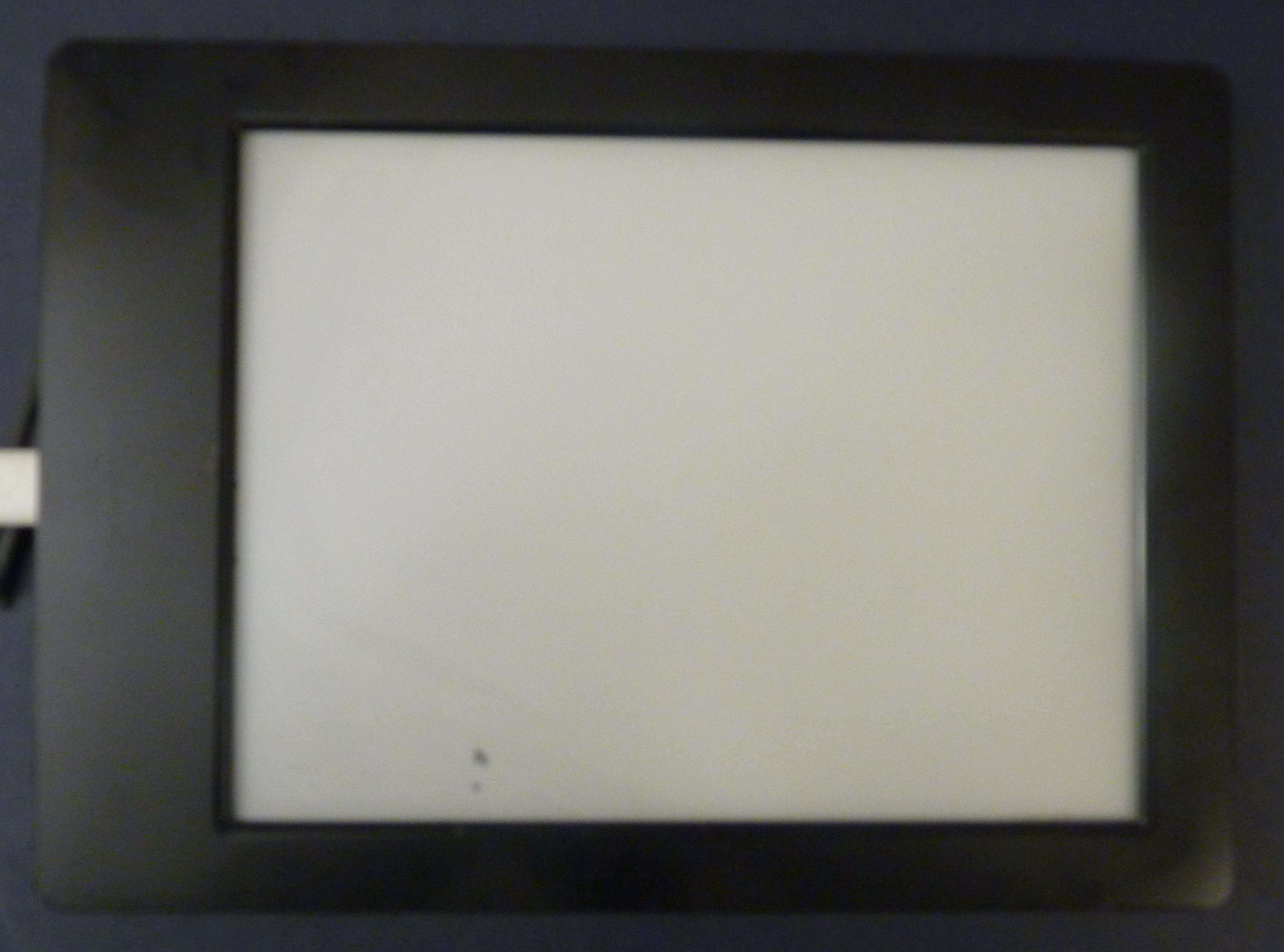

I pre-ordered this Kobo H2O when it was just announced. Barely after two years, it becomes more and more unstable.
1. Initially I noticed when I turned to next page, it turned back multiple pages. 2. The power on becomes harder and harder. In the last month, I used the pin-hole to reset more than I did in previous two years.
3. Yesterday when I was reading it stuck. I tried to reset. The screen flicks, and showing small squares progression bar. It stuck at the first square.
4. I reset again, it restarts and stuck at 2nd square.
5. I reset again, it restarts and stuck at 3nd square.
6. I tried a manual factory reset, it shows a white screen and no display whatsoever. When I power it on, the little LED beside the power button went on. The LED beside the power button stays on until I hold the power button for about 13 seconds. The screen no longer flicks on / off. After I took the device apart, it shows two black marks (see attached photo). Does the screen broke?
7. The device was charged but it didn't help.
After reading a few posts, I suspect the SD card is corrupted. I downloaded the USB Image Tool and scanned the surface, all sectors are good. But I still suspect that the file system corrupted. Could anyone send me a SD image for trying on a different SD card? Thanks.

Old 01-04-2017, 11:21 PM   #2
davidfor
Posts: 24,905
Karma: 47303824
Location: Sydney, Australia
The marks don't look like damage to me. They look more like the device tried to write there.
I've sent you a PM with the link to the image. I don't know if will help, but it's worth the try.

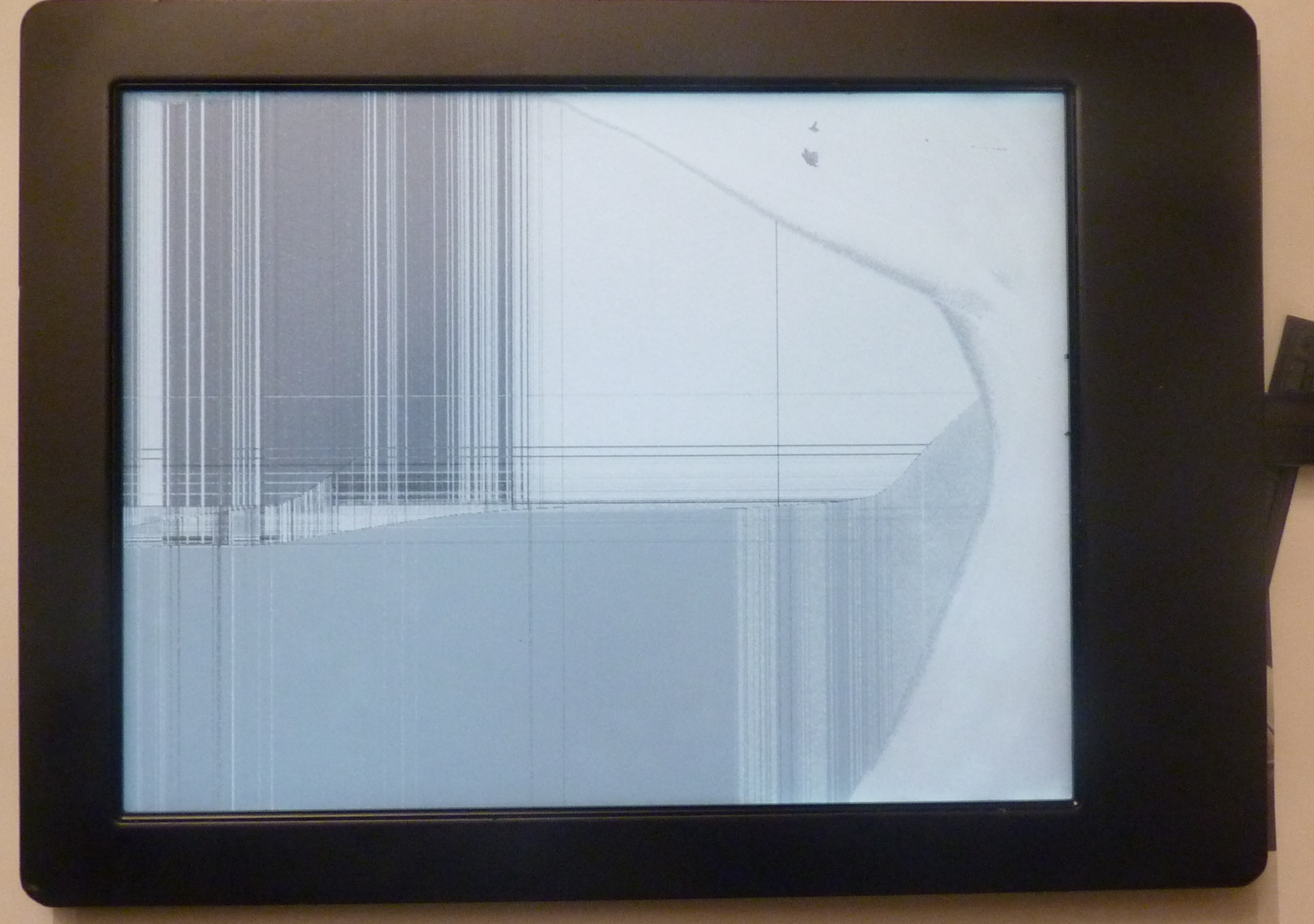

Exclamation Failed to repair. Lesson learned
I started from the sd card image from David. Here is what I did.
1. Used USB Image Tool 1.72 to back up my device's original microSD card content into an img file (old).
2. Used Hex Editor Neo to open the img file, go to 0x200, and record the serial number (s/n) of my device.
3. Unzipped the zip file from David into an img file (new). The img file is about 4GB, the same size as my microSD drive
4. Used Hex Editor Neo to change the s/n number of into my device's s/n and save the file.
5. Used USB Image Tool to restore the new img file to my microSD card.
6. Put the microSD card back into the device and power it.
It seemed worked. The 4 LED's at the bottom flashed, seems it is booting. Unfortunately my screen got broken during dissemble (blame the waterproof glue).
I guess my initial guess is correct that the file system in the microSD card crashed. However, I need to be a lot more careful in dissembling this. There is a thin glass-based substrate layer which is very fragile.

Old 01-08-2017, 09:20 AM   #4
frostschutz
Linux User
frostschutz's Avatar
Posts: 2,282
Karma: 6123806
Location: Heidelberg, Germany
Sorry for your loss
Your display was damaged even before you opened it. Seems like some of your pixels burst...
Unless you killed your bootloader/kernel/recovery partition, it's not necessary to open the device to do a factory reset: [deleted vidme link]
So opening should only be necessary to replace bad battery / when the SD card died altogether.
