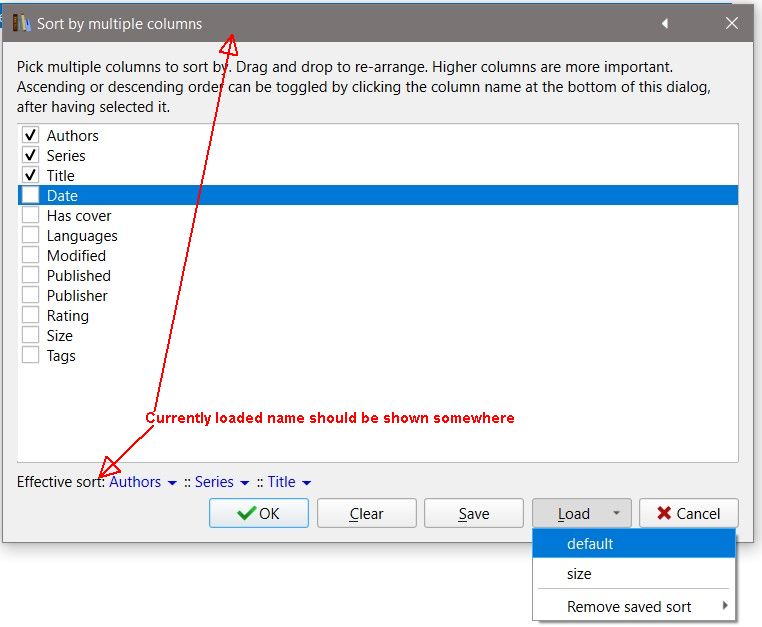

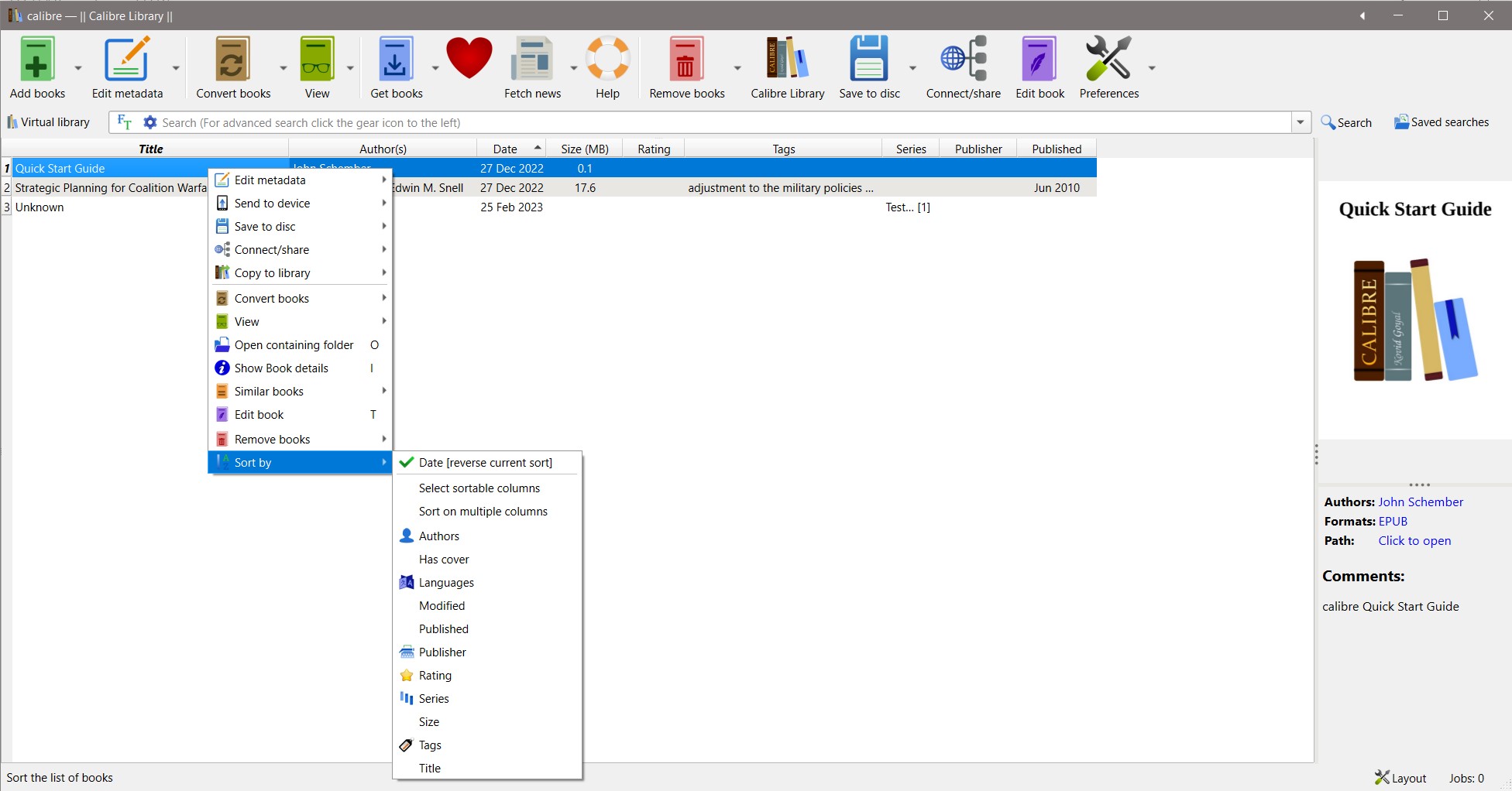

There's a built-in Sort By tool that rarely gets a mention, possibly because the user must add it to a toolbar and/or a menu, and because Version 5.39 added some major enhancements that seemed to go unnoticed. I have it in the Book list context menu.
It can now sort on multiple columns, including hidden columns, sort sequence settings can be saved with names etc, basically a subset of the View Manager plugin features.
My one nitpick is: if a saved Sort is being used, the first menu item should show it's name and Effective sort string. The name of the Loaded sort spec should also be shown in the multi-column sort dialogue box.
And perhaps it should get a mention in the manual.

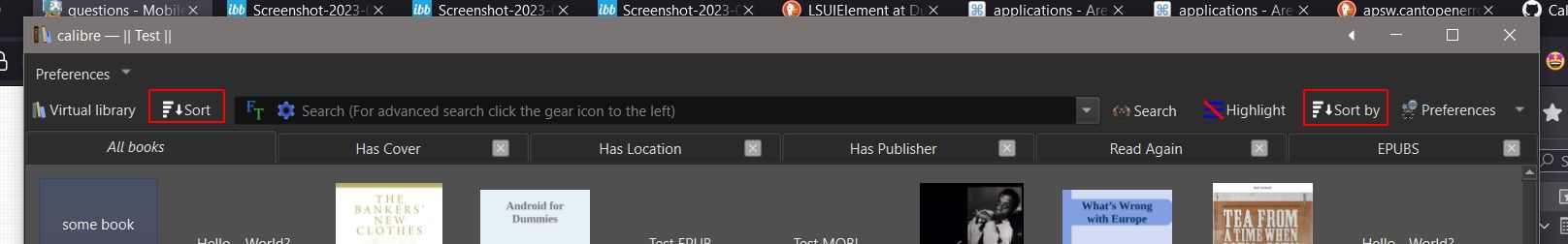

Name:	Screenshot 2023-03-14 201905.jpg
Maybe the one on the left can be removed.
FWIW: I'd prefer to have the added items appear to the left of the search box.
And can the restriction that mandates Preferences must be in the Main Tool bar or Menu be made optional (tweak) - I know the search bar can be hidden . . . but . . .

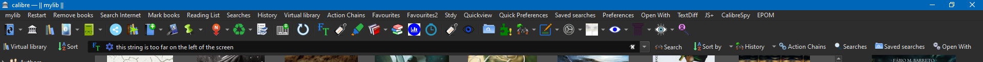

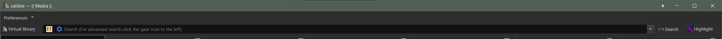

I love the added items on the right of the search bar, but sometimes I feel it would be great to have a second set appearing on the left side.
On wide screens/ large res, the beginning of the search bar text field appears too distant... In my case this is aggravated with a lousy TN panel screen type.
screen snippet:
Name:	MWSnap 2023-06-01, 03_37_51.png

We appear to have similar monitors, but our use of menu's and toolbars couldn't be further apart
Name:	Screenshot 2023-06-02 074131.jpg
Old 06-02-2023, 01:09 AM   #15
Comfy.n
want to learn what I want
Posts: 1,682
Karma: 7908443
Join Date: Sep 2020
Attachment 201826
yes, I'm quite the opposite of a minimalist, lol.
(every software I like must have the main commands available at one or two-click buttons/menus. You should see what I'm doing with Xchange Editor. Toolbars all over the 4 screen edges.)
it's kind if overwhelming but I can't resist... need to re-read "The Power of Less"
