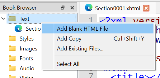

Not sure you were asking this as well, but you can add a blank page by right-clicking on the "Text" folder (or any current page IN the folder) and selecting "Add Blank HTML File" from the contextual pop-up. (see attachment)
As KevinH mentioned, the extension isn't as crucial as the content (xml syntax), don't be thrown off that the pop-up says HTML instead of XHTML.
