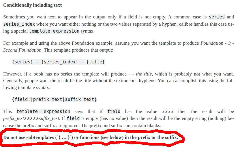

Where does it say that, because it is wrong and needs changing.
https://manual.calibre-ebook.com/template_lang.html

Originally Posted by haertig View Post
That is talking about a restriction in template Single Function Mode. And it is correct. However, templates can be written in Template Program Mode or General Program Mode, neither of which have that restriction.
Plugboards can use any of the above three modes, and also Python Template mode, should that be of interest.

...templates can be written in Template Program Mode or General Program Mode, neither of which have that restriction.
Thanks. I just looked into that (cursory glance). I'm pretty sure I can do what I want using those more advanced programming modes. Just a bit more reading required on my part to learn the specifics. Time will tell if it is worth the effort trying to develop the template that I want. I can always brute force things when I download a book to my Kindle. Go into Calibre and manually change a books Title and Series to what I want displayed on the Kindle, use a standard template to download that book to my Kindle, then return the books Title and Series to their original values. For someone like me who only transfers one or two books to my Kindle per month, this kludge may be good enough, even though it is not elegant in the slightest. My previous programmer self (before retirement) is screaming "No, don't go that kludge route!", but my practical self is countering with "Yeah, but it only takes a few seconds to do a kludge download, and then you're done with it (until the next book)."
