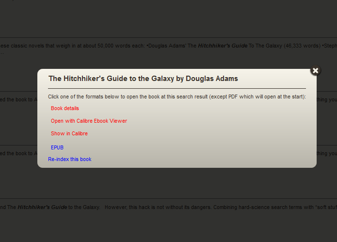

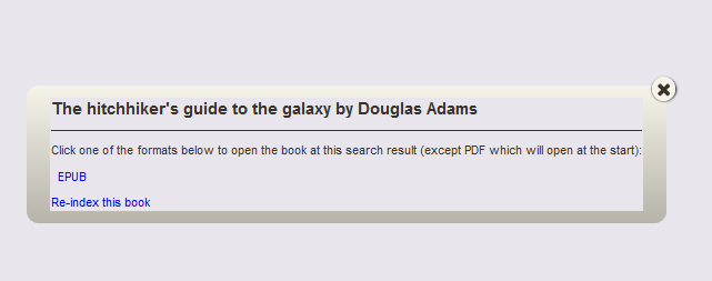

Just a random idea that occurred to me. When doing FTS from a desktop browser, through the Content Server, there are only two options upon clicking the results snippets: 1) one can click the book format link, to read the book within the browser, which opens in the page that contains the result, highlighting it; or 2) "Reindex the book".
Could these new link options be added? Pic below is what I see when I click a result in Content Server FTS:

calibre://book-details/ - I think this one could be opened, if possible, within the browser.
As for calibre://show-book/ and calibre://view-book/, I'd personally prefer them to send me back to Calibre Program/ Internal Viewer.
Attachment 200868
As for calibre://show-book/ and calibre://view-book/, I'd personally prefer to send me back to Calibre Program/ Internal Viewer.
Kovid made changes to show the links in the content server. They apparently aren't working. I suggest you open a bug report.

I can certainly add a link to open the book details page though I am not sure I understand why you would want to go to the book details page from a FTS result.
sure, I knew someone might ask as well "Why don't you just do FTS in Calibre Program" but, as I use context menu within the browser to do most of my web searches, if I had the facility to open book details on a new tab, I wouldn't need to switch back and forth to Calibre and copy something -- for instance, some text in comments field from the book.
BTW it's awesome to do Calibre Searches from the browser, either with https://addons.mozilla.org/en-US/fir...alibre-search/ or using the content server URL with one of the many context search add-ons available.
And ideally, i'd like to see a regular link such as calibre://book-details/_hex_-xxx/####, not a "javascript:void", so that I could just right-click it to open in new tabs, as I use this add-on https://addons.mozilla.org/en-US/fir...n/right-links/...
Anyway, I'm aware that the Content Server is to be used also on mobile systems, so this right-clicking use doesn't fit their case.
I'm sure this explanation doesn't cover all factors, but it's what I can remember :P

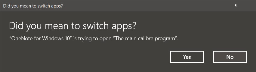

From a desktop point of view, what I can tell is that Windows sees Calibre's URLs and processes them seamlessly. For instance, if I paste a calibre:// URL in the location bar of my system default browser (Firefox fork), this will bring to front Main Calibre window and execute the URL command, whereas the Chromium based browser I tested would ask "Open in Calibre?. (Video and screens attached)
OneNote is the same, I did this one to test the new calibre:\\book-details feature
