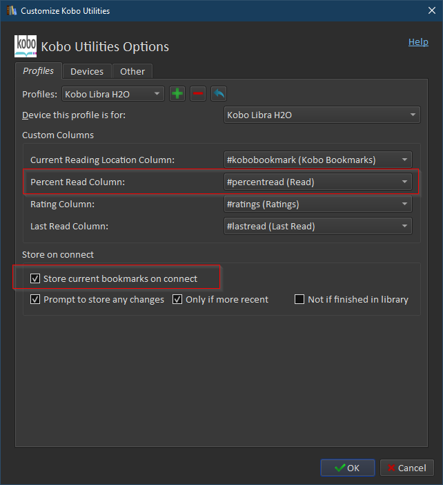

Create a new integer-type column, #percentread. I suggest {0}% for format. You may want to set the default value to 0.
Install Kobo Utilities plugin. Here's the settings.
Name:	2023-02-16 14_59_42-Customize Kobo Utilities.png
Once it's set up, you can then put this template in a 'column built from other columns' to turn it into read statuses.

For the "Current Reading Location Column", all I get back is some sort of cryptic string in the column. What is it supposed to display? I thought it would display something like a page #.
The look up is kobo_reading_location. If I use kobobookmark, I get the same result.
Current file inside the ePub, followed by some span information for exact location. Mostly for backing up and restoring location in case it's lost (e.g. db corruption).
