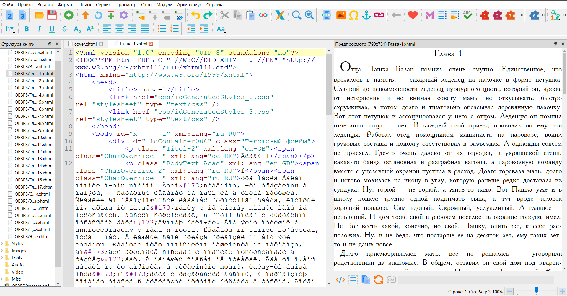

The document opens with symbols
The document opens with symbols. Is there any way to fix this in sigil?
About the same as in the picture, only in the sigil program.
Looks like Mojibake. You might be able to fix it with ftfy.

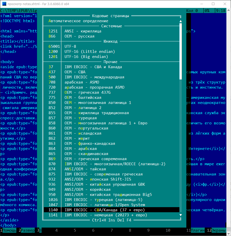

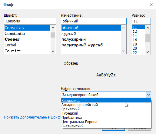

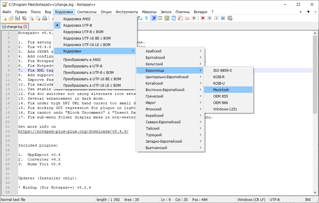

Ваш вопрос немного не из этой оперы.
Попробуйте другие варианты для изменения кодировки текста или кодовой страницы.
Например:
- Измените кодировку в Блокноте. Там это называется "Набор символов" в настройках шрифта (программа, скрин которой вы показали сначала);
- загрузите ваш текстовый файл в Notepad++ и попробуйте в меню "Кодировки" установить правильную;
- откройте текстовый файл для редактирования в Far Manager и по "Shift+F8" тоже попробуйте установить правильную.
Выглядит приблизительно так:
ID:	199868   Click image for larger version
ID:	199869   Click image for larger version

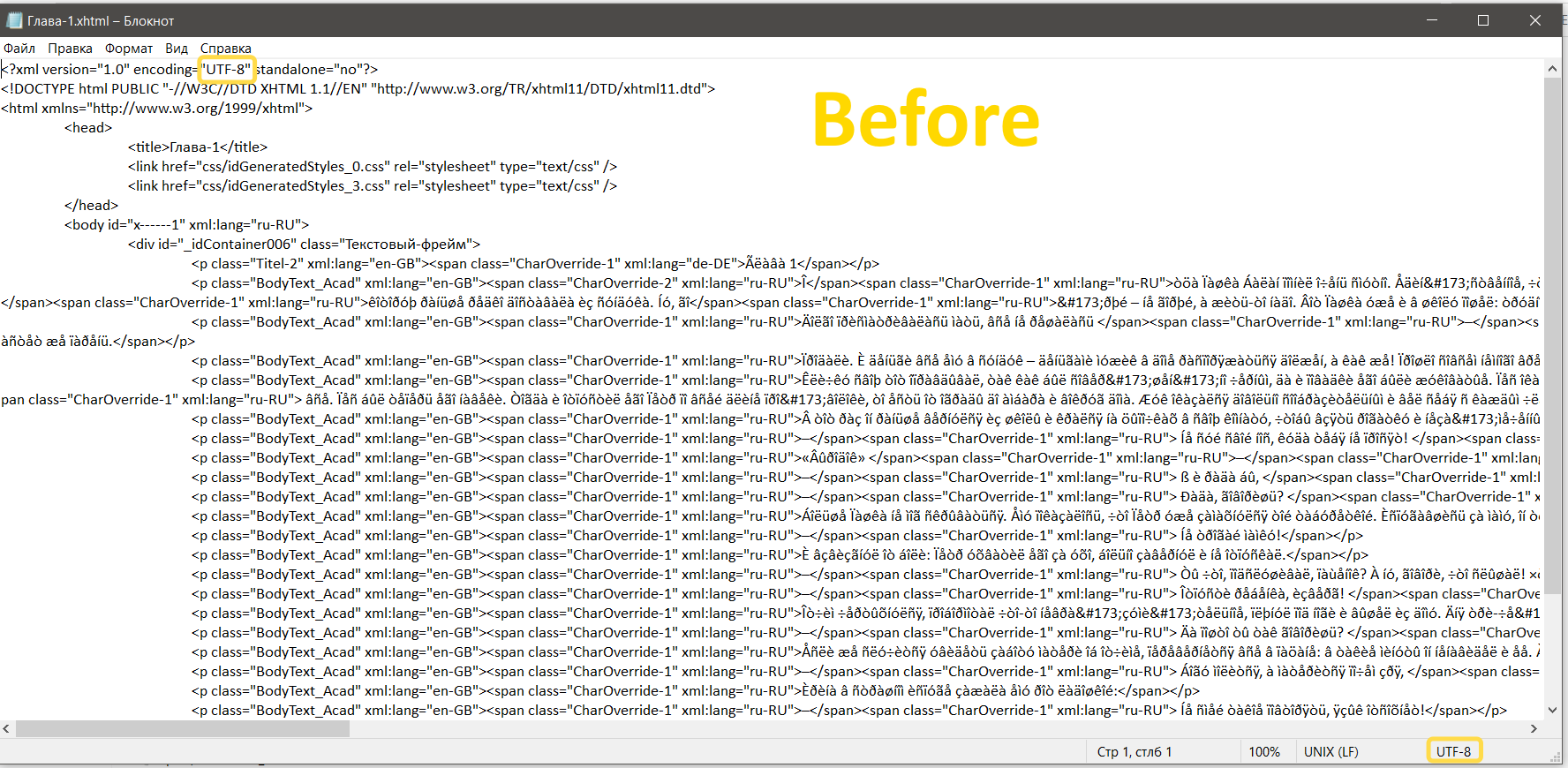

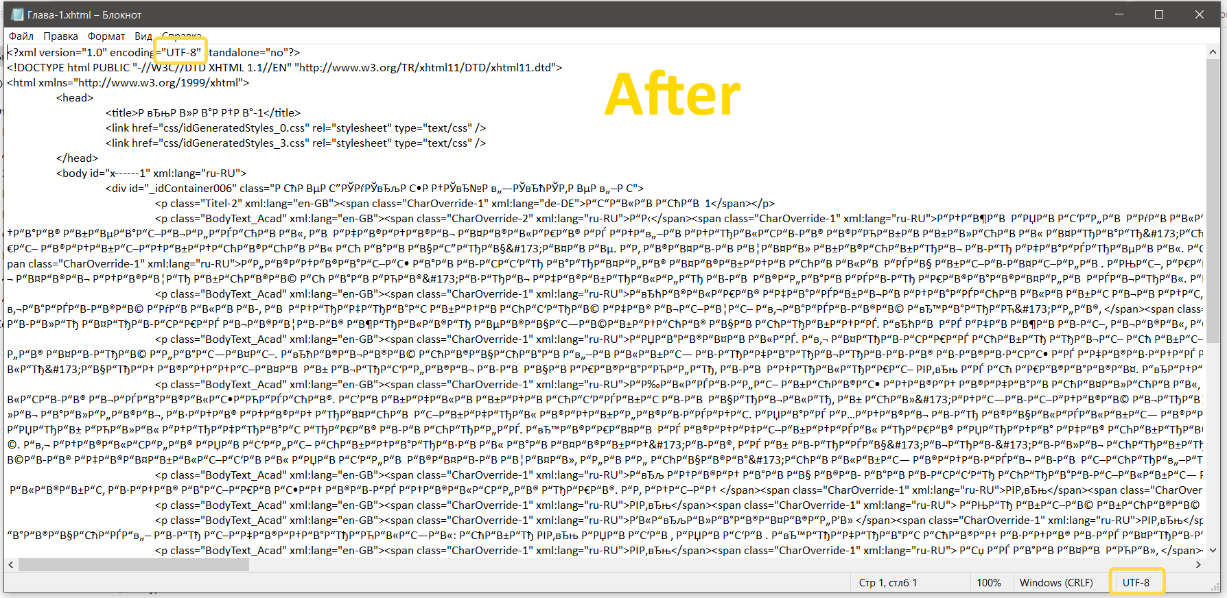

Join Date: Feb 2023
Simply rename the .epub file to .zip and extract all files. After the conversion you'll need to zip it up again and rename it to .epub.
It didn't work out. Everything remains the same. Before that, the file was also in UTF-8.
ID:	199928   Click image for larger version
In that case the automatic codepage detection of the converter failed because the original files contained the following declaration:
<?xml version="1.0" encoding="utf-8" standalone="no"?>
As User_Z has already suggested, you could use Notepad++ to fix the encoding:
  • Open the file with it (Notepad++ should detect the encoding as Cyrillic > Macintosh or Cyrillic > Win-1251. If it doesn't, select Win-1251.)
  • Press CTRL+A to select all text, then press CTRL+C to copy the text to the clipboard.
  • Close the original file.
  • Select File > New and press CTRL+V to paste the clipboard contents into the new file.
  • Save the new file under the same name as the original file.
This'll definitely work, however, since the epub contains multiple files, you might want to search the Russian Internet for batch converters with support for Cyrillic encodings that allow you to manually select in the input and output encodings.
