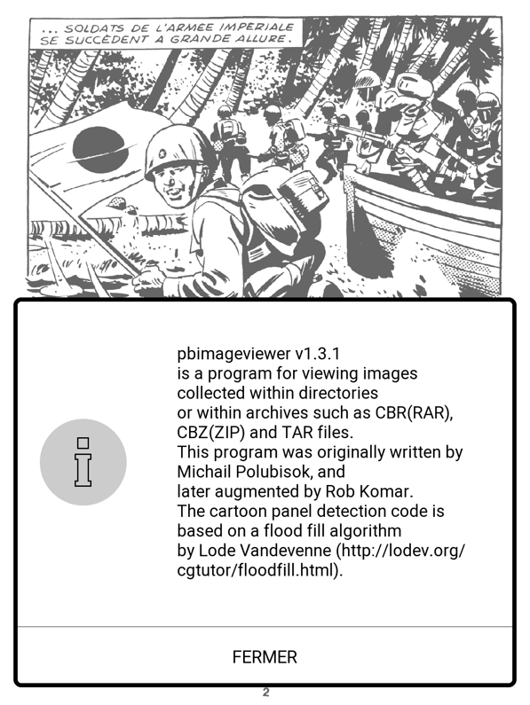

I had the same problem after updating to 6.7.1701, but after using a different version (reinstalling alication) pbimageviewer works without a problem.
In my case, I use version 1.31 on "Inkpad 3" :
Michal Jancik is offline   Reply With Quote

What happens if you open the Menu or start the program from the Application tab? In my case, the program crashed because the OpenContents() function got removed from the Inkview library.
In my cas is not possible to start the application from the main menu (after clicking on pbimageview.app, the screen flashes and I return to the HOME screen). I only open it when I use "open with" from my library.

Yes, that is what happens when the OpenContents() function is missing from the library. The application works until you hit one of the missing functions, and then it disappears.
