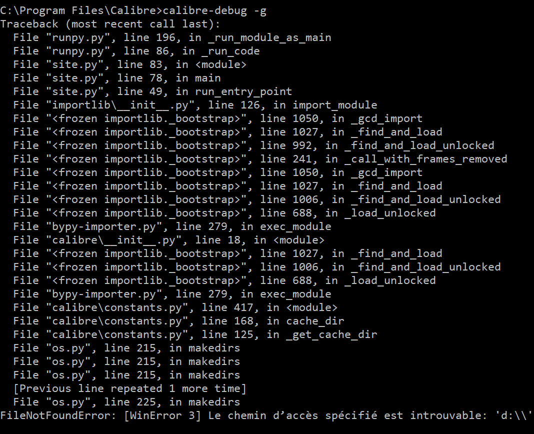

Hi
I have a strange problem. I'm a long time user, but I can't see how to solve this issue.
I'm running Calibre on a very small server, with an external usb drive "d:". Recently the drive stopped working and I just removed it. I wanted to change the location of the Calibre Library, but Calibre refused to run. I was surprised. I was expecting an error message, but nothing.
I uninstalled Calibre, and re-installed it. Same issue.
I then try the debug feature, and the result is attached. The process ends on a File not found error: [Win error 3] Path not found: 'd:\\'
Please note the d:
I don't know what to do. Is there a registry entry than can cause this problem ?
Thanks
Gaston

Calibre still doesn't start. Same error message. Please see the attached screenshot.
Any other ideas ? I installed it on my laptop, pointing on the same location (it's a NAS), and it works....
I'm lost,
Gaston

I finally found out what was going on. A long long time ago I set a system variable :
CALIBRE_CONFIG_DIRECTORY d:\Media\Calibre\CALIBRE_CONFIG_DIRECTORY (see attachment)
I don't remember why I did that at the time!
What is the difference between CALIBRE_CONFIG_DIRECTORY and the Calibre library directory ?
Thanks again,
Gaston

First of all, I confirm that everything is now working.
@JSWolf The problem was the point below. It was not possible to execute the GUI.
Thanks to all of you.
It's really a great support.
Gaston
