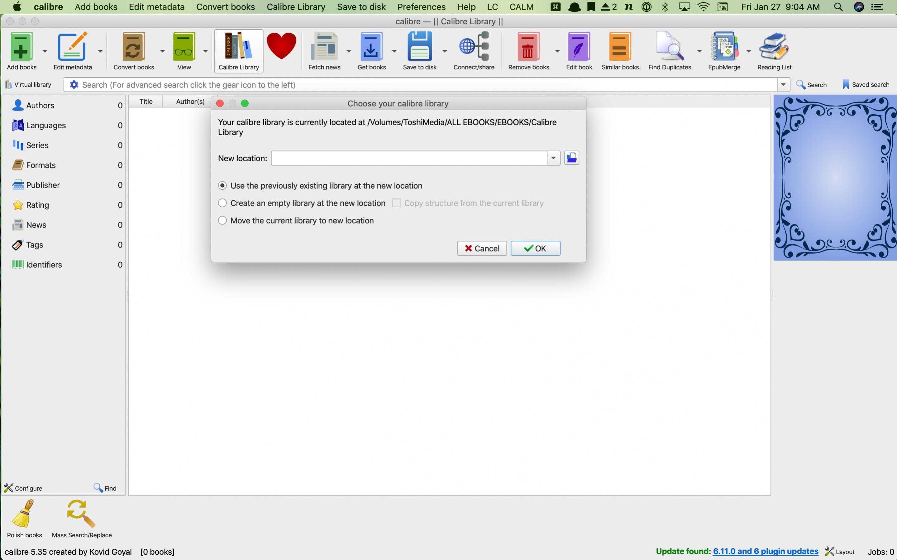

That means you have calibre opening to an essentially empty library. Only the metadata.db file has been copied not any of the actual book and cover files. Use the switch library function in calibre to point it to the actual calibre library folder that contains both the metadata.db and the book and cover files.

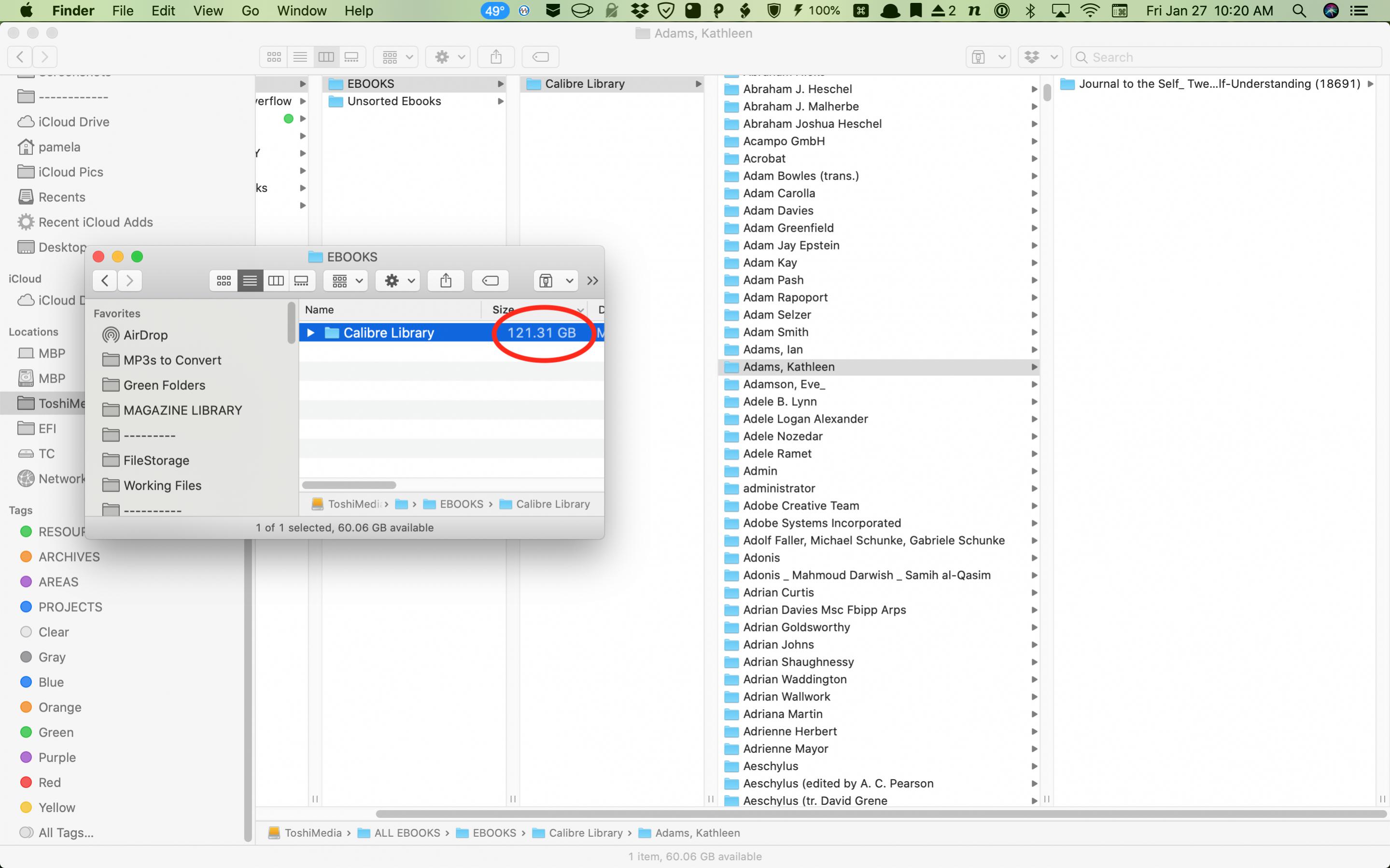

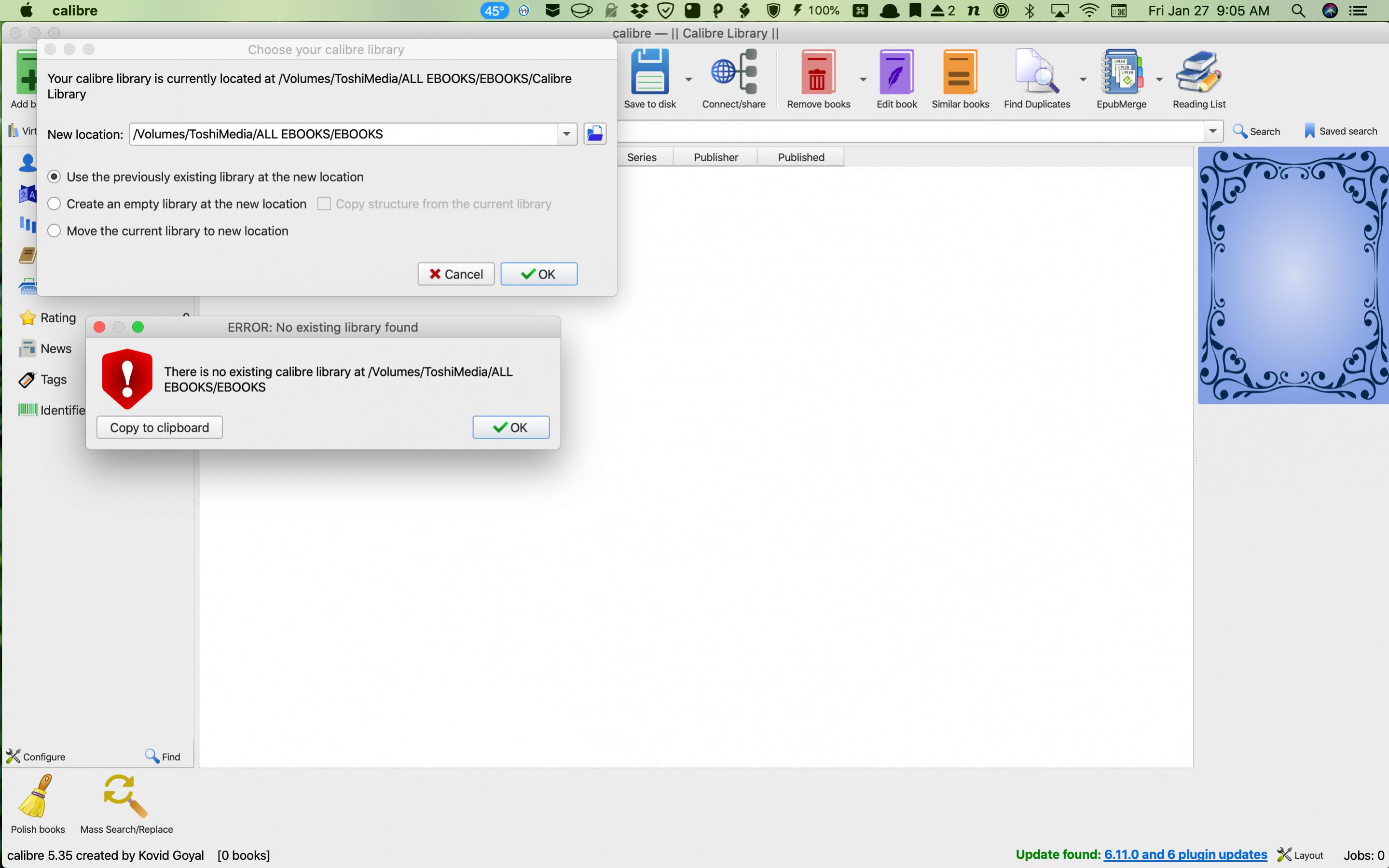

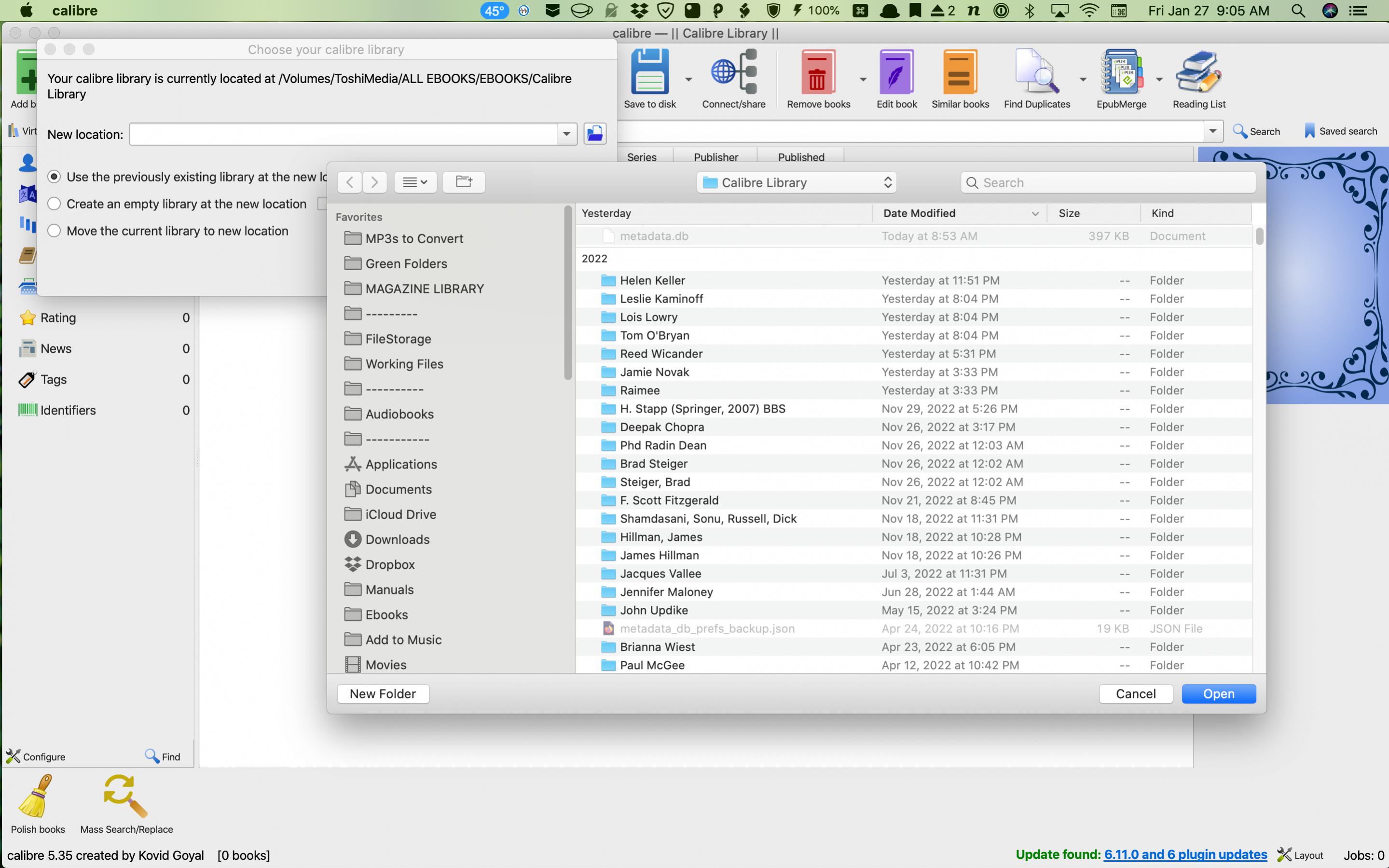

I hope these snaps will make clear where I'm failing. Your instructions couldn't be easier, yet I get no data when I go there. When I back out one level, selecting the folder that contains my Calibre Library folder (which itself contains the data and metadata) I fare no better. The first shows the directory structure and the size and location of data and meta. I do hope you can work out the trouble. I've already decided to donate my personal allowance next month.

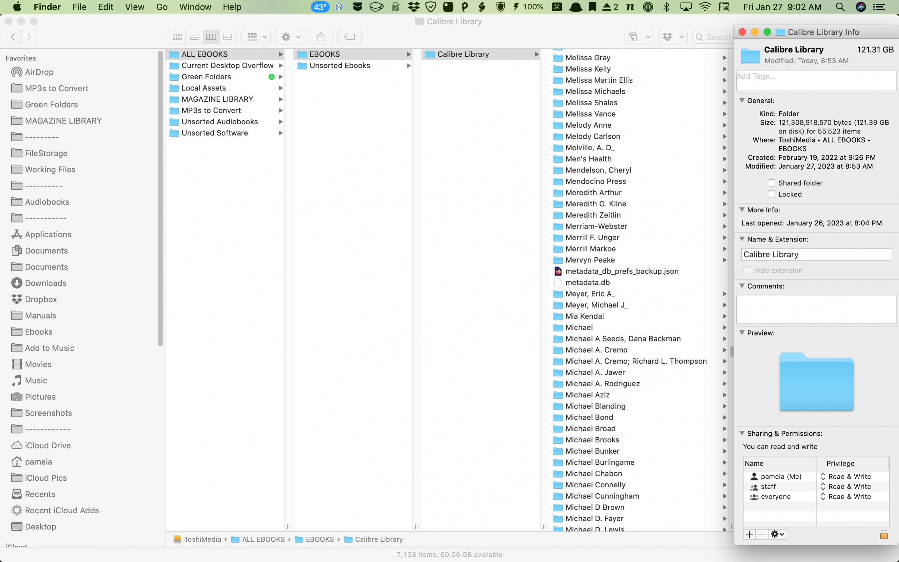

Oh no, this I do know is not what I have. I meant to include a Get Info showing the size of my library, 124GB's! The metadata file should have shown up on the screenshot as loose within a folder titled "Calibre Library" and along with it are the separate author folders you describe. Of this I am most certain. Shall I workout a better screenshot to show you? It's important that we agree on this, I know.

Forgive me for adding to my own reply. The screenshot I describe above was forgotten in the earlier series. I'll post another in my next as it's not an option for this "Quick Reply." As I took another though, I notice that the metadata is now far smaller than earlier this morning, before I began experimenting. I'll be trying to locate the larger one in backup but can this occur from so much switching? I do hope I'm not sunk after putting so much work into it these long years?

I have no backup, am using recovery to locate the larger metadata I had just this morning. Here's a snap showing Step 1 and the size of my library.

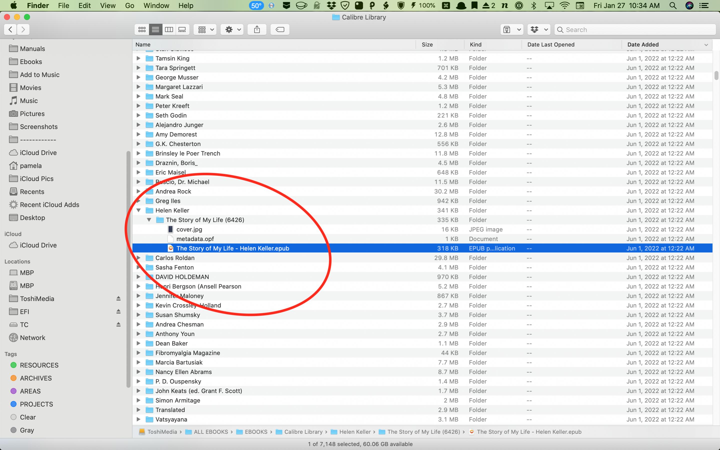

Device: Mac to iPad
Oh yes; it's what I'm clinging to! : )
Name:	Screen Shot 2023-01-27 at 10.34.33 AM.jpg

Then simply pointing calibre to the "Calibre Library" folder will work. But before you do anything else, make a backup of the "Calibre Library" folder.
