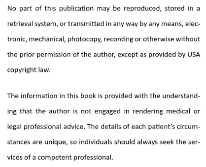

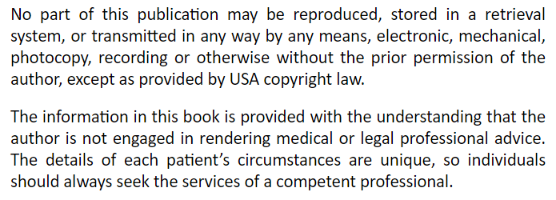

Screenshots comparing Kindle and Calibre
Here are two screenshots to compare. If you need to see the css or the entire file, I'll scramble the epub and post a link, gladly. The entire file is spaced similarly and is fine in Calibre, not in the Kindle Previewer.
I have clearly done something stupid to make this happen because it is a new development that caught me by surprise. Unfortunately, I don't know exactly when it began. I could go back to an earlier copy, but it would be a lot of work to redo. I imagine there is a simple fix, if only I knew where to look.
Given time, I'd become a Calibre/HTML/CSS/Kindle expert first, and then write a book. Sadly, I got it backwards. So again, thank you for taking the time to help me with this. … Ron

Don't have ANY "line-height" properties anywhere.

Quoth, I'm not sure what you mean. Those are just images, not code snippets. My problem is that when I see the correctly spaced text in the Calibre Editor's viewer, it is totally wrong in the Kindle Previewer, as shown by the screenshots. So I'm wondering if there is some global line-height setting somewhere that I might have affected unintentionally, or if there is some other reason the KP looks so different.

I suspect the setting is in the Previewer and not this if it looks OK in Calibre viewer.
Without the real code (can be scrambled), it is hard to tell where.
I'm with Quoth. get rid of any line-height in your code (a COPY) and see what the Kindle version looks like.
Been a while since I bothered with a Kindle (Kobo is now my main read), but Kindles have Kindle (setting) View and Publishers view. The former pretty much does its own thing.

theducks, you might be right. I sent the epub directly to my kindle and it looks much better, other than everything I already mucked up trying to get it to look right in the previewer. I will try to clean it up in Calibre, send it again to my kindle signature edition, and see how close I get. Thanks for the tip, and thanks for sticking with me on this.
