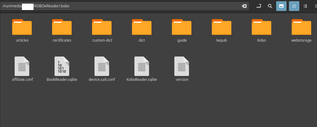

I plugged the Kobo into my PC and looked in the .kobo directory, but I'm not seeing a trace log.
Is there something special I need to do to enable it?

I said "could be". The trace log is created with some crashes and hangs. It will depend on what actually happened. At this point, it will probably not be possible to work out what happened. The only thing you can do is watch for it happening and see if you can work out what was going on at the time.
