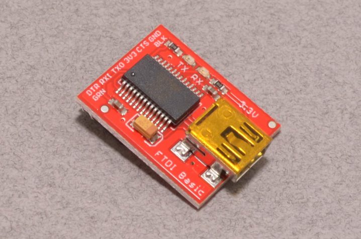

You should have it connected RX, TX and GND to a computer with an FTDI o something like that, if not, you need to do Step 1 in this page:
(I attached an image of my serial hardware FTDI Basic)
http://www.xodustech.com/guides/kind...te-demo-unlock
Remember:
connect pin rx kindle to tx in your device Serial
connect pin tx kindle to rx in your device Serial
connect pin gnd kindle to gnd in your device Serial

I. Initialize Partition Table (fdisk) and format FAT
O. Format and overwrite FAT partition
E. Export FAT partition
U. Update using update*.bin file on FAT partition
D. dmesg / kernel printk ring buffer.
Q. quit
Press Enter and you should to selected the next options
*I. Initialize partition when it finish
*E. Export Fat Partition
Ok, we almost finish
in windows a unit called kindle should appear, you must paste the amazon update there (in my case update_kindle_voyage_5.13.6.bin)
update-payload.dat:128 52bfb6ae13d34ee8e90df99440830726 imx60_wario/u-boot.bin 2 bootloader_bin
1 3d725dbfa4f03a14f39a3864bb53e488 imx60_wario/uImage 23 main_kernel
128 6481e91f23c78b5142e4f98e95e8ecac rootfs.img.gz 1867 update_image_rootfs
update-payload.dat:EOF
imx60_wario/u-boot.bin 293820     [######################################]
imx60_wario/uImage 3143520    [######################################]
rootfs.img.gz 244719876  [######################################]
then unplug the kindle and restart it
enter to boot menu and select “U. Update using update*.bin file on FAT partition” option
when the process is finished you should be able to login from the kindle and that is it
Enjoy your kindle
